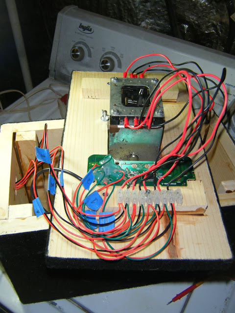

So I finished this but forgot to update the thread.   :dizzy:
I ended up doing the DB15 and just making pins 1-4 gears 1-4, and making the pins directly below the grounds for each (the carpet is a little dusty in the pics).
I ran each of the switches to a terminal block, and then ran 2 wires from each....one to the DB15, and jumpered one to the 1-4 buttons of an old Gravis pad. I screwed the pad to the lid of the box, and secured my wires with hot glue, for extra security.
You can see where it runs from the terminal block to my DB15:
