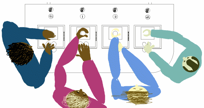

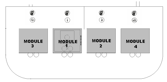

I've been thinking about a 4 player modular control panel for a long time.  I started out with pretty complicated ideas, and was never satisfied.  I have finally come down to a very simple one, and I wanted to run it by you guys before I start cutting into wood:
Here's the basic layout.
Rendition of what it might look like if I had 3 friends.
This should show how big it will be in front of my 27" wide cabinet.
Here are what some modules look like.
I have a 2 player version more or less completed.  It will be easy to remove the 2 player panel and plop in this 4 player version for nights when several guests come over.
The corners are rounded, so that everyone can shift around to find a balance between being to close to each other and comfort on the controls.
It's very important to me that I have a decent Karate Champ Vs. layout.
It's also very important to keep it as small as possible.
I tried to make sure that there was plenty of room so that players can rest the palm of their "button pressing hand" on solid wood no matter where they are standing.
(* edit *) The biggest problem that I can see is that the space is just too tight for 4 trackballs, particularly for frantic games like Soccer or Atari Football (the only 4P trackball Mame games).  Short of building a 4 player cocktail cabinet like the original, there's really nothing I can do about that. (* /edit *)
Am I overlooking anything obvious?  Can you guys offer any suggestions for improvements?  All comments welcome.

I have something like that except not individually modular.  The middle 24 X 13 (total size is 42 X 15-1/2) piece removes while the left and rightmost joysticks remain in place (and a little 2 inch piece for the start buttons above the removable panel).   It's pretty much what's left over from the aborted rotating panel.  It's going to remain in place by a hook on the wood that it sort of tilts and slides into and some sort of clips up front.   Sorry I don't have pics yet.
But I like your idea, would like to see how that turns out.
You know, that line has to be the saddest thing I have ever heard.
Don't worry, I'll be your friend!  ;D
Also, assuming you are player one. Does having six fingers give you an edge in those six button fighting games.  :P
« Last Edit: September 23, 2003, 02:44:11 am by paigeoliver »

I think that a 2-player control panel with swappable modules, like this idea, and with additional 3 and 4 player areas that clip onto the side of the board, would be a really good solution.
Hmmm, that  would be ideal.  That's what I pictured when I first started thinking about the 4 player setup, but I think that I was so overwhelmed by all the other design details that I decided against it.  Now that I've got the basic design figured out, I can start thinking about that again.
The only trouble is figuring out how to attach them.
...for the side areas you'd probably only need to make an 8-way and a 4-way (or a switchable) panel as few specially controlled games had more than two players.

« Reply #15 on: September 23, 2003, 09:33:20 am »
You might get away with a little down, and to the side...
Notes...
Don't rotate the 1st and 4th joystick to point to the screen when they are on the side.  Why?  I thought it was better myself... but every kid I ever had play on it just got confused...
Also... then you can't get 2player smashtv to run... and this is VERY important (maybe more important then getting 4players going.
If you have a hotswappable control panel... make one 4players only.  It really helps to have 4 player with 4buttons each max.  the extra room from removing the extra 2 / 3 buttons in player 2 / 3 are worth it.
4players will almost always have to smash together some.  Its part of the game.
:rofl:

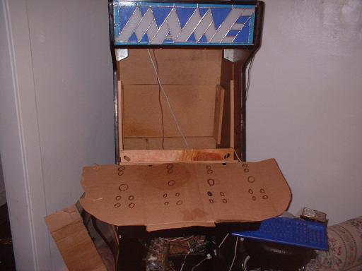

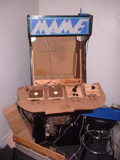

I just cut my CP that has 2 player with trackball and spinner on the main board and 3 player and 4 player that clip on the outside of the cabinet.
This seemed to be a good compromise to keep the cab looking like a retro game while allowing all night Gauntlet 2 marathons with 4 players.
I'll put up pictures when it is complete.
BTW, I highly recommend a 3 axis CNC mill for cutting the control panels. Nothing like round holes that are in the right place...
« Last Edit: September 23, 2003, 01:48:20 pm by Hammerbot »
