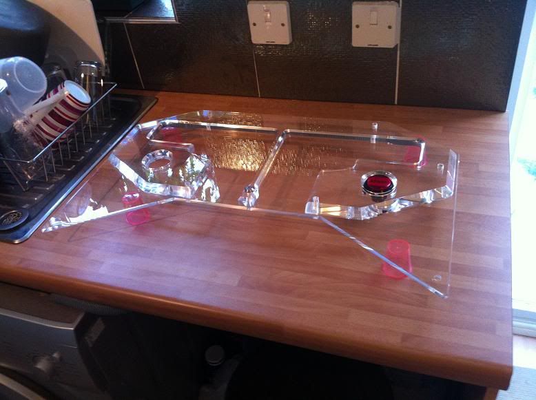

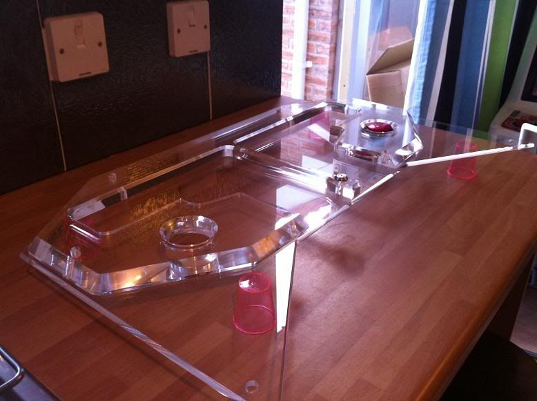

Apologies for not posting those photos. I did take them whilst working on that job but I completely forgot to post them  :-[ Anyway I'm glad to hear it came out ok  :cheers:
I would like to think I'm pretty good when working with plastics. I may put up a 'how to' thread myself.
As an example, I just finished this for a customer this week. Its a control panel and gun holder for a Sega 2Spicy cabinet. It was all hand routed on a router table and hand polished.
