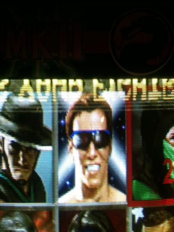

ok, well I fixed that. Got the flyback replaced. Plugged everything in...and no popping/arcing!!
But...the game is playing blind, sound works (which i suspected it did before, just never left it on long enough to hear due to the arcing, just heard the beep at startup).
I ask the experts, whats the next step? The HOT?
Also, I jus checked, it was hard to tell, but I didnt notice neck glow! I could be wrong, but that might be a possibility....

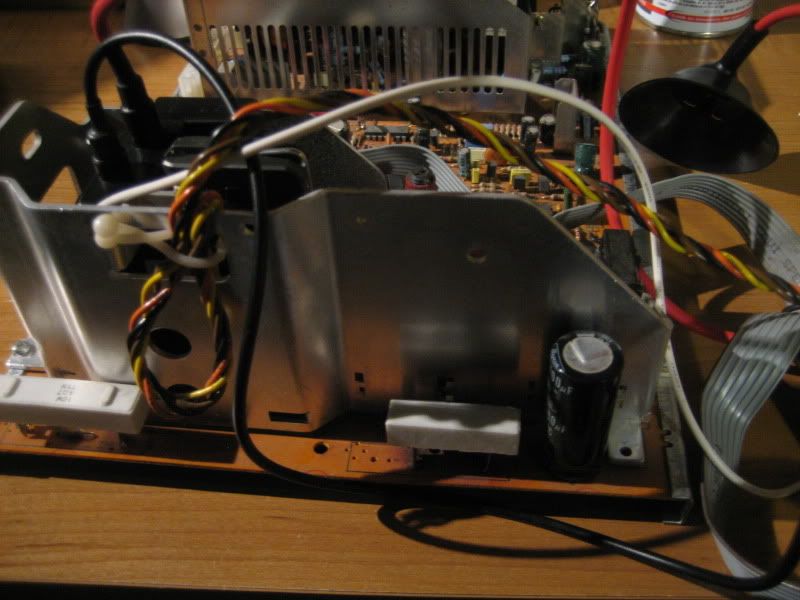

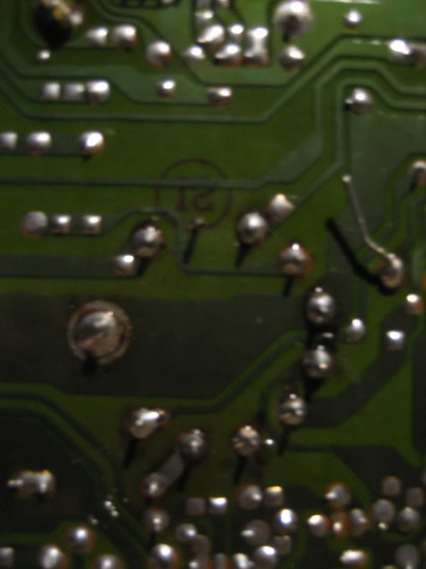

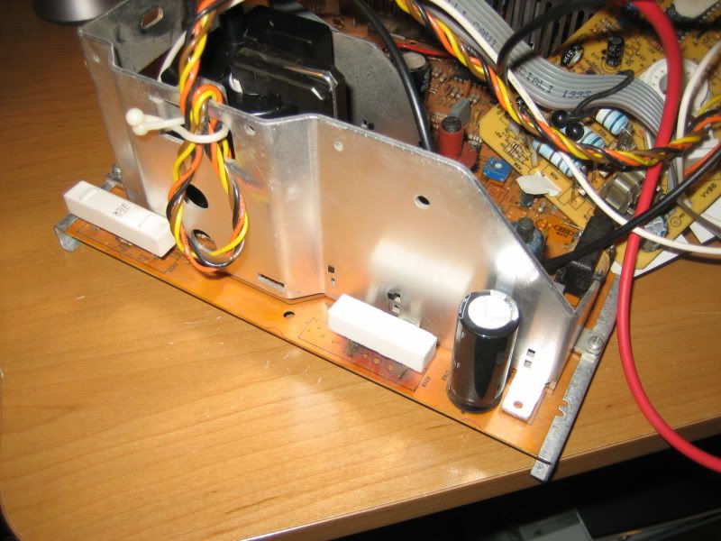

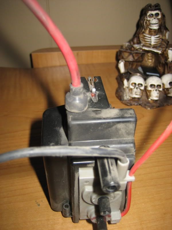

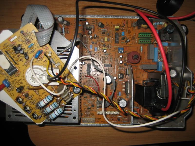

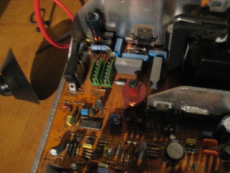

I'm in the US (Michigan), here are a few pics...
The old flyback was arcing from where I circled there,
I noticed that on the bottom of the chassis, kinda next to the flyback, there was some a bit of burning/darkening here:
(the burned part is directly under that white brick lookin thing (sorry, still learnin lol)

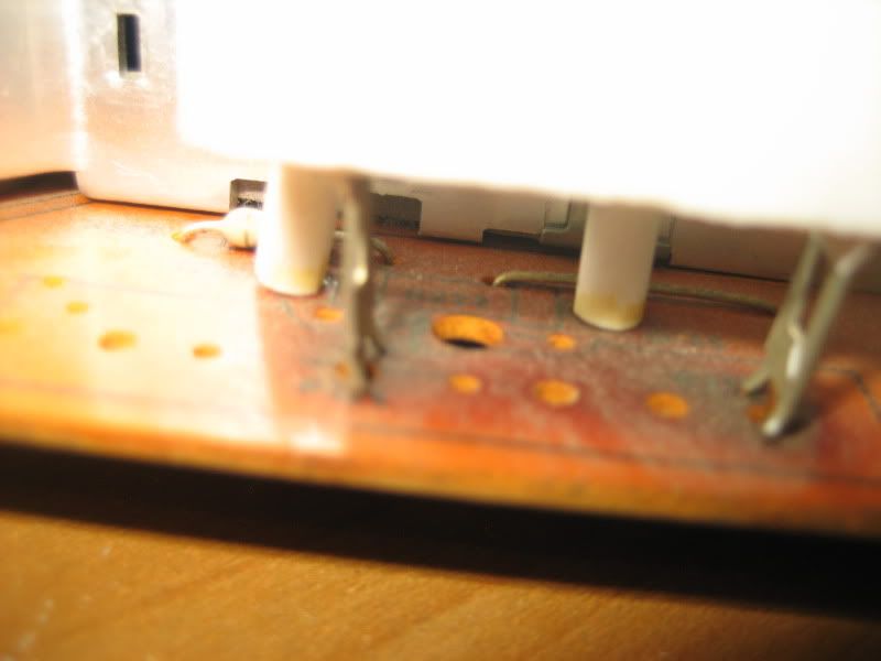

here is the new soldered on flyback:
The pin on the top of the pic wasnt soldered into the old one, nor did it look like it ever was, so I didn't.

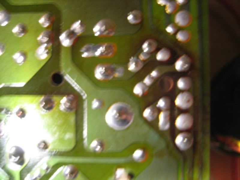

and misc. rest of the board
« Last Edit: January 06, 2012, 08:35:56 am by MLew »
corycet
  • Posts: 25
  • Last login:June 09, 2012, 01:35:58 am
Re: Popping/clicking sound problem (Hantarex Polo 25)
« Reply #27 on: November 15, 2011, 08:41:53 pm »
Cut the excess wire on the flyback pin. It looks like it has about a 1/2 inch to an inch of excess wire. It is probably shorting to the monitor frame when you put it back in the game. The unsoldered pin you mentioned is correct.
MLew
  • Posts: 114
  • Last login:May 10, 2018, 08:38:25 am
« Reply #28 on: November 15, 2011, 08:45:59 pm »
oh wow, I hope that's not it! stupid...
good lookin
(btw, dont mind the name change, jus trying to keep the same identity throughout the internetzz)
corycet
  • Posts: 25
« Reply #29 on: November 15, 2011, 08:53:06 pm »
The burn mark is common and is normal because the resistor gets very hot. For the most part it wont cause any problems, but sometimes the solder joint gets nasty and needs resoldering.

I replaced the HOT with a new one. Didn't change anything. Upon inspection of the old one, it appears to read fine on my DMM (roughly got same numbers as the new one)
Havent had the time to sit with the Fromm monitor videos yet. Not sure where to look next.
I did notice that the line that goes into the neckboard socket from the flyback (focus or screen, can't remember which!) seats inside the hole, but is not quite as tight as the one I removed. I had said that a piece broke off inside, but thought I got it out. Mayb there still a piece in there? Either way, that shouldn't much matter cuz I can tell it is holding it enough to make the connection. I even tried fiddling with it when I plugged it in to see if SOMETHING happened. Nothing.
I don't know if I asked this already, but what could cause the flyback to arc the way it did in the first place? There were no cracks in it, and it arc'd from the anode line goin into the flyback (see pic from previous post)
MLew
  • Posts: 114
« Reply #36 on: December 05, 2011, 08:47:05 pm »
I checked around, and I know I have ~127vac going into the chassis. I checked test point TP6 (as per Randy Fromm's flowchart, and I have 0v. From what I gather, thats part of the B+?
 I'm assuming under the metal cage on the chassis is the power supply area of the chassis, and the source of the problem. Any ideas?

Ok. After much troubleshooting, I decided to try n swap the new flyback to another chassis I had. Lo and behold, it works! But I am getting some weird lines on the top of the screen. They seem to go away if I shrink the vertical (vsync?)
If I extend the image to cover the entire monitor screen, I get what you see in the pictures. Any of u guys know/have seen this issue? Like I said, the lines all but disappear when I shrink the vertical size enough...
crash41301
  • Posts: 39
  • Last login:January 25, 2014, 07:18:38 pm
« Reply #48 on: March 13, 2012, 12:16:21 pm »
You should REALLY find time to watch the Randy From videos on youtube. I know its very long, but you'll come out of them knowing a ton more about this than you do now.
Lines - Possibly capacitors?
MLew
  • Posts: 114
« Reply #49 on: March 13, 2012, 12:29:56 pm »
I was thinking caps too, I watched the first one and it's got a ton of info! I will eventually watch the rest, but time is very limited for me now. :(
