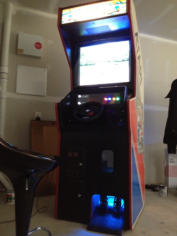

All this talk of blue glows at night and I never took any pix, until now:
I also installed hyperspin, Im not sure if I'm gonna keep it or go MaLa, Its mighty pretty. However I do need to make an intro video. I am having issues selecting games with the wheel, but I think I can dial down the sensitivity on the wheel using the logitech profiler. Or I can just map the game selection to the Dpad build into the wheel. Another thing I need to do is map the escape key to the button up top, using joy2key or something of the same ilk.
and I need to make some custom graphics for it too.

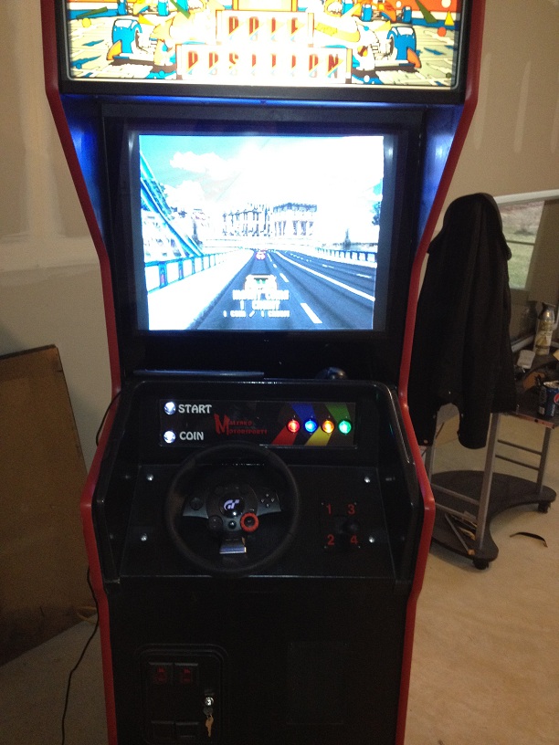

So here's me working in photoshop for the shroud art:
And for a mere $33 (ouch! $11 a pop) Kinkos printed me out 3 copies:
Clamped the plastic down with 1 of the copies taped to the back:
drilled out the button holes:
Wired it all back up, I think it looks pretty good!
I'm working on the instruction card that is going go below the monitor. Now to figure out how to add Model 2 and Model 3 games to MaLa. I'm not loving Hyperspin that much.

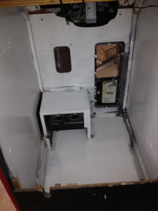

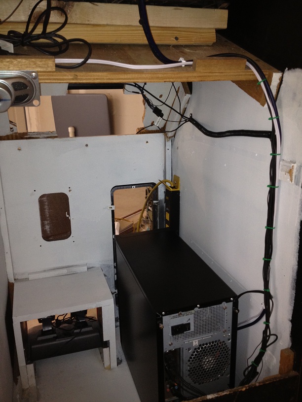

Decided to stop dragging my feet on this and get some ---steaming pile of meadow muffin--- done.

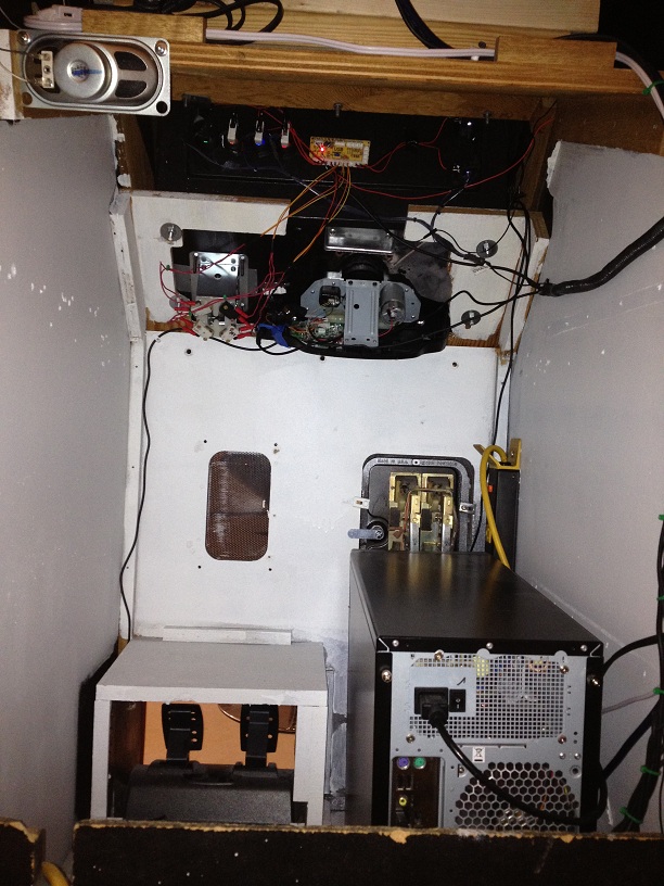

First I reprimed the insides, then I found a better way to mount the wheel. I used to have the wheel on a shelf and the wheel sticking through the whole in the front. Little back story to that, I had to cut a line from the top to the hole then pry the metal apart and slide the wheel in, good times. When the wheel was on the shelf it worked but it didnt leave much finger room between the shelf and the shroud. Well I eliminated the shelf and I put screws in the wheel housing from the front of the metal CP. Then I JB Welded a blank outlet cover plate behind the control panel, then filled the gap in with JB weld.  Ghetto as hell, but it works and its behind the scenes, and has much better finger clearance all around.
Reprimed:
Computer in, and wires tidy:
Yes, thats a tiny speaker inside, Im waiting to grab 2 new 6x9s for the inside.

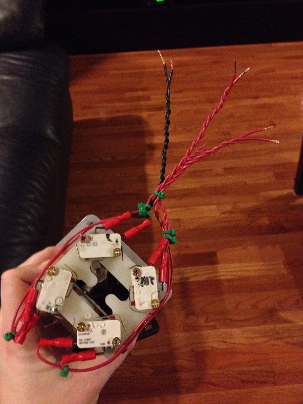

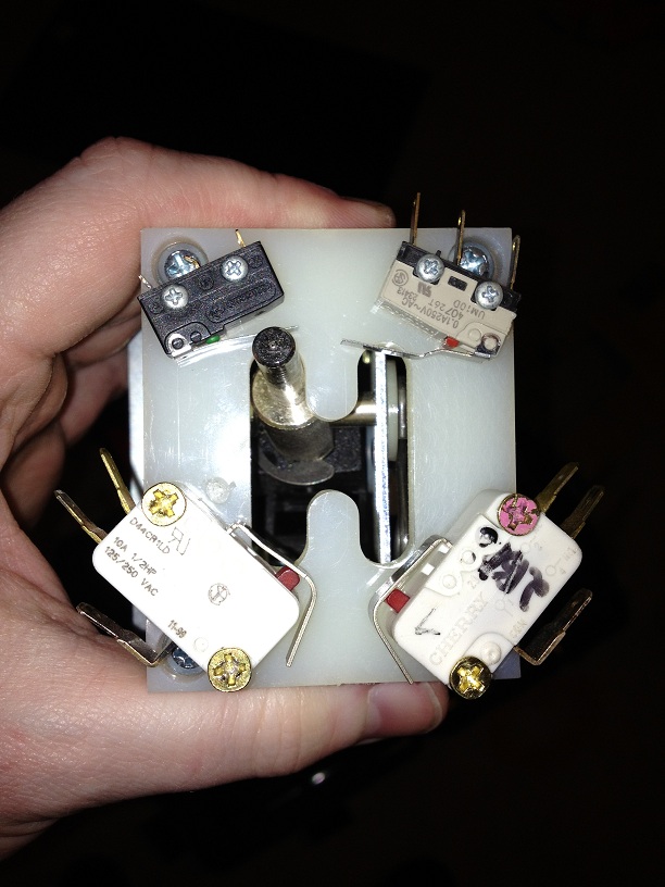

Next Ghetto-ness, the shifter. When I got the shifter from UncleT everything was fine, it was either in storage or my first attempt to mount this thing that I broke 2 cherry switches. I couldnt find 2 replacement switches, they are oddly small, so I hacked them, kinda. I basically mounted 2 regular joystick cherries:
then I just decided to just replace the 2 working ones with 2 more regular sized cherries, so all 4 gears felt the same:
Then I mounted the shifter to the control panel , I had to drill 4 bigger holes but in a pinch this could still be converted back to a PP if for some odd reason I ever wanted to. Once the wheel was secure, and the shifter was bolted in, I mounted it to the machine, and ran the shifter wires to the Zero Delay encoder that was originally used for just the camera buttons.
you can see the blank plate in all its ghetto glory!

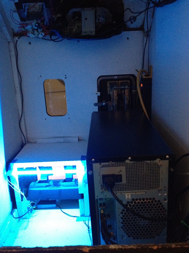

Re-added the blue cold cathode behind the pedals for the glow:
For future reference, radioshack sells that size.  :lol

Re: Checkered Past (was Mame Position) (New pictures 9-7-13)
« Reply #76 on: September 07, 2013, 03:00:37 pm »
Heres some better pictures. I still havent set up all the software yet, I plan to add PS1 and PS2 driving games, and some PC games too.
Here is the LCD installed, with vesion 1.0 Marquee:
This is with all the stuff put back where it belongs:
Heres the cab, with the bar stool I use:
Trusty wireless mouse on the button bezel:
I still need to cover the CP with something:
