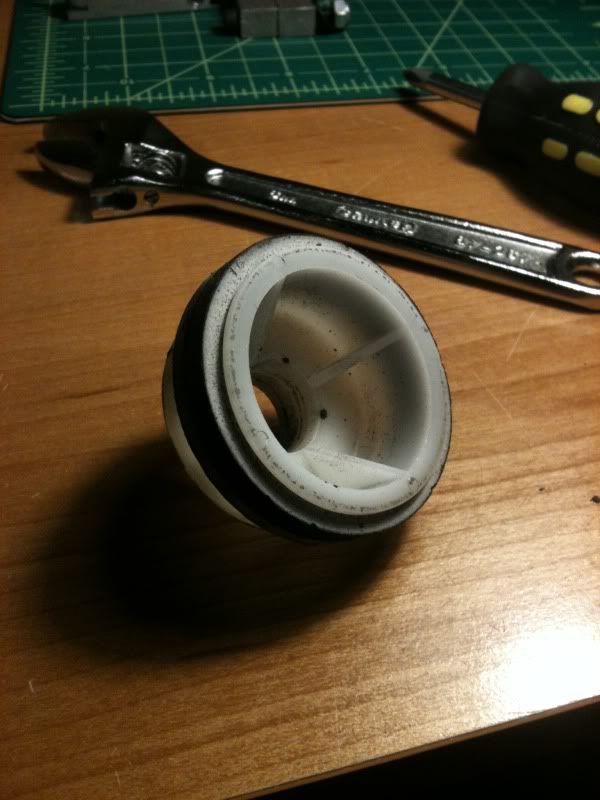

I took the cp home with me to take apart and figure out the joystick issue, and when I disassembled it, there was a lot weird gray-ish..dust. Not normal 20 year old sitting in an attic dust, maybe from a deteriorating pivot ball? Idk, i know its a problem with these joysticks, but I don't know what to look for. the last pic, you can see a small gap between the shaft and the white plasitc holder (plunger?). There is play here, it rocks either way that much in any direction. Might have to replace some of these ol plastic pieces to tighten up these controls.

okay, got the joystick apart, here is what I'm looking at...
mand, that pivot ball is NASTY!
all cleaned up...
actuator
shaft assembly, notice the white plastic (the plunger) it looks a bit worndown, any opinions?

this is where all that nasty is coming from. it should like this:
look how thin yours is around the lip. there should be an extra 1/16th of an inch of plastic on that thing.
http://www.ram-controls.com has rebuild kits.

  • Posts: 114
  • Last login:May 10, 2018, 08:38:25 am
Re: My new toy :-) with problems :-( (Xybots)
« Reply #45 on: December 28, 2011, 07:33:36 am »
I can get the parts at http://www.videogameparts.com
Should I replace both the plunger, and the ball? Def the plunger  but The ball seems less worn to me

Got my parts from videogameparts.com and the joysticks are working great now! VERY responsive, smooth turning/directionals. Can't wait to get back up north where the machine is to try 'er out!
