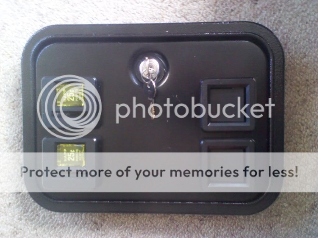

I'm in the process of making my own arcade cabinet at the moment, although I am very much still in the planning stages.  I've got most things I need now hardware wise but I've been tempted to add in a proper working coin mech to it, a lot of people seem to think it adds something to the experience and the more I think about it, the more I agree.
I already have purchased this coin door from www.arcadeemulator.net the Small Door and Frame Assembly for Home Arcade Cabinet.
Is it possible to add a Happ Ultimech Coin Mech to it?
Here's some photos of the coin door in question.

You can (I did the exact same thing), but you need to add the mech holders. I bought them used from thearcadeboneyard.net, but Divemaster can get them from Happ for you, too.
