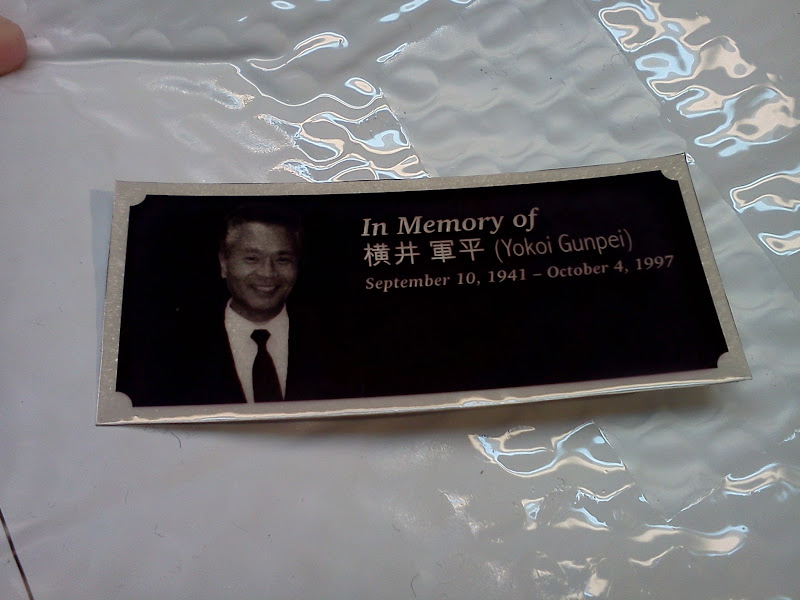

NO MORE!!
Tighe
  • Posts: 34
  • Last login:May 04, 2023, 10:19:57 pm
Re: Arcade Virtual Boy Project
« Reply #13 on: June 12, 2011, 06:13:10 pm »
WOW. Awesome.  :notworthy:  You need to sell the template or a kit.  ;D
(I agree with Xiau2 on outputing sound to proper speakers via the headphone jack).
PS: Isn't the guy's name Gunpei?
Wow!  Can I even call that a typo?  I guess I will be fixing that!  Why did I type "y"???
Tighe
  • Posts: 34
« Reply #14 on: June 12, 2011, 06:28:13 pm »
Really thank you for noticing that!  I already made a new one, I am just waiting for the clear coat to dry:

« Reply #16 on: June 12, 2011, 07:21:39 pm »
Corrected Dedication Plate Installed!

How did you make the dedication plate?
Tighe
  • Posts: 34
« Reply #23 on: June 13, 2011, 10:18:43 am »
Amazing job, really well executed!
It is a neat trick I came up with.  I printed it on clear full page shipping labels from staples in my laser printer.  I applied it to the aluminum, and then since the label is matte finish, I then coated it with a Krylon Triple Thick clear acrylic.
Lables:
http://www.staples.com/Avery-8665-Clear-Inkjet-Full-Sheet-Shipping-Labels-8-1-2-X/product_45759
Triple Thick:
http://www.krylon.com/products/triplethick_crystal_clear_glaze/
« Last Edit: June 13, 2011, 11:27:13 am by Tighe »

« Reply #25 on: June 13, 2011, 11:40:31 am »
It is a neat rick I came up with.  I printed it on clear full page shipping labels from staples in my laser printer.  I applied it to the aluminum, and then since the label is matte finish, I then coated it with a Krylon Triple Thick clear acrylic.
That is brilliant.   :cheers:
I agree! Gonna have to consider that myself. Did you cut the aluminum yourself?
Tighe
  • Posts: 34
« Reply #26 on: June 13, 2011, 11:57:50 am »
Yes, I bought a roll of aluminum flashing at the hardware store I used it for my florescent red plexi Xbox 360 control panel I built, I had a ton left over, it is nice and thin, you can cut it with scissors.  I had heaver aluminum, but this looks great.
