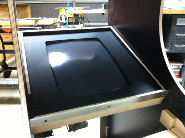

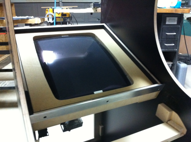

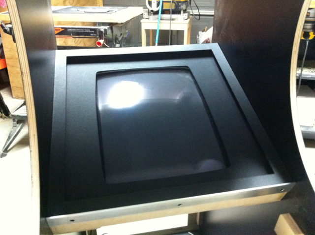

Made some progress with the monitor and bezel area.  I used black picture mat (with black interior) for the bezel.  The glass is 1/4 inch "gray" (have no idea what percentage that is).  Under the shop lights, I can barely see some details through the gray glass and the minor bezel provides a small sense of depth.  I was concerned I wouldn't like this arrangement, but now that I've seen it... I'm very satisfied with the results.  ;D

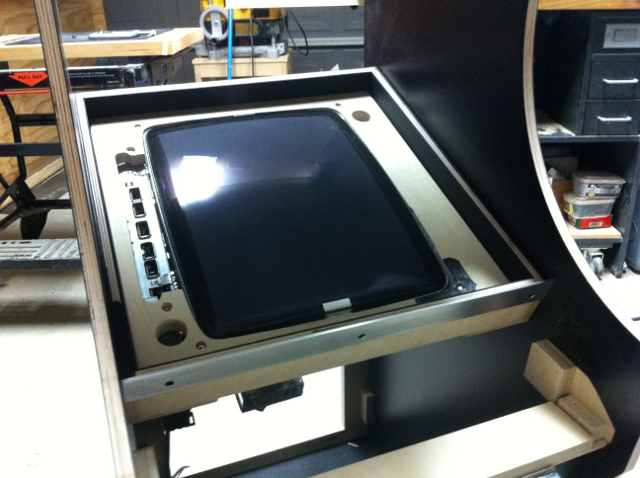

I've shown the monitor mounted before, but this image shows how I blacked out the insides of the frame that holds the monitor board.
Since my bezel is flat, and the monitor is all kinds of curved... I made an MDF spacer to raise the bezel high enough to clear the edge of the monitor.
On top of that I put the actual monitor bezel.

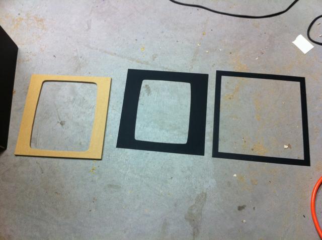

The easiest way for me to trap light leaks was to make another "minor" bezel that sits on top of the monitor frame.  This prevents anyone from looking directly toward the edges of the main bezel or the MDF spacer.  If you look straight on, the minor bezel hides the light leaks.  If you look at an angle, the light is not visible.  I tested it at all sorts of angles with my garage door up (another blistering sunny day here) and there was no light leaks. :)
These are the individual components... MDF spacer, main bezel, minor bezel.

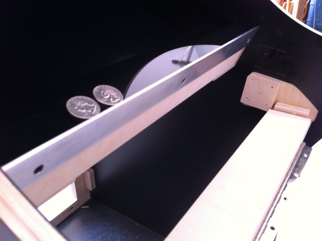

To keep everything from sliding off, I mounted a strip of aluminum on the front of the monitor frame.  I mounted it so that the strip is just a little proud of the glass so that tokens or quarters can be placed there. That's the kind of stuff its all about for me. :)
And a very anxious customer.
EDIT: The monitor looks small in the last image because it's swimming in a sea of black.  When viewing it in the flesh, it is very easy to distinguish the sides of the cab and it doesn't look so small.
Seven days and counting. :)

very nice, what material is the black bezel made of? It has a great factory finish.
Will you still be using that 2.0 speaker set? This cabinet needs deserves something better  :D
Nice to see you using glass, cause when i saw you putting coins there, i thought that would scratch a lot on plexi

The bezel is just black matting used in framing pictures.  I got mine at a local craft store, "Hobby Lobby", but any frameshop should be able to get it.
Sadly, I know NOTHING about speakers.  I plugged those crappy ones in a few weeks ago, and it sounded like I was playing the game on my phone. :)  I was talking with a coworker and mentioned that I was going to have to buy a new set of speakers.  He told me he had a set of Cambridge Soundworks speakers he wasn't using anymore, and that needed a good home.  The price was right (free) so I figured I'd give them a try.  Honestly, I didn't think the older games from the 80's would sound any better on this system than the crappy one I had.  So, when I got them home, I hooked them up and loaded Donkey Kong.  WOW!  The sound was incredible compared to the 2.0 speakers, and the subwoofer was sooooo nice. :)
I've got six days left that I can work.  :o  I plan to put the CP together today, and button up the back.  I've got the coin door installed and all the construction (short of the CP) is finished.  The PC is running and has MALA and MAME installed.  So, after today I've got to do the wiring, lay down the art, and install the t-molding.  I also have all day Friday off from work.  If I get into a crunch I could also take Thurday off (or maybe just a half day).

I'm really thinking of making a two player, all in 1 control panel that I can hook up to the living room TV.  There are some really great horizontal games that I think would play great on the big screen.
To get the front button to fit, I had to take my Dremel and "eat away" about a 1/4 inch square area of the joystick black base.  I don't think I compromised the strength any significant amount.  You can't see it in the photo.  It was just pure luck that the button didn't affect the restrictor plate or the circuit board of the U360.
