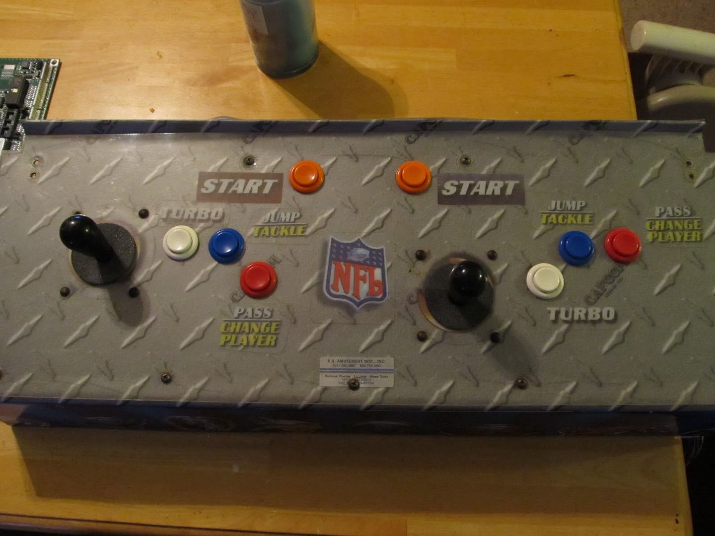

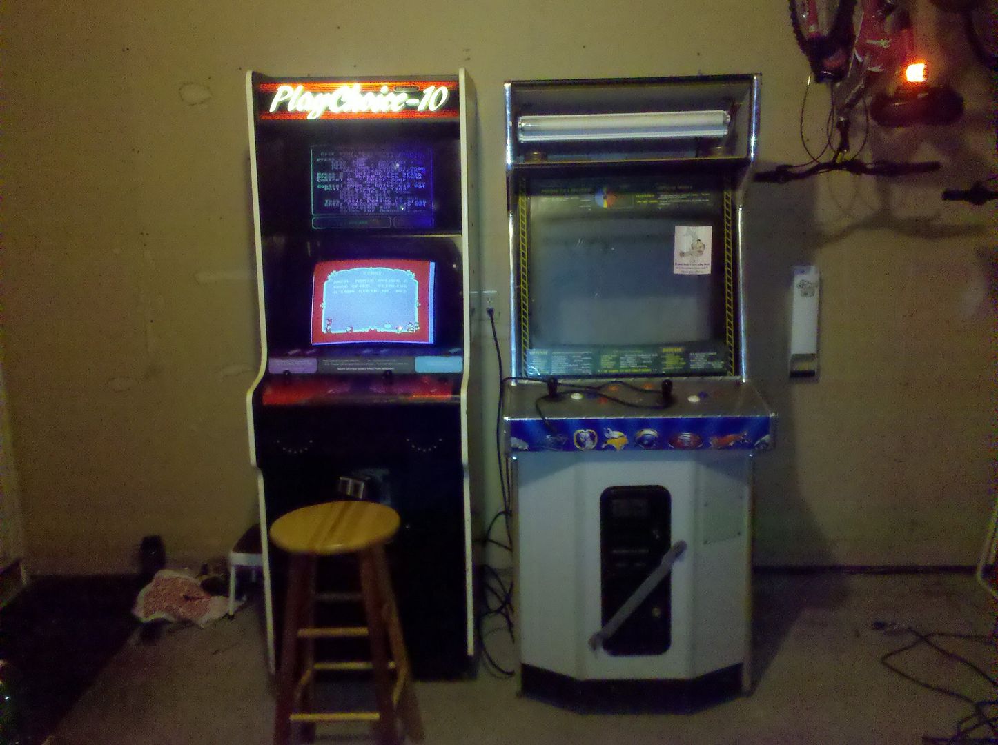

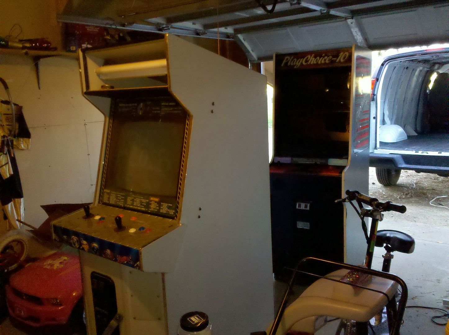

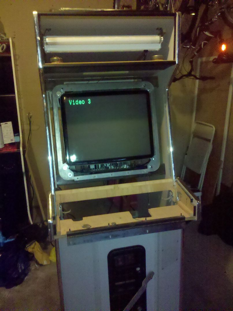

Hey guys, just wanted to show people the project I've actually been able to start now that the weather is warm enough. I drove down to central Iowa to pick up a Nintendo Playchoice 10 last October that I was gonna receive in a trade for my sega dreamcast store unit. When I got to this guys house, I couldn't believe the collection of games he had, I was in heaven! Anyways, I got my game and we go into his garage to chit-chat, and he's got a bunch of arcades in various states of disrepair. Long story short, I barter with him on this NFL Blitz cab that doesn't have a monitor, that I have the intent of mame-ing, and I was able to take it off him right then and there for 40 bucks. Pretty good deal I think. Anyways, these posts are no good without pictures, so here we go!
Here's my toys after I got them unloaded...

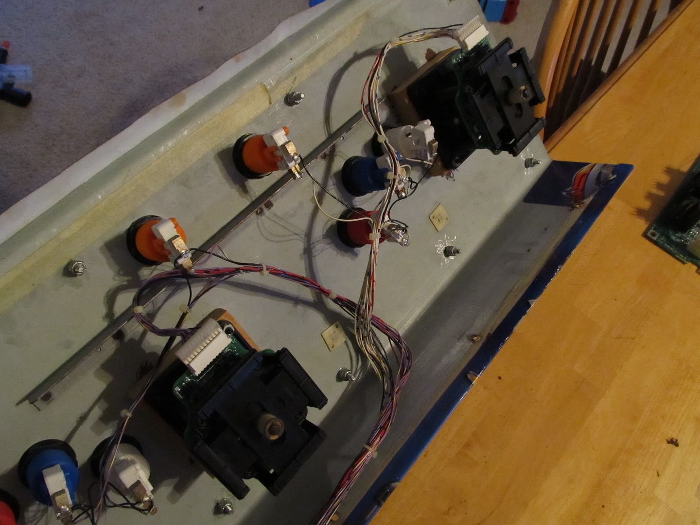

This was my first attempt at a replacement control panel... It didnt fit, it was an 1/8" too wide
I made another cp recently, that one fit, but it wasn't what I wanted anymore after trolling the forums... so i've decided to wait until I actually get my new joysticks and buttons before I design a new cp.

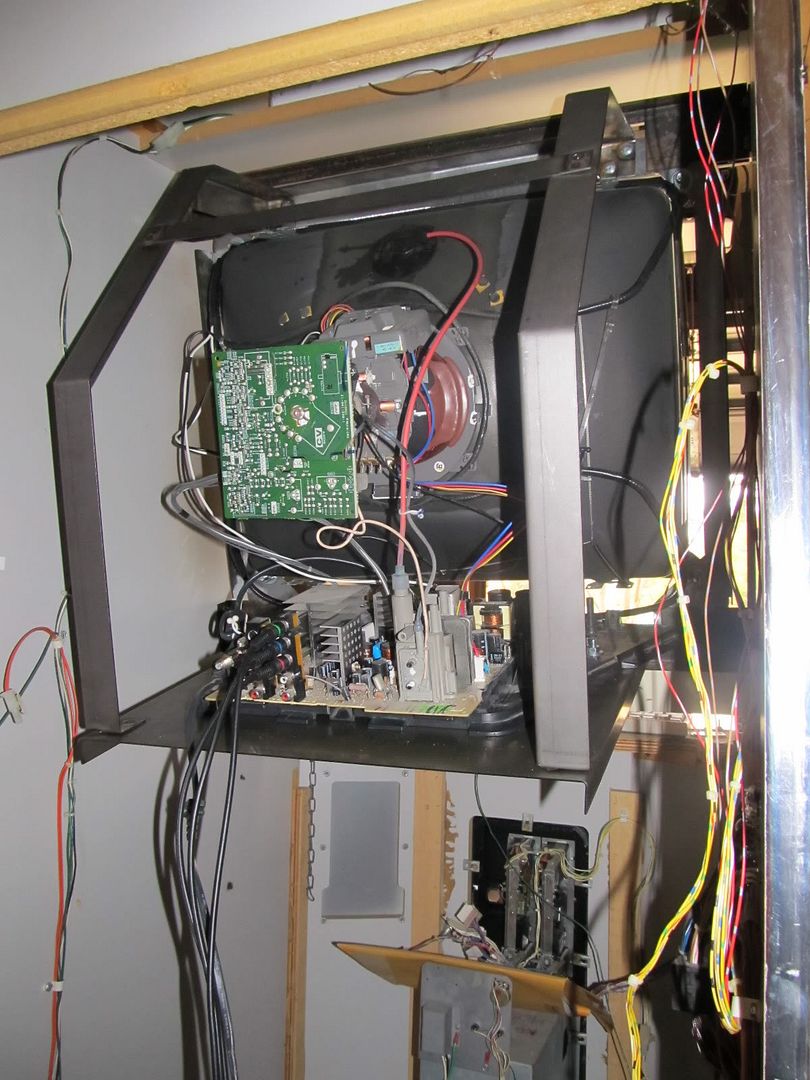

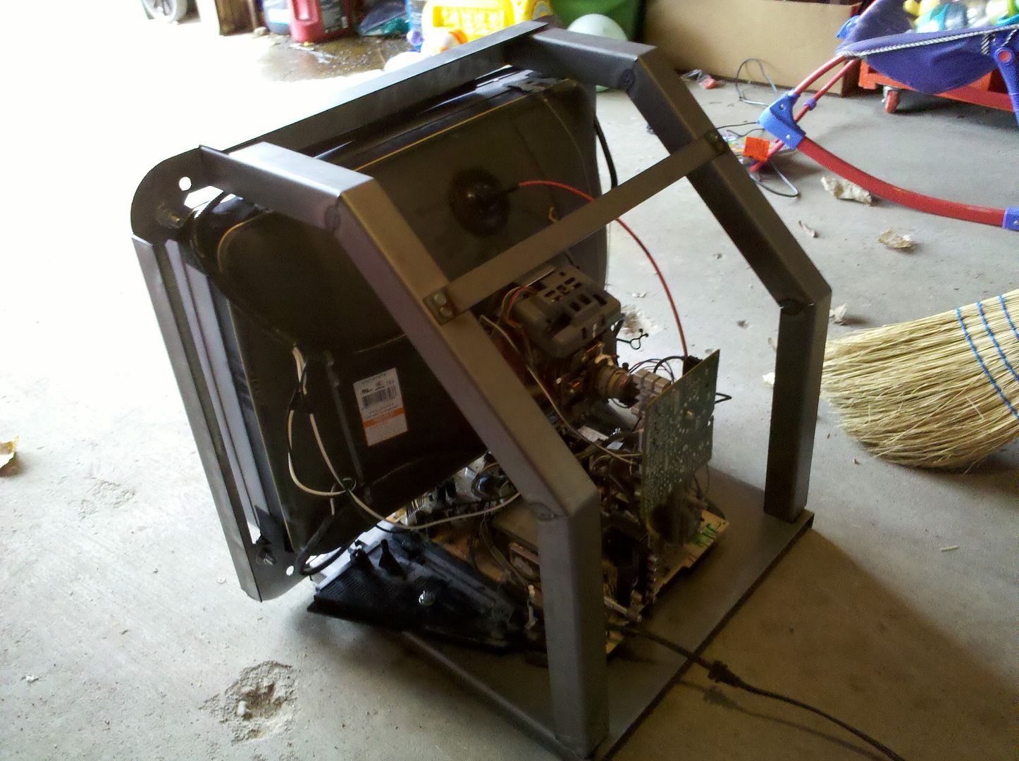

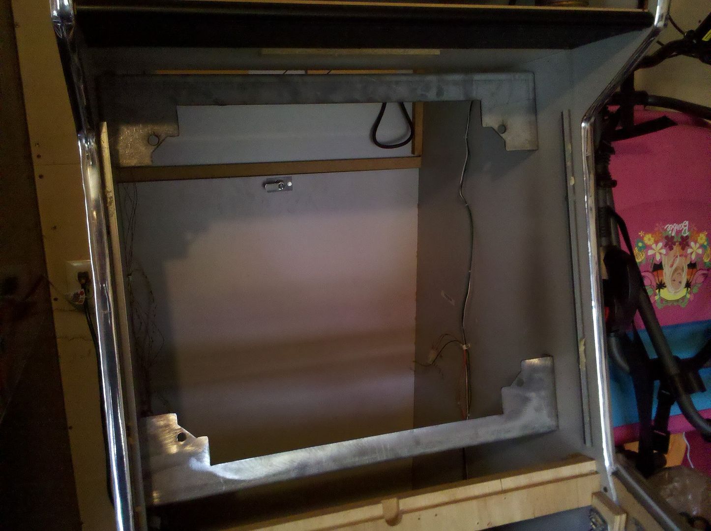

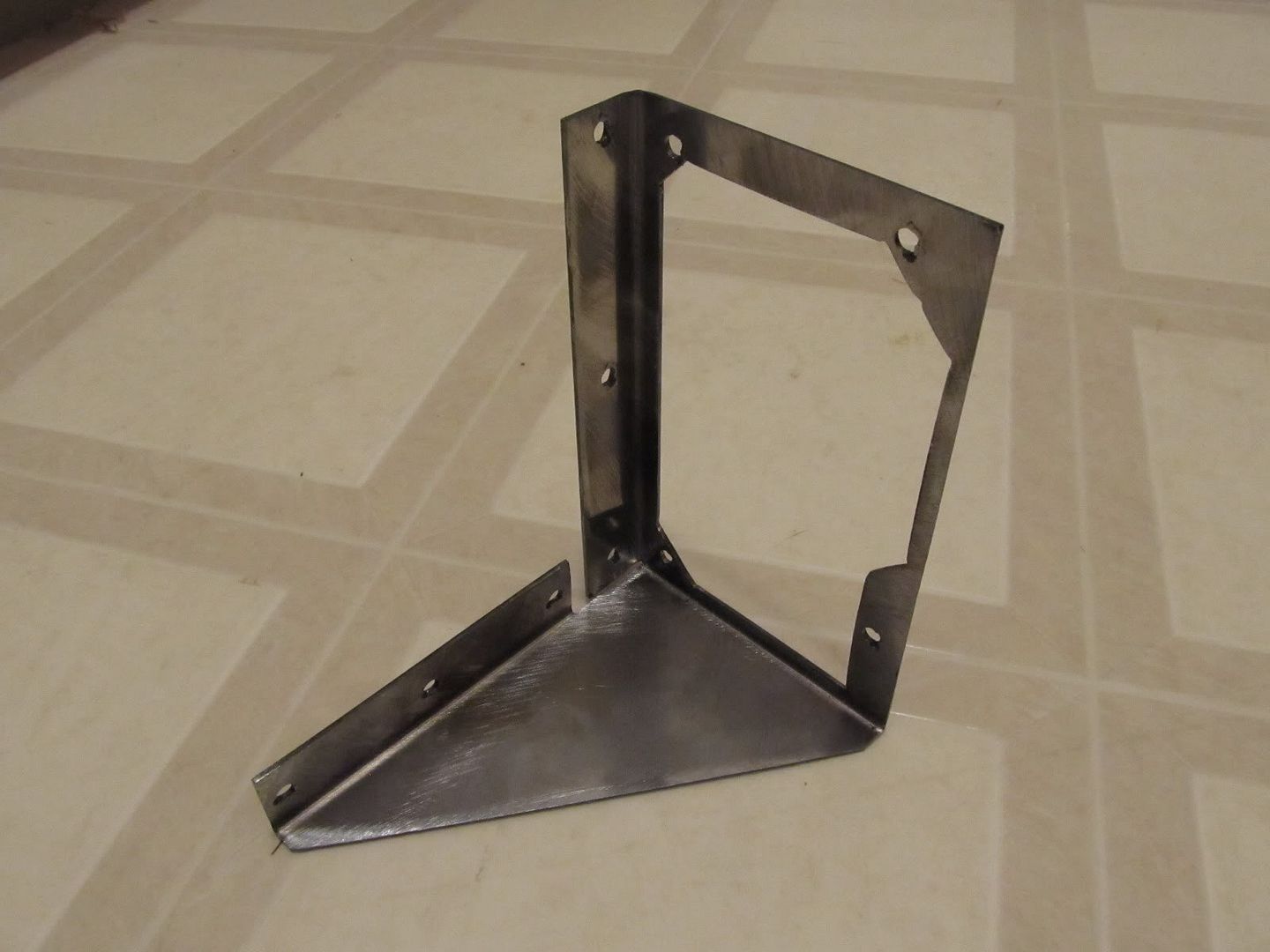

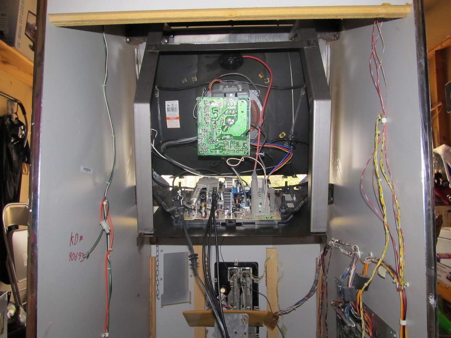

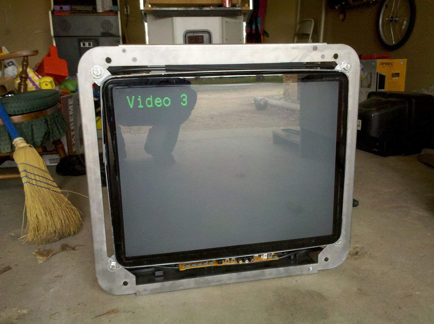

I picked up a TV for the cause off craigslist for 50 bucks last fall as well, it was a sony wega 24" flat tube, very nice.
I got the TV all decased and measured the location of the mounting ears and made up a few mounting brackets to replace the ones that were in the cab.
Everything came out perfect until I realised I had no place to mount the TV control board! So I came up with this bad mother effer.  :afro:

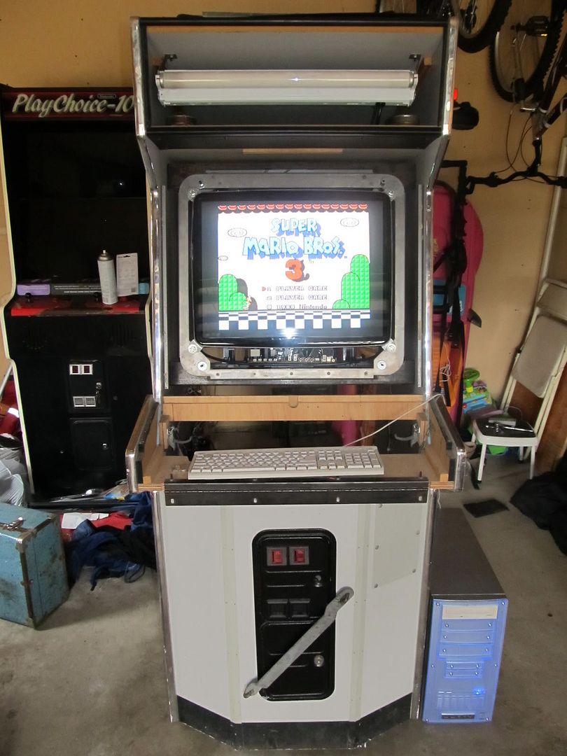

And here it is mounted in the cab...
And this is where I sit tonight...

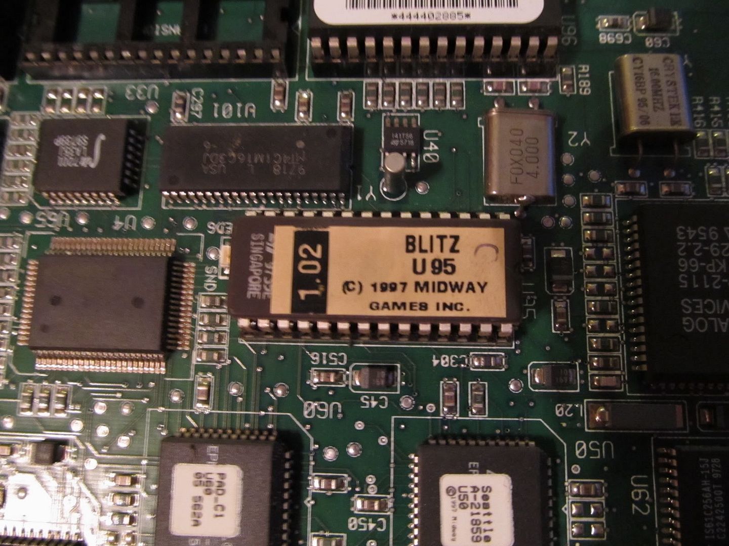

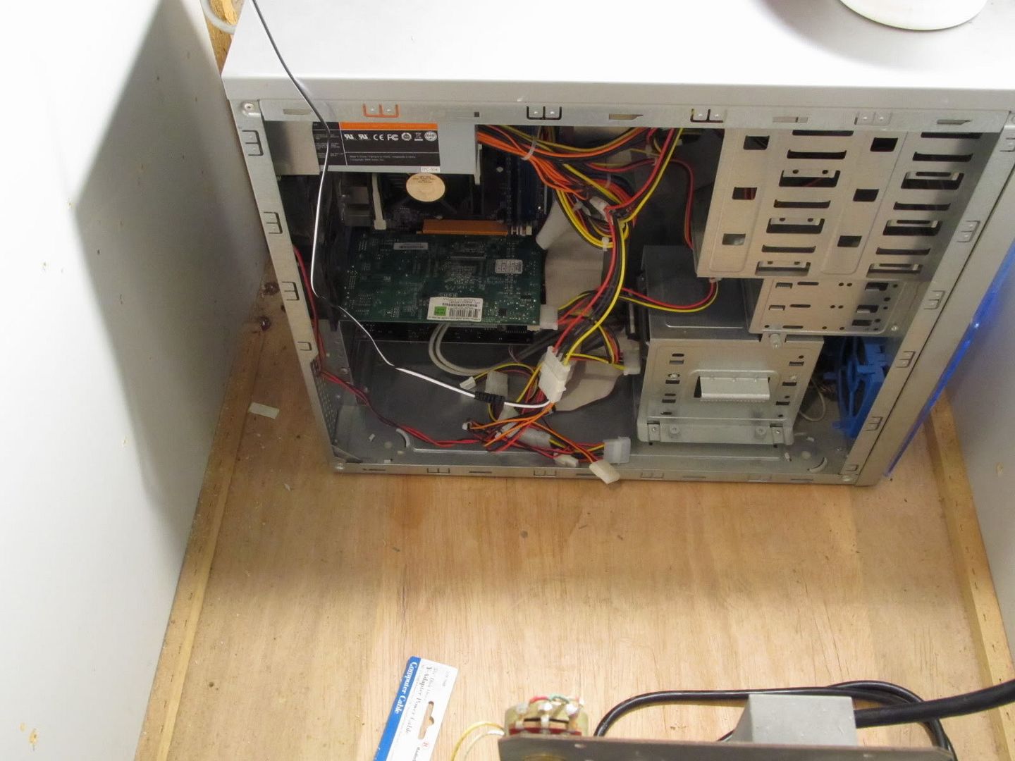

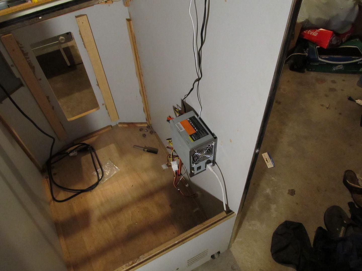

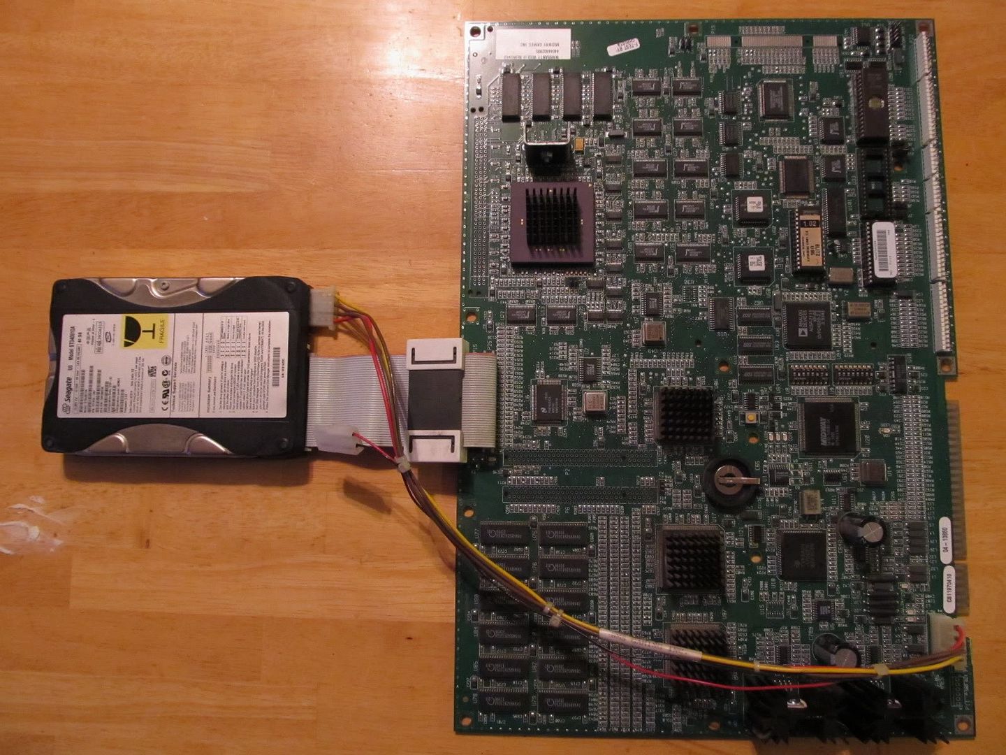

I pulled out all the old wiring and the NFL Blitz board tonight as well, so if anyone wants to pick the stuff up, you can have it! I have the board with hard drive, all the JAMMA wiring, the cp with 49-way joysticks... The game does play blind, since I never had an arcade monitor to try it out on.
Re: First MAME project!
« Reply #4 on: April 28, 2011, 10:51:13 pm »
Man, metal CP, custom monitor frame... what's your profession? Nice job on the monitor frame BTW. :applaud:
If I was close enough to you, I'd take that Blitz stuff off your hands, but I live in BFE, I'm close to nobody. :-\

I'm an industrial designer for a large door manufacturer, so whatever I can dream up in SolidWorks, our shop can cut on their plasma table. It's a pretty sweet perk, and its all scrap metal to them anyways, so I get it for free! Here is the cp i've designed so far... still needs some tweaks after I get my actual parts.

wanna ship the blitz stuff? I'd pay for shipping and stuffs.
Also, if I had a dollar to bet, I'd say thats a Virtua Fighter cab TV Frame looks fantastic, cant wait to see the end result.
elkameleon
  • Posts: 528
« Reply #8 on: April 28, 2011, 11:08:11 pm »
You would win that bet, because it is indeed a virtua fighter cab that was converted to Blitz, still has the sega serial number sticker on the back... The glass still has the classic "caution" black and yellow bezel sticker still on it. I'll be replacing the glass with smoked plexi at some point. As far as shipping the blitz stuff, i'll get back to you on that, my fiancée works in shipping, so she'll be able to give me some options.

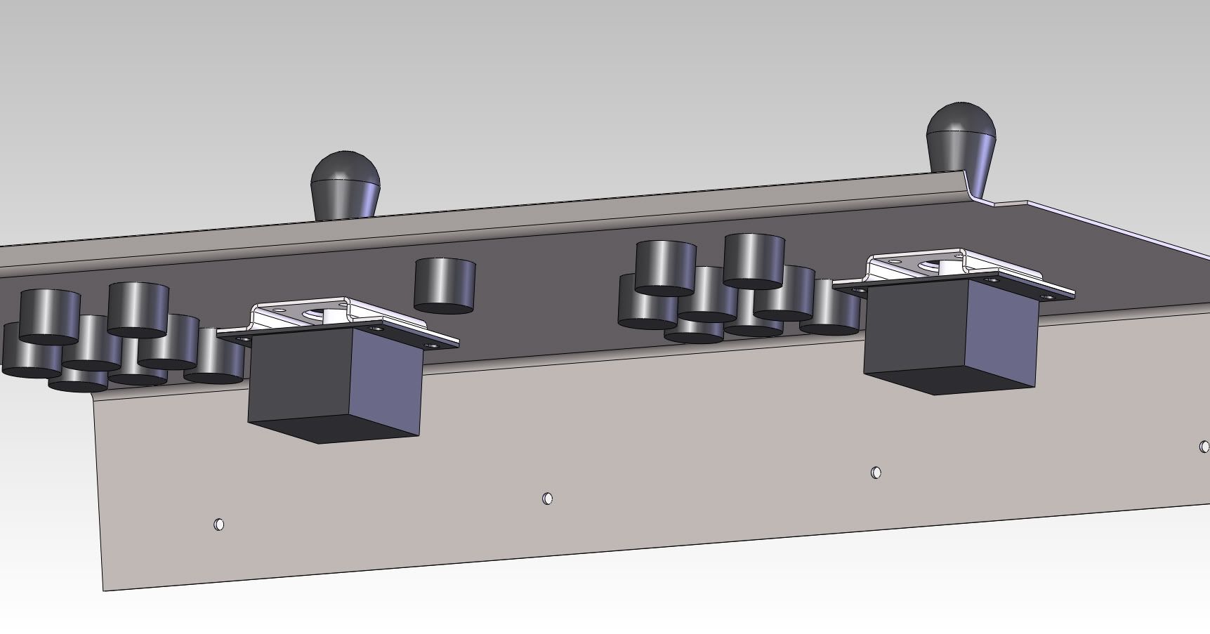

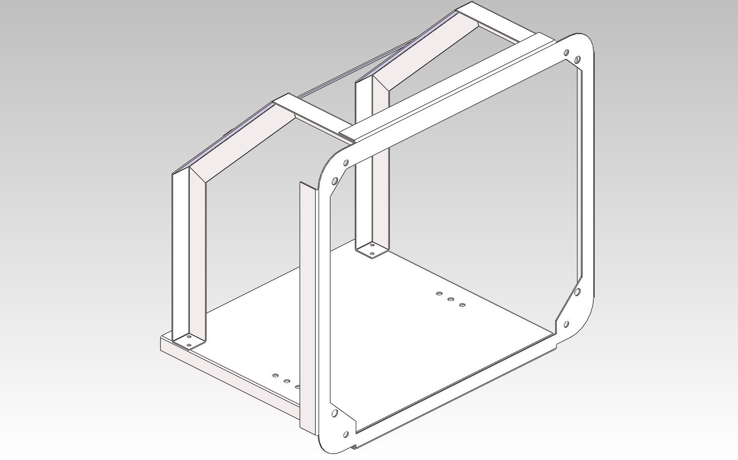

I just though i'd throw my design for my monitor frame in here since I got so much praise on it, kinda gives ya a better idea of how its made.

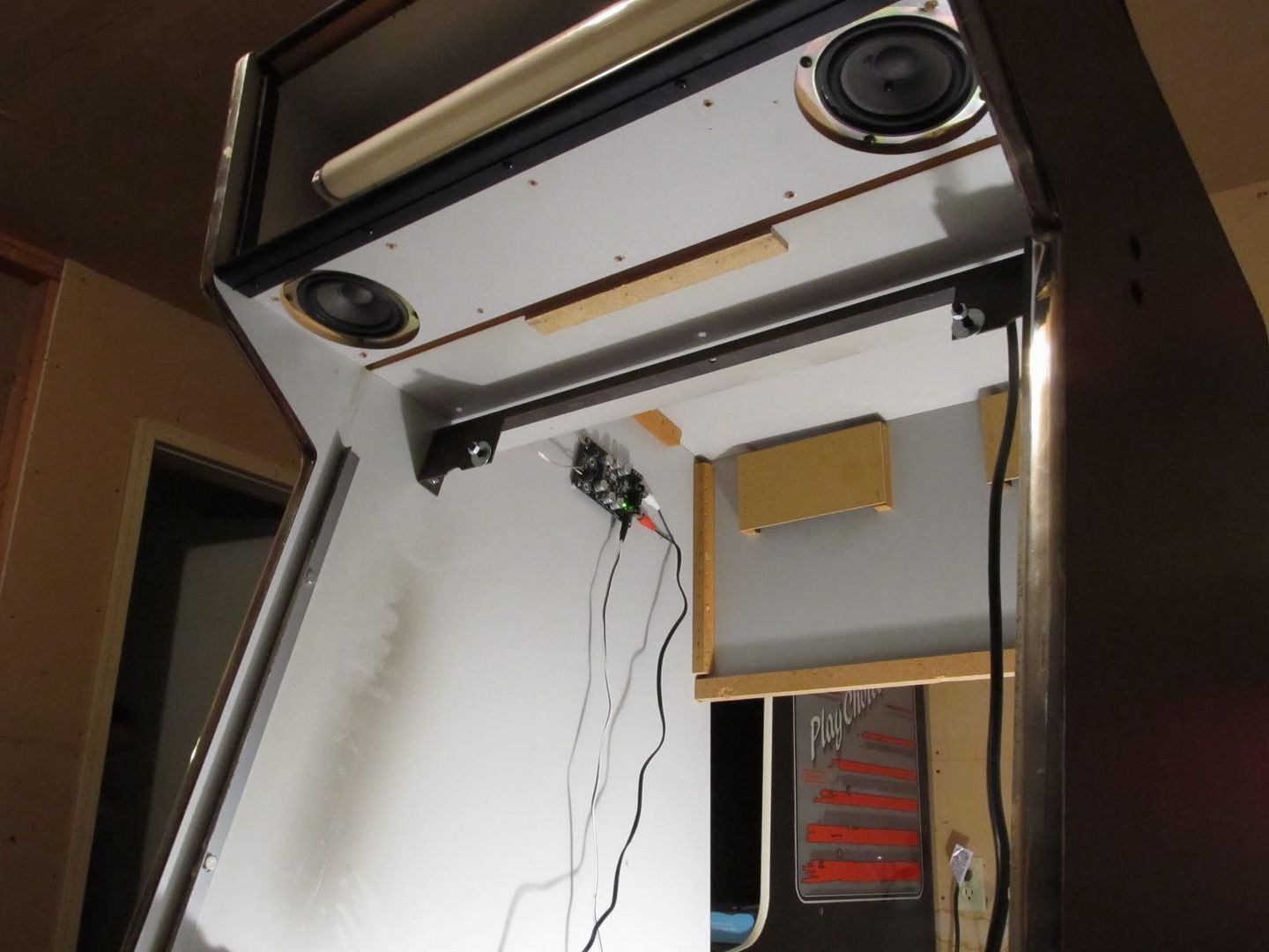

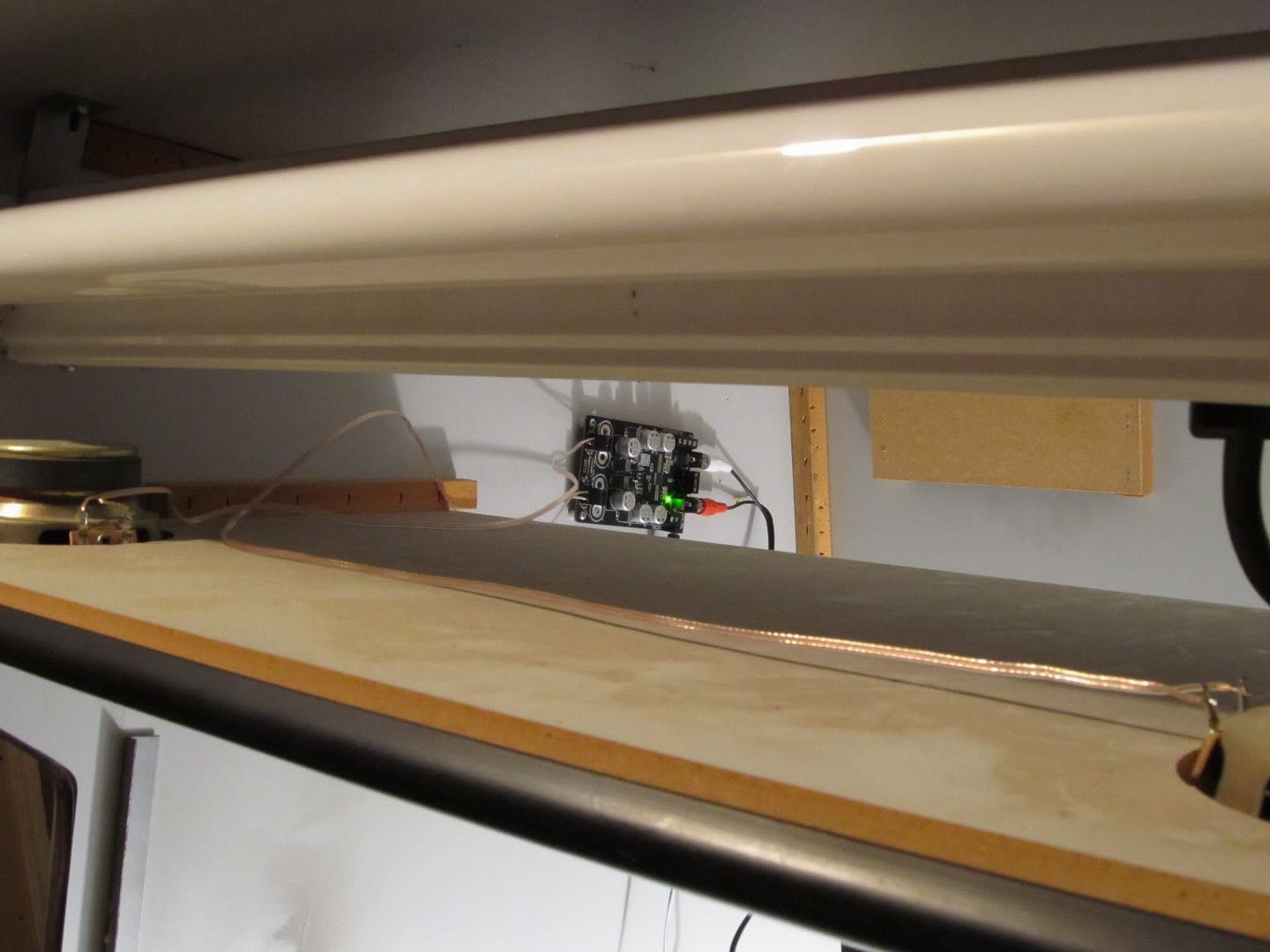

Today I ordered this audio amplifier for the speakers that were already present in my cab. The speakers were labeled 4ohm @ 13-26watts, and they sounded pretty good when I had the NFL Blitz game running, and they fit, so might as well use 'em!

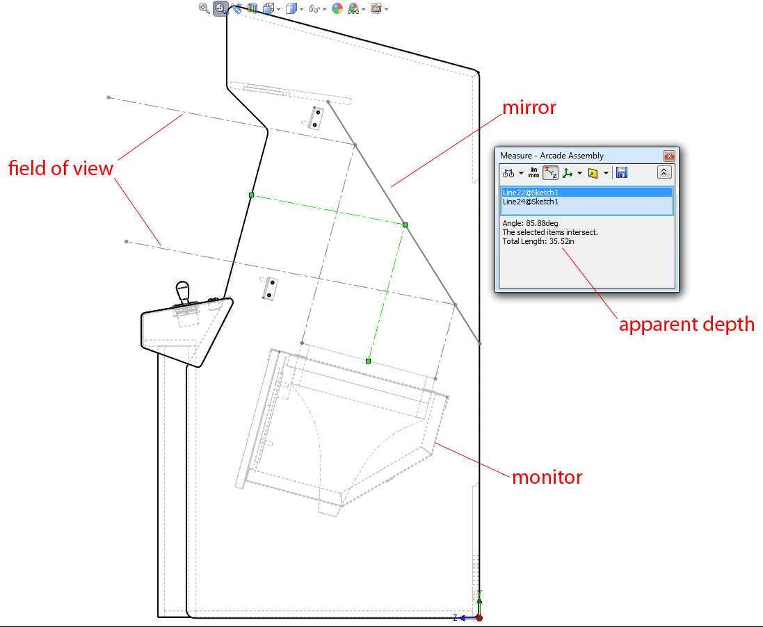

I've been toying with this idea for a while now, just wanted to hear what others though about it. I want to use a mirror to basically simulate depth, so it doesnt seem like the monitor is trying to burn through your soul after extended bouts of butt whoopins  ;D With my proposed model, it would appear as if the monitor is about 35" from your face, instead of 6"...
EDIT: apparently this site hates large images... so I cropped it down, hope this works better.

2 questions:
1. How do you fix the reverse-text issue from the mirror? Does your video card support rear projection mode or such?
2. If that's to scale, can you still fit a PC inside the cabinet with the monitor housed down there?
With an arcade monitor, the YOKE cable setting can mirror flip the image. Might work with that TV as well...

Yeah, you can flip the yoke wires to get the reversed image, and yes, there is room for a pc at the bottom, you could just lay it on its side and it would fit no problem. But after thinking about it, i've already mounted my monitor, so I think i'll just leave it as is, and if I build another cabinet, i'll try this out :lol

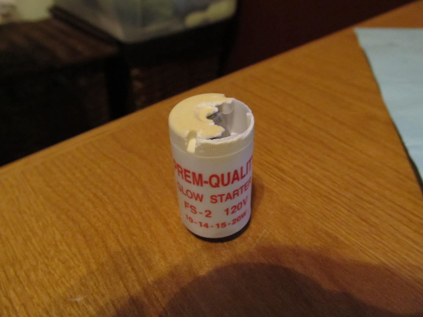

Got some time this afternoon to work on my marquee light, got the power cord replaced. Only after I bought a a better wire stripper/crimper that I tried to scrape by with a $1.99 one... That'll teach me to skimp on tools next time, I threw that crap away after about 5 mins of frustration and went a bought a good one. :angry: Anyway, I plugged it in and... nothing. Turns out I had a bad starter that basically crumbled as I tried to remove it. I'll pick another up at Lowes tomorrow.
sapro
  • Posts: 43
  • Last login:May 29, 2011, 09:22:01 pm
« Reply #28 on: May 07, 2011, 08:36:40 am »
What's the starter for :dunno
elkameleon
  • Posts: 528
« Reply #29 on: May 07, 2011, 08:50:22 am »
Its sort of like a capacitor, kinda gives the florescent tube the jolt it needs to get its glow on. :lol Without it, it is basically useless.
EDIT: picked up the starter at the local hardware store this morning. WE HAVE LIGHT! WE ARE GO GO GO! :lol

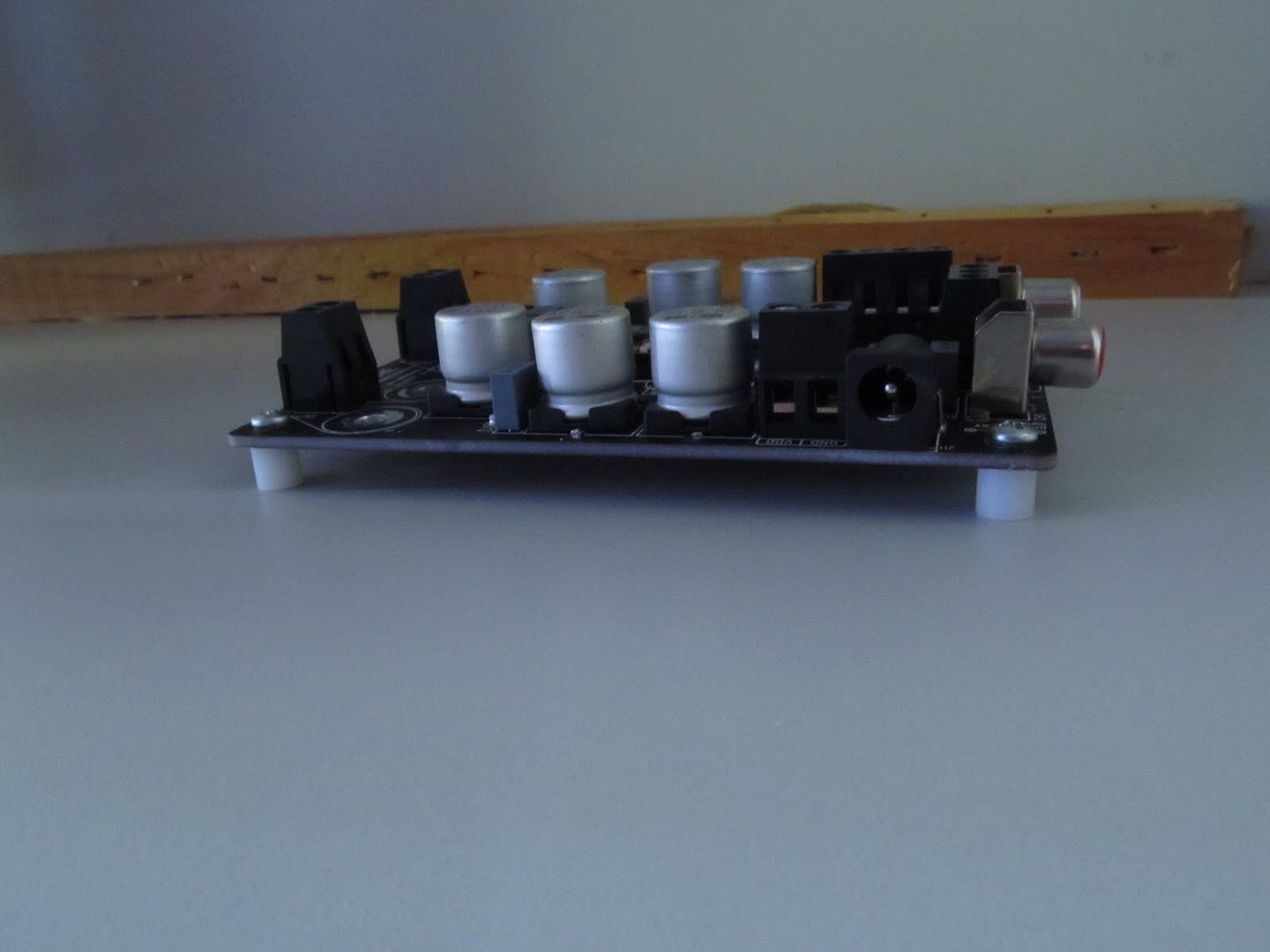

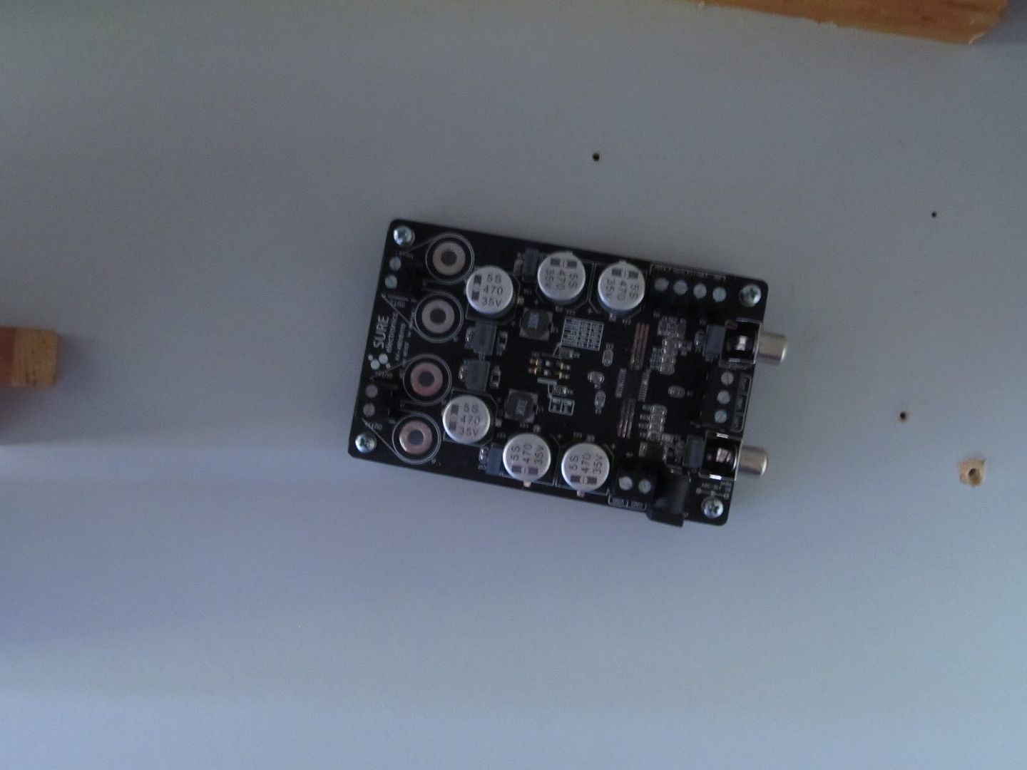

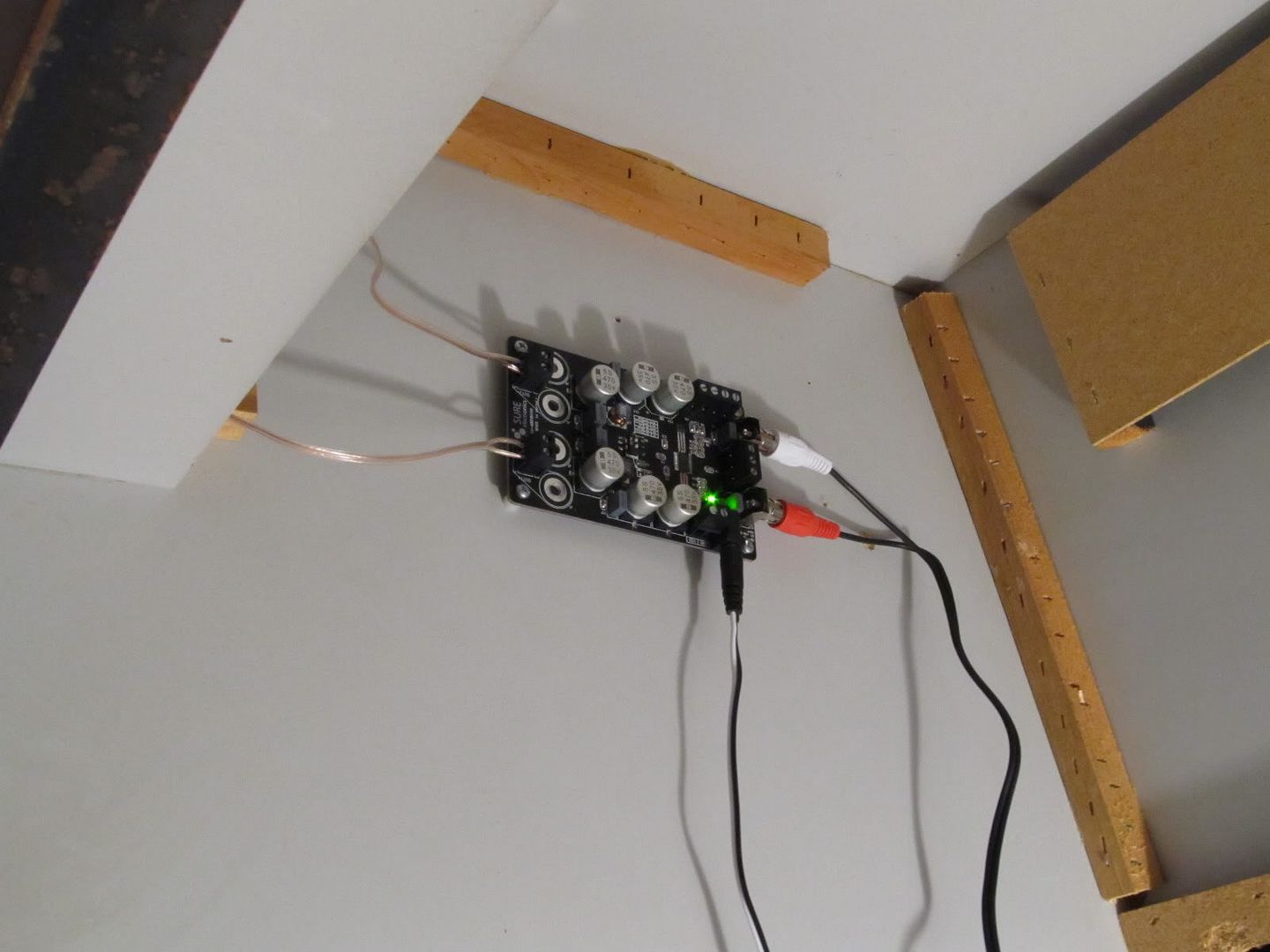

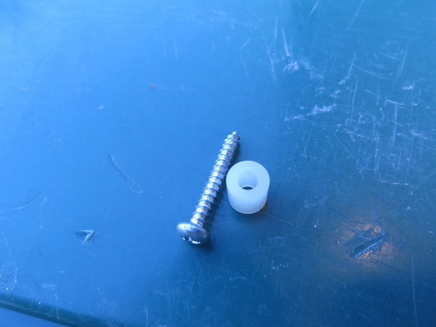

I got my audio amp in the mail today, couldnt find any pcb standoff anywhere, so the guy at the hardware store turned me on to these nylon spacers, they worked awesome!
tapped into the 12v on the psu to power the amp

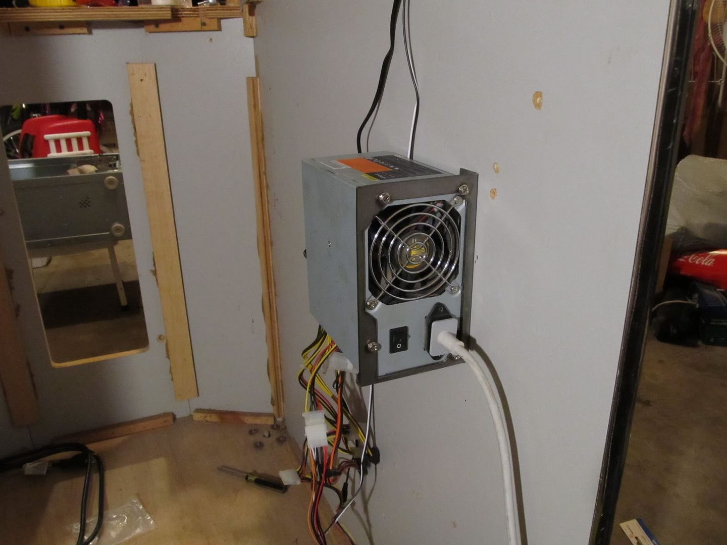

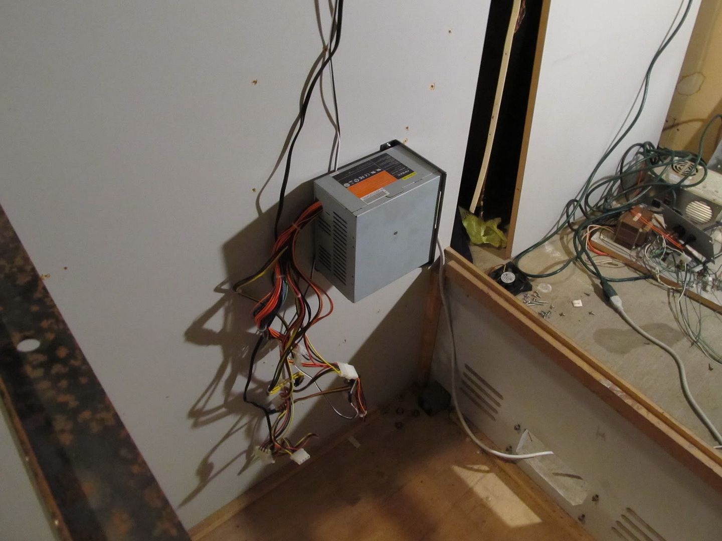

Got my custom power supply mount made up and installed, its rock solid!
I received all my controls from Ultimarc on monday. (shout out to Andy for the awesomely fast shipping!) I'm still waiting for my final revision of my cp to come back from the shop. I checked on it today, its been cut on the plasma table, just needs to hit the metal worker to get bent up. Hopefully tomorrow i'll be installing controls. :laugh:

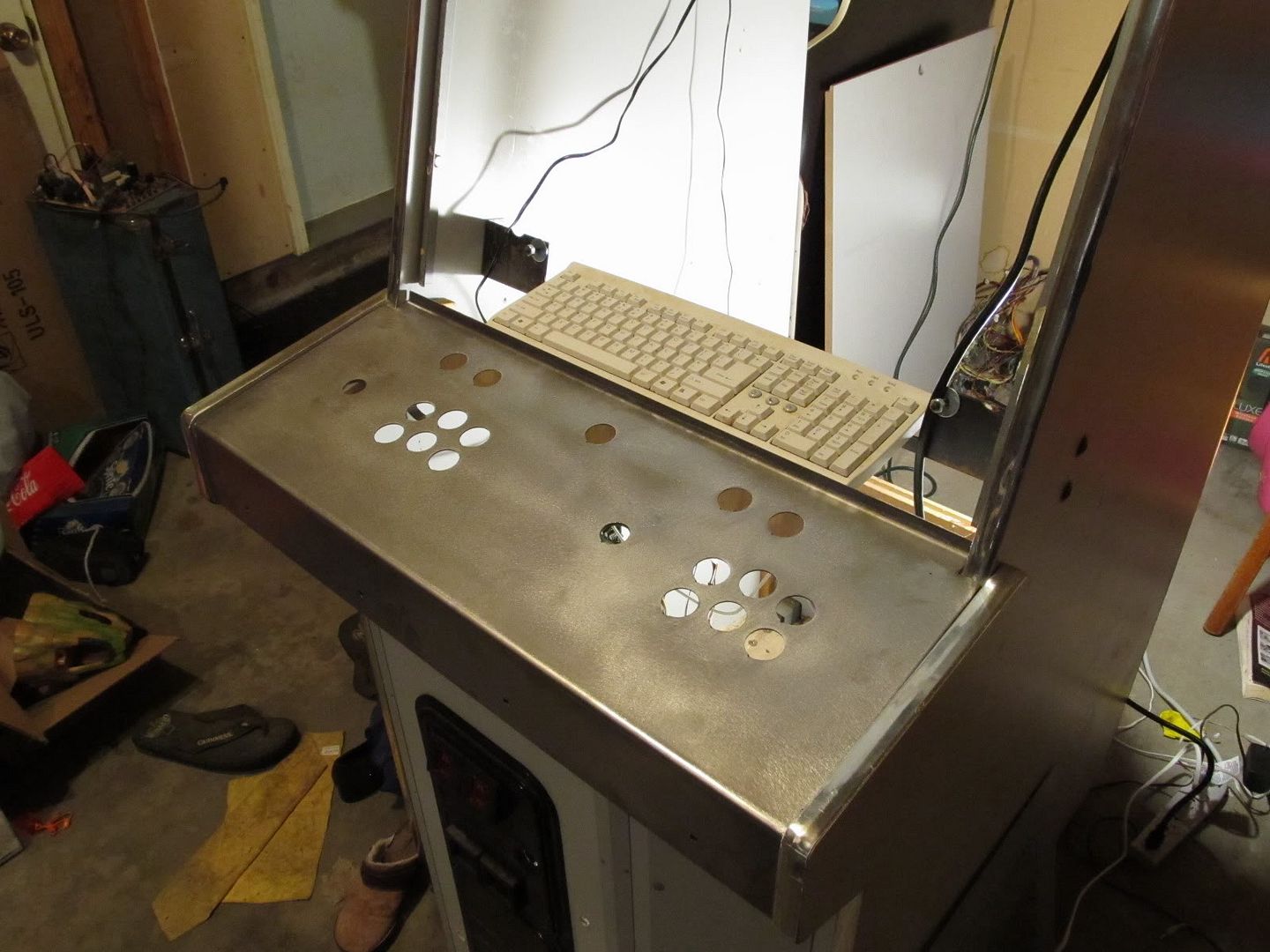

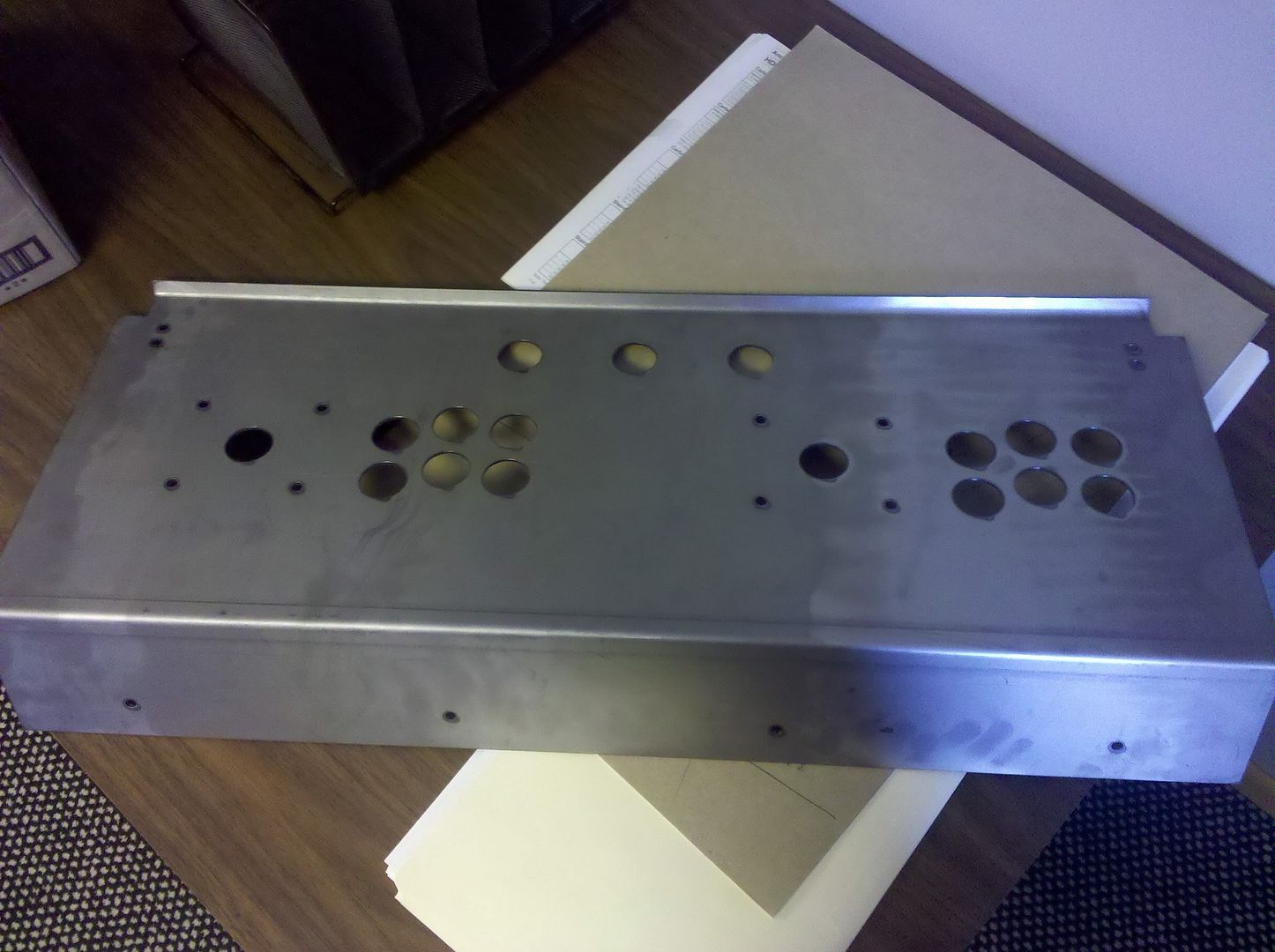

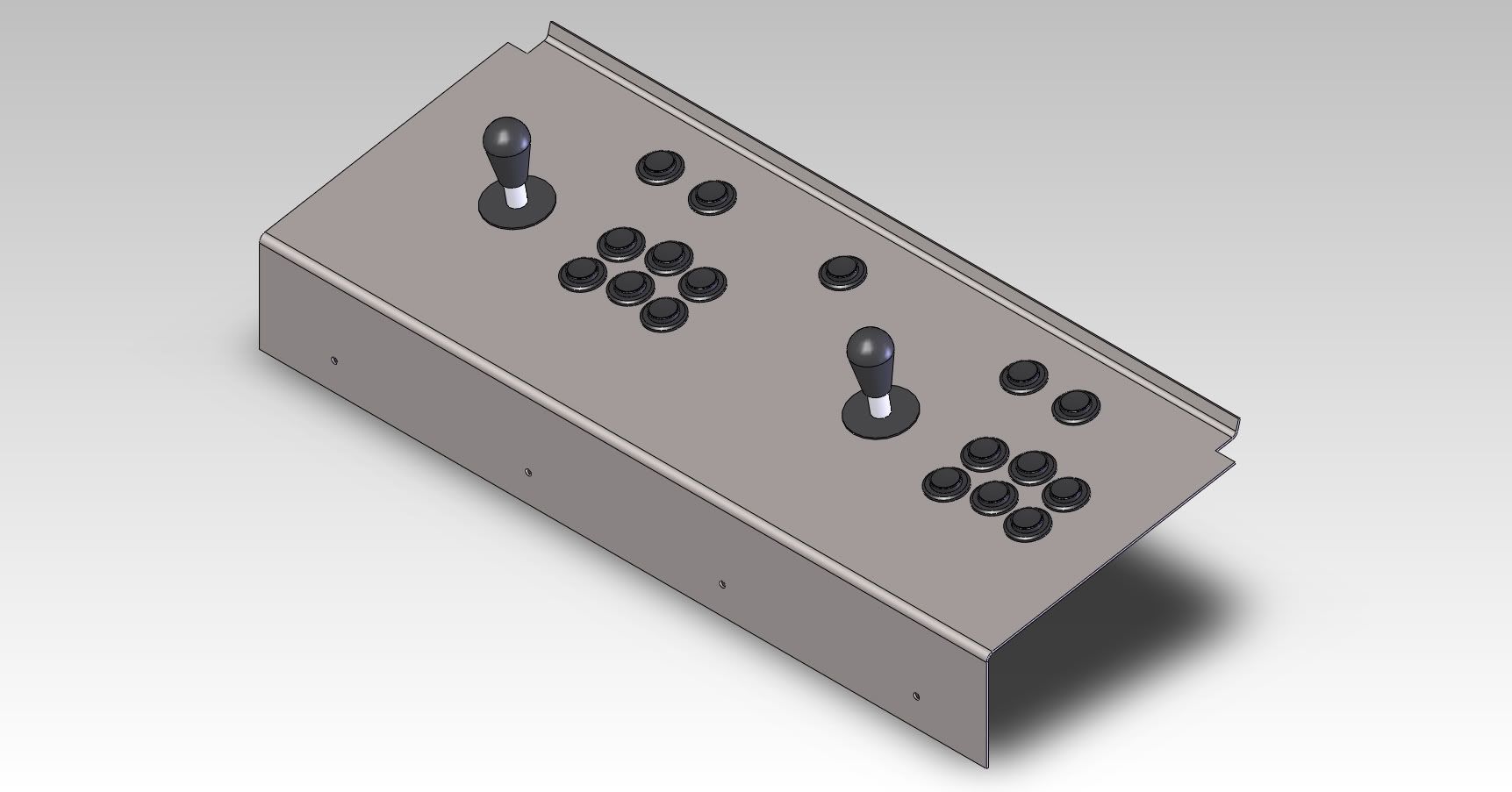

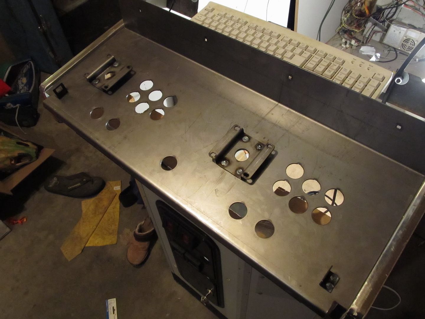

Got my cp all welded up and ready to rock!, gonna throw a coat of rust stop on it and wait until I can play. :cry: I'll post photos when I get home tonight.
EDIT: The guy that bent up my joystick standoffs apparently doesnt know what 'HOLD DIMENSION' means, so now my mounting holes are 3/8" closer together than i designed, making my weekend a ---smurfing--- BUST! I guess I need to pay for my metal working next time, instead of with cases of beer. :banghead:
« Last Edit: May 13, 2011, 06:31:33 pm by elkameleon »

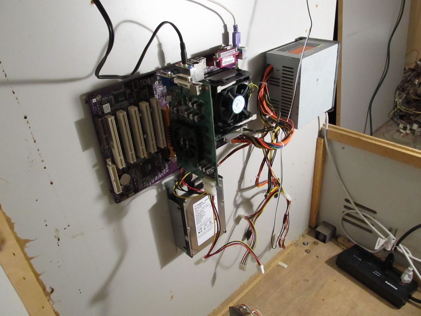

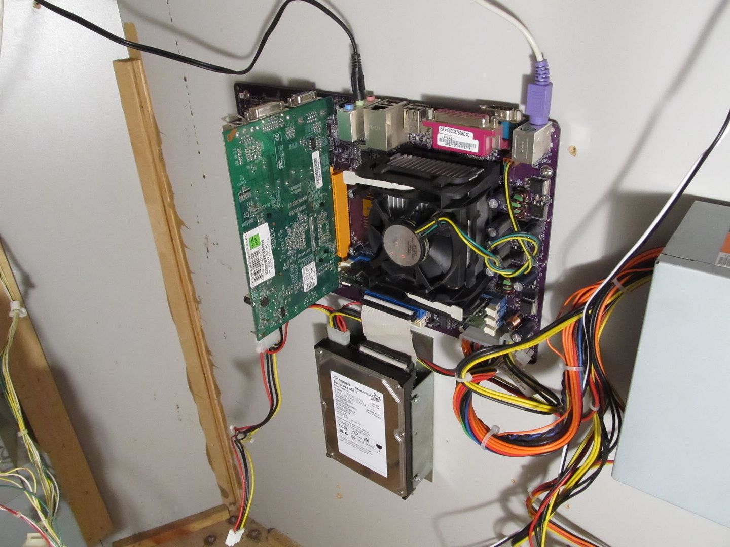

« Reply #38 on: May 14, 2011, 12:17:33 am »

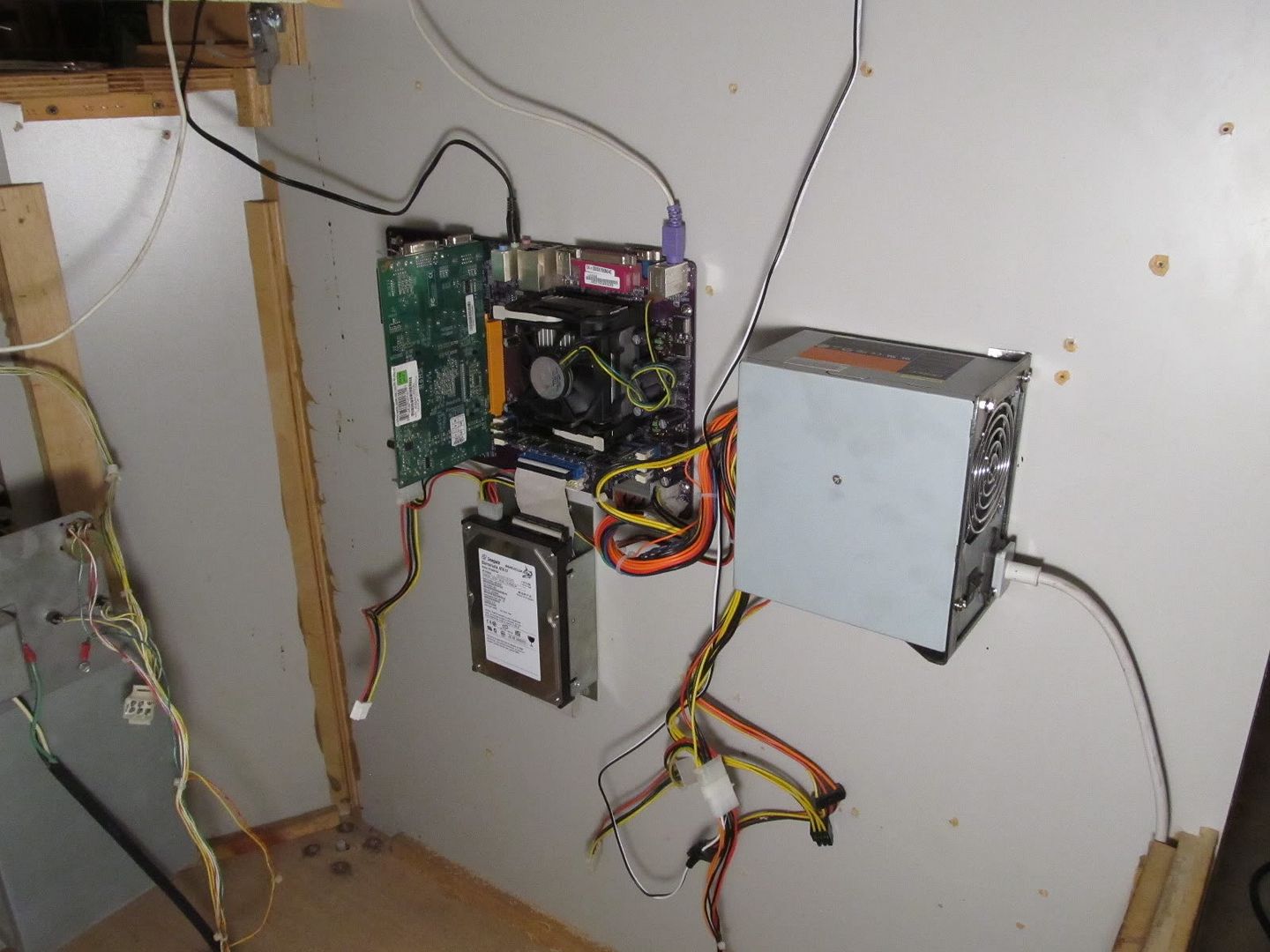

Got my motherboard and hard drive mounted tonight, had to re-drill the holes for the motherboard standoffs twice, their placement is pretty unforgiving :dizzy:
what my control panel would look like, if it wasnt wrong!
joystick mounting brackets :banghead:
