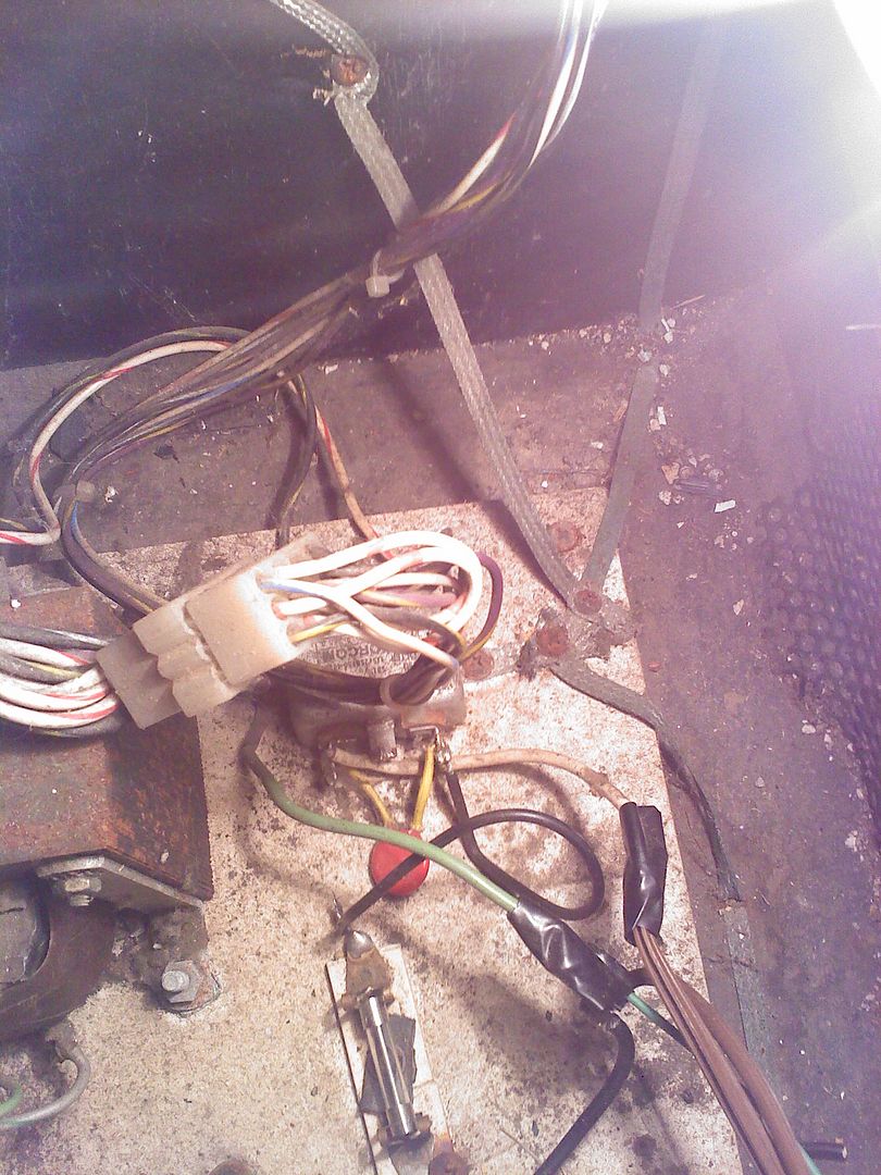

Re: Kampcool's Defender Original Restore
« Reply #2 on: April 01, 2011, 02:34:07 am »
Heres that funky powercord hack into the power supply

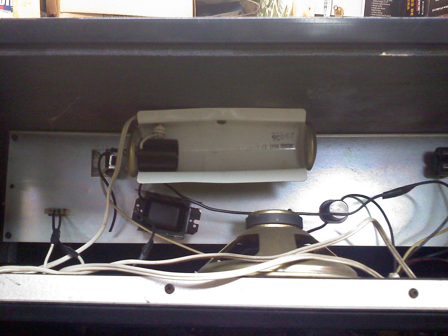

« Reply #3 on: April 01, 2011, 02:49:05 am »
Here is the after stock Marqee lighting change.

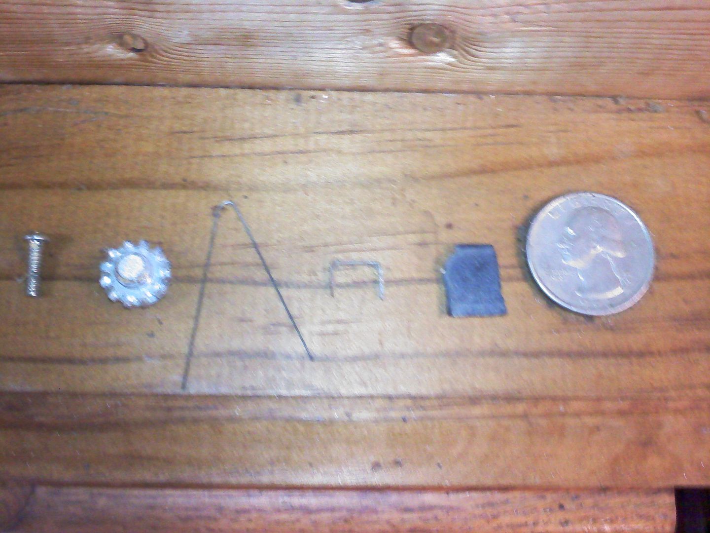

« Reply #4 on: April 01, 2011, 02:52:21 am »
Here is the hand picked loot I salvaged from the inside bottom

« Reply #5 on: April 01, 2011, 02:57:47 am »
Oh yeah, here is that on/off switch, that I have no idea where it belongs.
Also, there is some string there (if anyone knows what tag belongs here, I would highly appreciate)
Is this an orginal switch?  does it belong routed toward the coin door?  Any help would be highly appreciated.

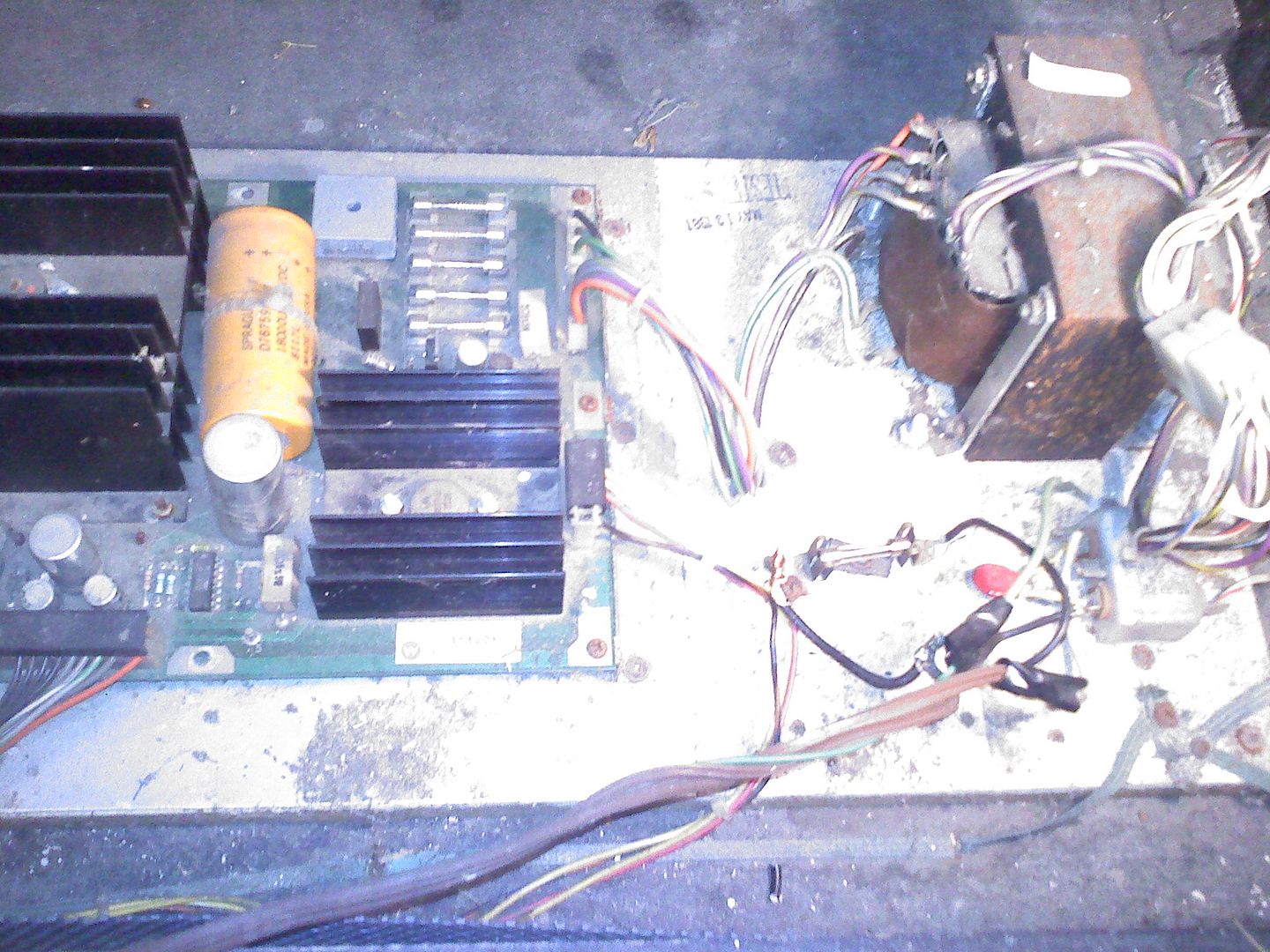

« Reply #8 on: April 01, 2011, 03:13:38 am »
Power supply

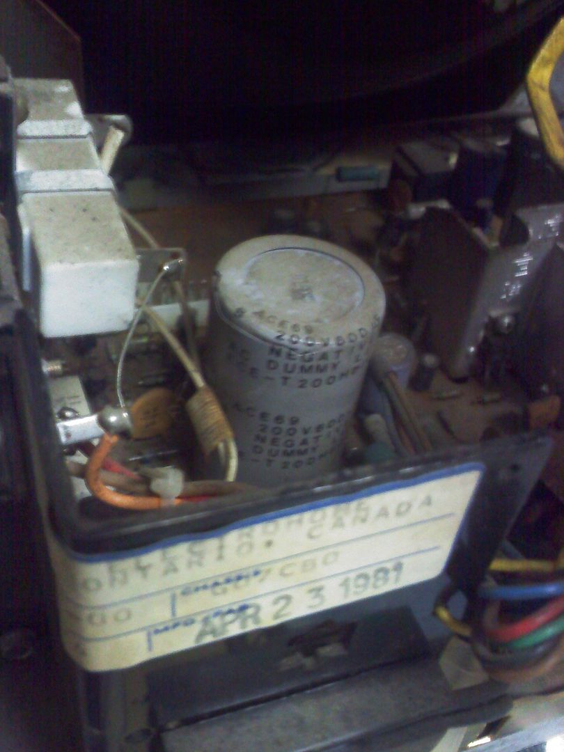

« Reply #9 on: April 01, 2011, 03:17:09 am »
19" Electroholme G07
OMG The original cardboard is still on the back. <grin>

Well, I posted this in your other post. Not retyping it, so here:
Saint's probably going go move this post to Restorations anyways, no need to spam multiple forums..
As for the cabinet, it looks to be in great shape already! Best defender I've seen pre-restore!
The artwork is really crisp and bright, and really, all you'd need to do is fix the bottoms and edges and youre good to go. great looking coin-door condition.  The bezel looks like it could use a polish.
Is it working? If it is, you probably don't need to put much effort into getting this to great condition.
Marquee light and power cord replacement is easy-peasy stuff. But what of the internals? Does it have the original linear power supply? Or a switcher?
Also, what was the offer you made that he sold it to you for?
I'm curious, cause physically it's in pretty good condition.
Looks like the original linear PS is in there.
That dangling switch is not stock. It's probably controlling the marquee lamp or something
As always, I suggest finding the manual and schematics online and give it a thorough read.
Welcome to your first restore. You've found a nice entry-level conditioned cabinet for it. Most of what you've posted seems very doable for someone getting into restorations.
Good luck and welcome!

« Reply #12 on: April 01, 2011, 03:29:46 am »
That switch toggles the machine On/Off after plugin.
kampcool

« Reply #16 on: April 01, 2011, 03:46:11 am »
Ok, Moving along now internally here is my poor old G07 right hand side from the back.

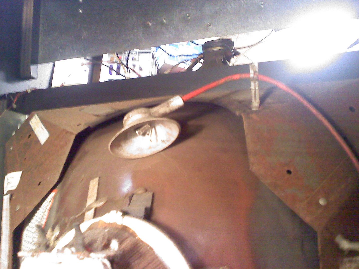

« Reply #19 on: April 01, 2011, 06:04:28 am »
 19" ELECTROHOLME G07 removal.
Disharged and anode removal at monitor.  I rubbered gloved and grounded my flatip screwdriver directly to a stake pounded into the ground. Also, I was off concrete and had the wife standing by with a 2x4. After it snapped, it took some loving before she would drop said 2x4.

you are not doomed...
  • Posts: 6173
  • Last login:January 22, 2026, 12:55:00 pm
« Reply #27 on: April 01, 2011, 04:56:36 pm »
+1
G07's are fairly common, and there's a lot of places that carry parts. Grab yourself the G07 manual and look up what that Cap is, then get a replacement. Check bob roberts' site, or Mike's Arcade, or even Arcade Shop.
While you're at it, get a cap-kit for it.  I know Bob has a full Deluxe Kit, (which may be a bit over board -- but couldn't hurt) that has a cap-kit, a width-coil, flyback, regulator, fuses...you could probably find what you need for C904 -- just be sure to check the manual for the specs.
Since you're handy with soldering, you should be fine with getting this game running in tip-top shape.. I probably have waaaay less soldering life-time experience than you do, (I took half a semester of Electronics class in High School, but switched to Home-Economics 'cause there were way more chicks in it) :) but I'm pretty confident with an iron now that I've got a few repairs under my belt. You'll be fine.
Looks like they rigged it up so that you don't have to bend down to the bottom right corner to flip it on. There's  supposed to be a hole at the base of the cabinet in the back there, which the switch sticks out for you to access.
As long as the push button back door switch is taped closed.
From the looks of your picture, the holes it was mounted into looks to be stripped out. Might have to repair that area and re-mount it properly.
« Reply #31 on: April 03, 2011, 11:06:38 am »
...and grounded my flatip screwdriver directly to a stake pounded into the ground.
That's not how you're supposed to do it.  The wire should be connected to the frame (ultimately it should be connected to the dag wire going around the tube, but the frame usually connects the two).
If you need a G07 rebuild kit, I sell complete G07 hi-temp cap kits, flybacks and other items.

    Right ON!   I am in the middle of my first cap job, and I am totally stoked.  This is SO enjoyable, I cannot describe.  This is pure fun to me, and I should have stayed the course in 1992, and finished my electronics degree.  Sure would beat working on that assembly line.....   Then there is the reward after the reward of having "COOL FACTOR x 10" in your basement.  I can solder after all these years, and it feels great.
    It was my second night of swapping caps, and I came upon the C412.  No problems there, I was just cleaning up when I noticed an empty prong "leed", poking thru my chasis board, just north and to the closest edge of my C412.   The more I think about it, I am sure its just a stabilizer.  Since I am a total new guy to G07's, If anyone has any input here, It would be Highly appreciated.   Thanks in advance, here is some pix.

    Here is another pic of the unsoldered leed right by the C510.  Should I just leave it alone?  Any input would be cool.
