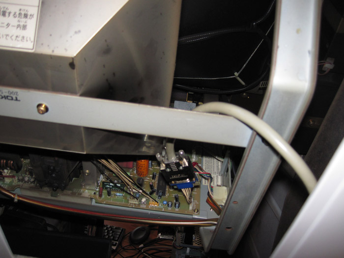

Tried another VGA cable.  Got exact same result.  Now that I'm swapping between going through the JPAC for video and the vga cable, I have noticed that the colors are really muted and dull going through the vga connector.  So it has something to do with the chassis or the connector on the chassis?
Here are a couple of pics.  As you can see, I'm not hurting for space in there:
Here's where the vga cable goes:

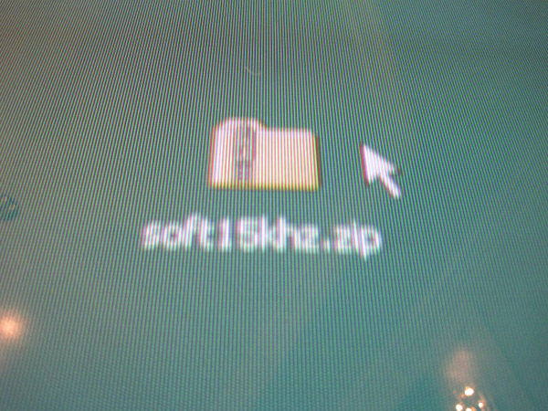

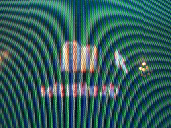

In the beating a dead horse dept:
Two ferrite chokes on the vga cable didn't help a thing.  I tried to show the difference between the jamma video vs the vga video:
Through vga cable.  Sharper graphics, but muted colors and that $$#%#Q@ scrolling band of #$$##:
Through jamma connector.  More vivid colors, but muddy graphics:
clutch

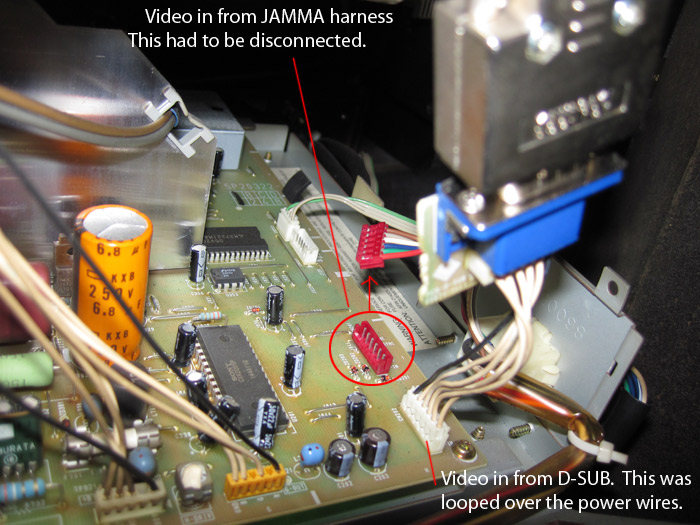

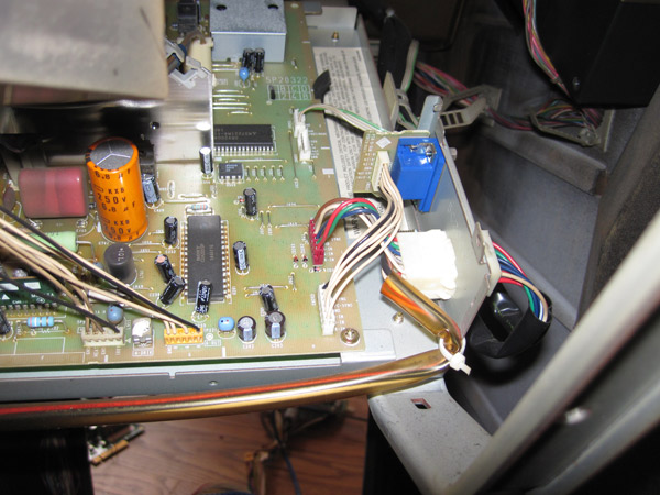

Finally a glimmer of light.
Took off the d-sub connector, looped the cable up over the monitor frame so that the wires are 'free-floating'.  I still got the band of noise.  I then unplugged the connector that connects the jamma harness to the chassis.  Bam!  Monitor looks perfect.  It isn't dark and dull any more either.  The color pops!  I had to keep looking underneath to make sure I wasn't running vid through the JPAC.  I'm still cautious, but this is definitely a step in the right direction.   :woot

Both connectors.....you have 2 sets of video cables connected to the monitor at once? if so, thats bad mojo. That may be your only problem. The darkness would be due to that, and the noise issue as well. Only use 1 video input to the monitor at a time.
clutch
  • Posts: 154
  • Last login:February 06, 2014, 02:26:56 pm
Re: horizontal band problem
« Reply #29 on: March 21, 2011, 11:18:08 am »
Yeah, the video in's are connected, but only one is in use at a time which I'm guessing under normal conditions shouldn't present any problems.
boardjunkie
  • Posts: 698
« Reply #30 on: March 21, 2011, 11:38:24 am »
Its really not good to do this. The other video cable thats still connected even tho the board/pc is not on will load down the one in use. I dunno if any damage can be done, but either way its not a good idea.
Humor me, disconnect the second video input from the monitor and just connect one signal cable to the monitor directly. Tell me what happens....
clutch
  • Posts: 154
« Reply #31 on: March 22, 2011, 12:36:19 am »
That's what I did above and the problem stopped. :)  However, the chassis comes with both inputs plugged into the board.  What I did to fix the problem is not typical.  Everyone else who owns this particular model would be having the same issue if both plugs being connected at the same time was the source of the interference. I think my issue lies elsewhere and unplugging one cable just happened to fix the problem.

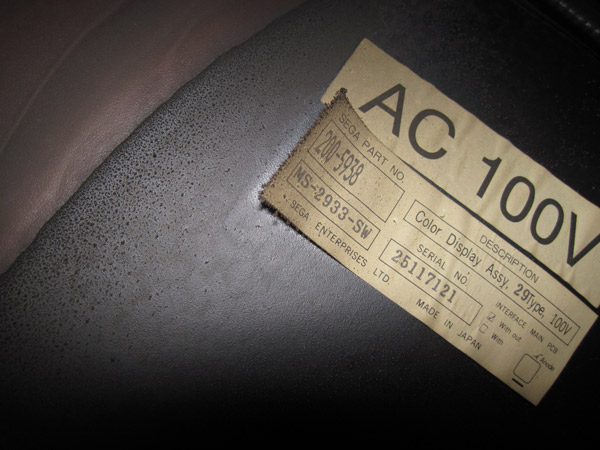

Closest I have online is a 2931 manual:
http://hem.bredband.net/emergencycallambulance/Monitors/MS-2931/MS-2931_Service-manual_full.pdf
Here are the labels on the back of my monitor:
