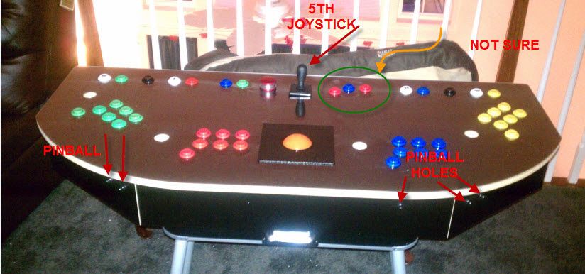

Hi need some help im alittle lost.
I'm useing an I-PAC 4 (56 Inputs)
the standard  Ultimate 4-player control panel with pinball holes.
my questions are:
5 pinball holes and 2 exit buttons , 3 buttons not sure where to put them.
and only 4 inputs left. one on each play.
1) there a 5th joystick not sure where that goes.  ( just a side note whats that joystick for?)
2) I have 5 pinball holes 4 for flippers and one for the ball where should i wire them into?
3) 3 buttons im not sure where to wire up?
4) and 2 exit buttons
so tell if im wrong  the 5th joystick gets wired into player one also.
im guessing pinballs to player 1 buttons 1 - 5
and 2 exit buttons can get wired together on the same input
and that would leave me 3 inputs for the 3 buttons.

5th stick is probably a dedicated 4 way, and yes it'd be wired into player 1 spot. Unless you're playing other emulators, I don't think there are any 4 player games that use more than 4 buttons.

« Reply #2 on: February 19, 2011, 10:36:52 am »
