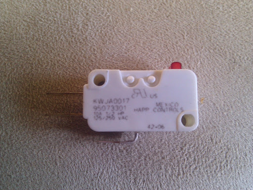

thanks for mention the forces aspect of the buttons.  i bought buttons from two sources on my CP.  and some of them i can touch and they activate, and others i have to like hit real hard to get a register..
so, im gonna have to buy some switches and experiment.    i was thinking, it was because i have two type of buttons.. ones that the switch mounts inside and then the other type that mounts at a right angle.  i thought this was the reason for the difference in switching.  i really dis like having to tap hard on my credit or player 1 button to get a key register.  when i order my spinner next month i guess ill try some new switches and see what happens. :)
chris.
I need to get a set of each to try the ones I have now are a little soft for me, Im trying to find that happy medium. Dont like the obvious click but want some tactile response maybe a stiffer spring in the button vs the switch??

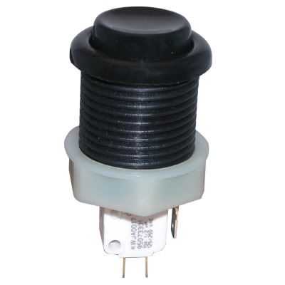

« Reply #25 on: January 28, 2011, 04:24:49 pm »
... ones that the switch mounts inside and then the other type that mounts at a right angle.
The ones with the switch inside, I assume you are talking about these
They're Happ Ultimates and I believe the general concensus on those is not great. I know I'm not a fan of them.
Probably any other button setup will be better.
Paradise arcade shops has 20gram and 50 gram switches.
Groovey Game Gear has 20 gram and they have a switch that you can adjust.
Yep -- anytime I get an Ultimate in a cab it goes straight in the garbage (and I tend to keep boxes of used stuff).

yeah its the happs ultimate buttons indeed.. i have 14 of them..  with said  cherry switches.. so the ebay auction said. ( the rest are happs with the right angle concave buttons ) i did not know any better.  i figured a switch was a switch.  but the more i use my control panel the more i learn. and i understand now  all buttons and sticks are not created equal  this just is not the case.. when i first started ordering parts for my control panel.. i figured a button was a button...  heh.  dork slaps my self.   today is the first day i played games all day on my cab.. and i  see why they offer different buttons, and joysticks now.
after a few hours i know what i want in a stick and how i want the buttons to feel.  just gonna be trial and error to find that happy medium. and then ill be set!

Since this seems to be a big question, I put together a little pack and I'll throw it up on the website soon.
5.50 with shipping(First Class)
1 Happ concave black horizontal microswitch pushbutton and 4 microswitches:
20g Zippy (Switches shown in Project Arcade)
50g Zippy (Switches shown in Project Arcade)
75g Cherry (the standard switch for years and the weight more standard Happ or IL D44X buttons are sold with)
125 gram generic (I would not suggest playing with this, but I have extras so we are throwing it in to give you an idea of what heavy is like)
This way people can, for a low cost, get an idea of what the differences are between different weights and know what weight you are testing.  All the name brand micros are coil spring based, and should be similar if not identical to all the major players on the market who have similar micros.  If anyone wants priority, it would be 8.50 total.
When the Rollies come in we'll figure out a set to include them also... Game on !

Picture of Happ microswitch:
Product specification for Cherry :KWJA, KW=series, J=force 75g, A UL temperature rating
http://www.cherrycorp.com/english/switches/miniature/k.htm
If anyone is confused by this discussion and would like to talk microswitches, please pm me, I'd be happy to talk more about it in pm or email.
I am at a bit of loss for why there is an argument here when I am posting information directly from Happ and Cherry based on the product numbers shown above on the Happ buttons.
Since I really can't elaborate this point anymore, I will stop here.  If you need me, I'll be playing some Joust :) or maybe I'll have some fun with the Vectrex :)
I have a number of the pictured switches here.  They are HAPP branded switches, so you shouldn't expect the specs associated with the Cherry model numbers to reign supreme.  After the initial letters, there is only a number, rather than the typical letters of a complete part number.  That number is likely an internal specification for an OEM customer.  There's no way to be sure what that internal specification indicates.
When tested on my lab scale, these actuate at right around 38g, which is a far cry from 75g.  This is why it's important to actually do the legwork to verify some of these supposed specs before passing them on to others who don't have the ability to do so.
The 50g E-Switch people have complained about replacing them is louder, a fair bit harder to actuate and by no surprise, actuates very close to 50g.
