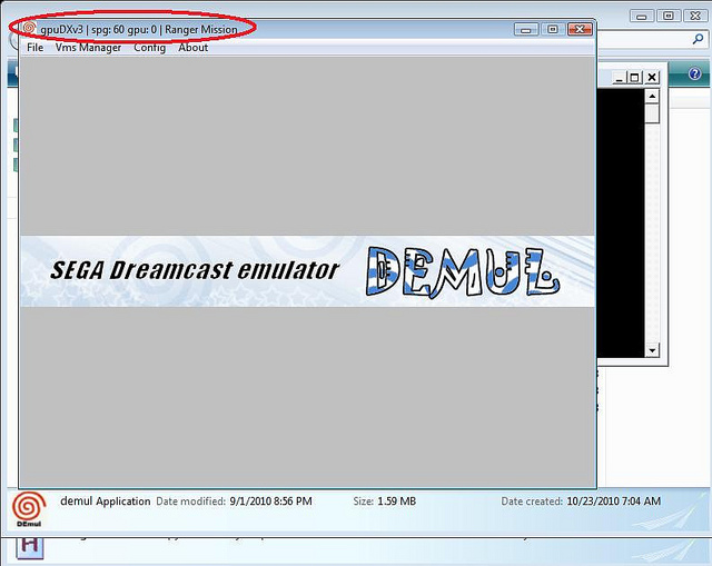

The messed up part here is that the active window title changes as the game launches, spg & gpu change.
The script needs to be tweaked to include a spg # that the emulator hangs at for a second, so the script recognizes the window, activates it, then presses ALT+ENTER to launch fullscreen.  The full version of the script puts up a black window while the emulator launches, so you don't see any of these windows.

You need to tweak the number in red here: gpuDXv3 | spg: 61 gpu: 0 | Ranger Mission in all four places to a number that works on your computer.
60 & 61 worked for most games on my test pc, but I had to change it on my mame pc.  It will vary depending on the performance of your computer.
Run the script and watch for a number that the emulator sits at for a second or two, then try that one.  This seems to be the right time to go fullscreen.
I've gotten errors trying to do it too soon or after the game has fully launched.
If the game doesn't go fullscreen, the script isn't recognizing the window.  Try a different number.  PRESS ESC to exit the script and try a different value.
