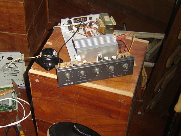

The amplifier. 50w RMS, more than i need.

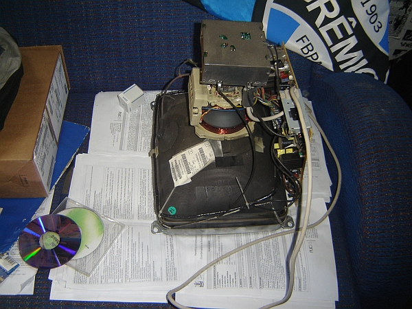

The naked CRT monitor.

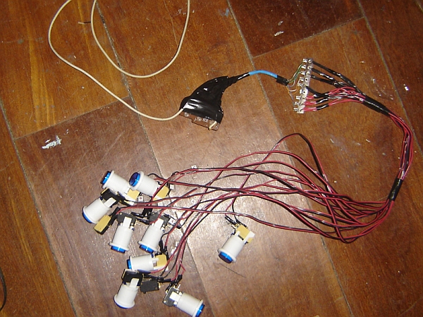

This is a hacked keyborard, for buttons interface.

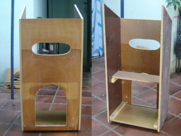

The cabinet. I really want do some vintage style, but our marcenary skills is limited, so we try to make things as simple as possible.

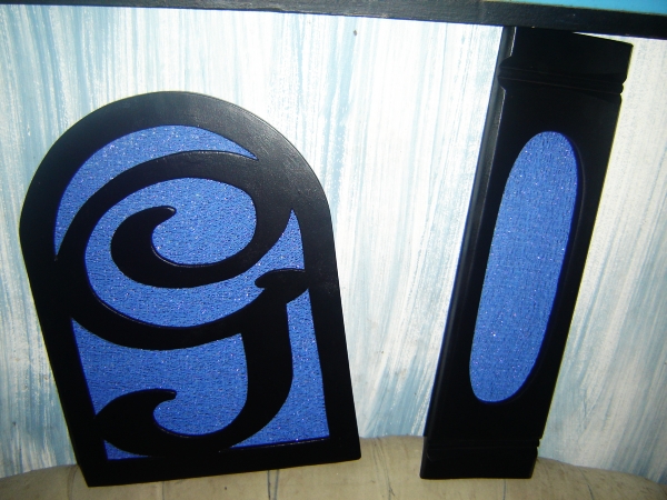

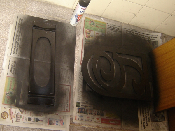

Painting the front grills.
Grills done.

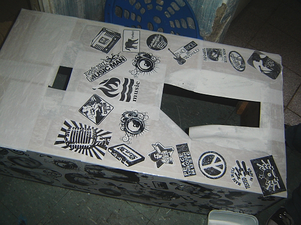

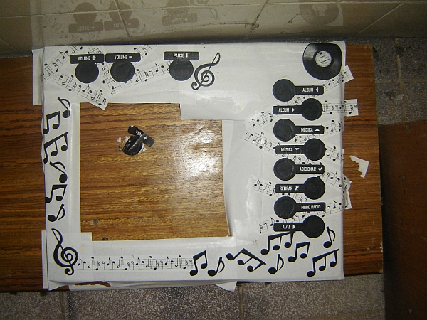

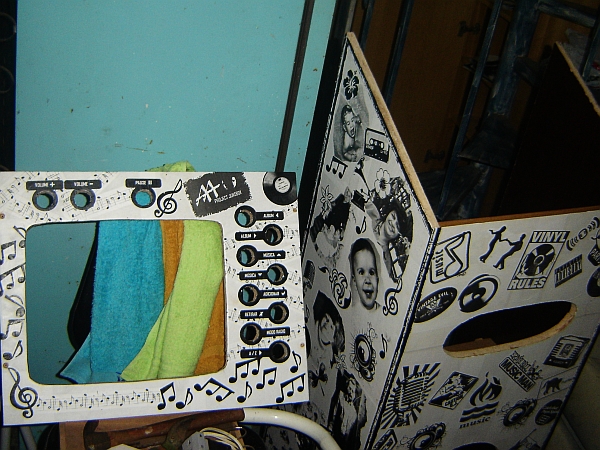

Instead of paint, we decided to do a collage work, with old pictures and stickers.
The top.
Collage ready, just waiting for the the veneer.

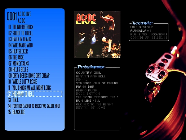

For the front-end, after do some research, i choose the DWJukebox. It's a great program, easy to configure, and do all that is needed for this project.
The main screen. Really, grafic design is not my best skill.

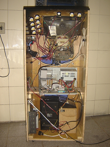

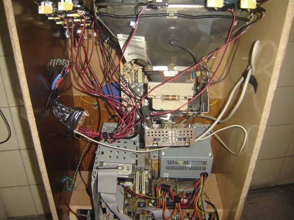

Putting all together.
All wired up for testing. Later, we reorganized everything right, but sadly we forgot to take pictures before closing.
The relay is a simple but smart idea of my friend Leonardo, that also provides me a lots of technical support. He's a nerd... Thanks, buddy!

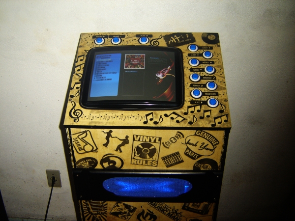

And the jukebox is done! I put some blue leds behind the front grills, the effect is cool in dark ambients.

That skin is designed by me. There are some skins for download, but none of then are exactly what i'm looking for. The DWJukebox are full skinable, for singles based juke or album based, like mine. You can do real amazing skins, but sometimes is a litle tricky to do what you want.
The biggest problem i found when i make that skin is the place for the cover album art, the skin make some table with the songs list and the cover, and if you want a big song list like mine, the cover goes proportional, like this:
The way i found to go over this is creating a cover image with a crop of the bakground, and paste the real album art over there, for each album.
Its easy to do, but take some time. I don't know if i miss something on the program, perhaps there a way a lot easier to do this...
