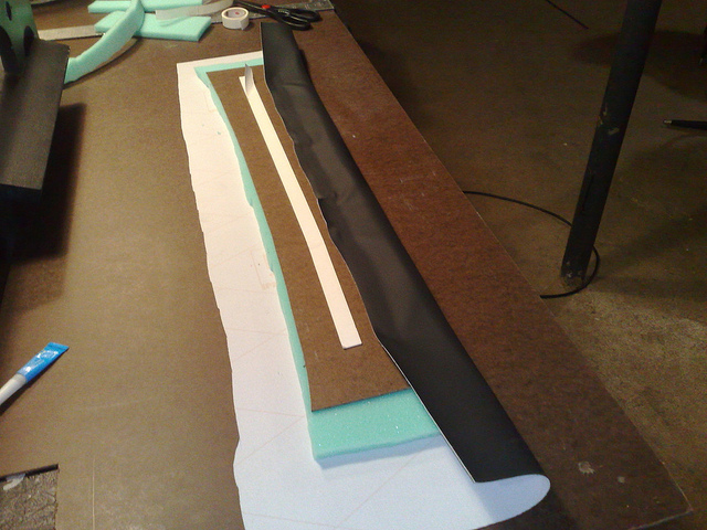

I decided to go with a padded dash, in part to add thickness since I was only using 1/8" hardboard (for it's flexibility).
I didn't have a real plan when I started; just cut out the pieces, sprayed them with 3M super 77 and stacked them.
I wrapped the foam around just far enough to get a nice round shape on the front lip of the dash.
While looking for some type of glue in my toolbox, I came across some double sided tape.
Didn't have much faith in it, but tried a piece and it bonded well, even with the vinyl stretched tight, it didn't give.
The vinyl was pretty stretchy, so to attach it to the main dash, I just stretched the excess down the sides and tacked it.
It might not have been the most professional way to do it, but it was easy and came out looking the way I expected it to.

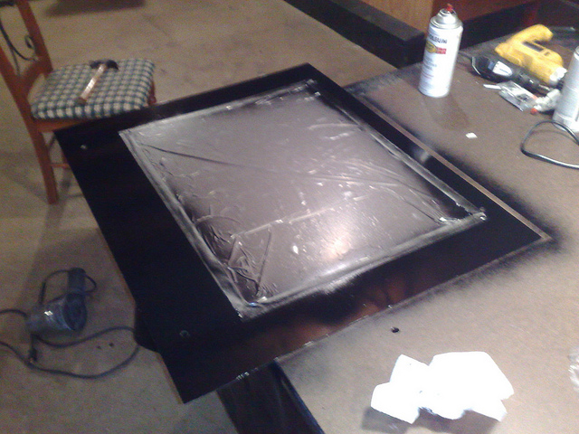

I wanted to get the plexi ordered today and went back through the forums to see what I should buy.
Some wish they'd gone tinted, others wished they hadn't.  I wasn't sure what to get.  I looked at the Lowes and
Home Depot sites to see what they had in stock locally.  Home Depot had something called Optix, but only in clear.
The website for Optix had great information on how to cut, drill, etc. http://www.plaskolite.com/products/flat_sheet/optix/
(click fabrication)  So I went with that, figuring that I could use automotive tint on it if I wasn't happy with clear.
The Optix guide said that you could score it two or three times and then break it off like glass.
I tried this using an acrylic scoring tool that I bought at home depot.  It did not work as advertised.  It removed very little material on each pass.
I scored it ten times and still didn't get a clean break.  Luckily, it didn't break toward the inside.
I rescored the spots that didn't break right, clamped the edge between two boards and took a hammer to it.
Probably not the right tool, but it worked.  I still had some points sticking out that I had to take the sander to.
The stuff sanded really well.  It drilled easily too (used a ceramic/glass bit & widened the holes with a grinding stone on a dremel).
If I had to do over again, I'd use a saw/router/dremel instead of scoring it.  I'd definitely buy the Optix brand again.

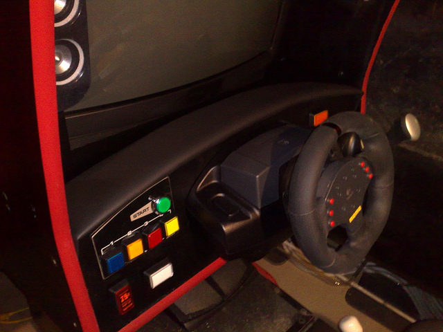

Got a couple things done this evening...button labels & shifter knob.
The labels made it look a bit less generic.
I think I need to add some more style, but still don't want to give it a name.
I'll probably lay down some yellow flames over the red when all is said and done.

Wiring:
I didn't pay attention to which way the bulbs & switches would be turned when I installed the buttons.
I had to redo them and since they had directional arrows on the front, I had to take them apart and turn them 90 degrees.
Other than that, everything went smooth and it took hardly any time at all to wire everything.
To save time & effort, I had ordered a KeyWiz.  I felt like a lot was going to waste only hooking 8 buttons up to it, but when deciding what keys to assign buttons to, I realized something:  If I used the arrow keys, ESC & Enter, maybe I'd be able to navigate pc game menus without breaking out the keyboard and mouse.  It worked like a charm.  I tried Need For Speed Underground & Grid.  Everything was able to be done from the buttons on the CP.  The only oddball thing I came across was that NFS required you to press Q to quit, so I just assigned the radio button to Q.
Buttons Lit:
The buttons look ok with my paper labels inside.  Inkjet transparencies would probably look better.  Applying Vinyl stickers to the diffusers would probably yield the best results if you only needed simple shapes or words.
That's probably all I'm going to do for a while.  It will sit until I get some kind of inspiration for more cosmetic touches.
I may try to heat and bend a piece of plexi to make a new marquee.  It's something I've always wanted to learn, but have never tried.
Some more pics (they are a bit washed out because there was a bright light above me.  You couldn't see any detail in the cab with the light turned off though):
EDIT: The seat and top actually do have all the bolts in them now, lol.
« Last Edit: June 02, 2011, 03:47:26 pm by BadMouth »

I had a million other obligations today (half of them still unfulfilled), but the welding shop calls and says the bracket is ready and that it will cost twice what I expected  :timebomb:
I pick it up and they did a much better job than they needed to, so I get over the sticker shock and move on.
I get it home and try to put the plastic dash on the front of it and it doesn't line up.  The steering shaft is a half inch off to the side.  :angry:
So I start measuring (which I guess I should have done before).
THE FRIGGIN' OUTRUN 2 DASH HAS THE STEERING WHEEL A HALF INCH OFF CENTER!!!!!!!  :banghead:
The Daytona bracket has it centered.
I assumed arcade machine companies were cheap and just kept using old parts without changing them (except to make them cheaper).
I can't believe I didn't notice it before.
Not sure what I'm going to do now and don't have time to think about it until Monday.  :cry:
I guess it's either hack up their work and make some brackets to move it over a half inch (in which case it will bother me enough that I'll want to move the monitor, seat, etc over a half inch to keep the wheel centered), or hack up the dash.  :'(
I'm out.  Just wanted to ---smurfette---.  I have obligations all weekend long and can't mess with it now.  :cry:
EDIT:Couldn't sleep, so I grabbed a hacksaw and a dremel and FIXT it (removed the plastic cone from the center...or off center in this case).
Those are smudges in the pic, actually managed to do it without gouging or scratching anything.
It still needs some cleaning up, but now I'm locked into a direction and can move forward.
Guess I'll have to make a bigger steering column.
