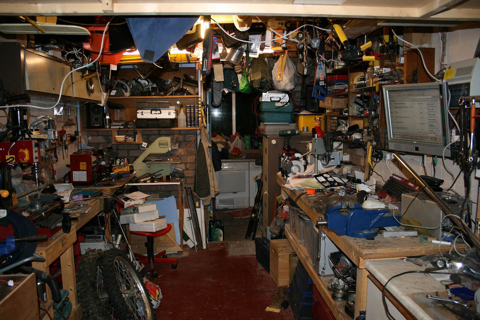

The plan has moved to 'Phase 2' now.  Behold the behemoth that has begun construction in the last night or two in my nerve centre (garage):
Hopefully this one is going to look ok once it's done, but it'll require a lot more effort to look half decent since it's allowed in the living room/den.

Your garage looks like mine (the set from Steptoe & Son) hence the reason the photo's of my cab are always on the lawn  :D )
Making progress on Phase 2. Very cool.
I see from the top right hand side of your photo a UK 3 pin plug. What part of the UK are you based? There's quite a few of UK based cab builders on here  :)
The other clue was that he paid for stuff in POUNDS in his original post  ;)
Nice work Cretser, and nice garbage err, garage  :D

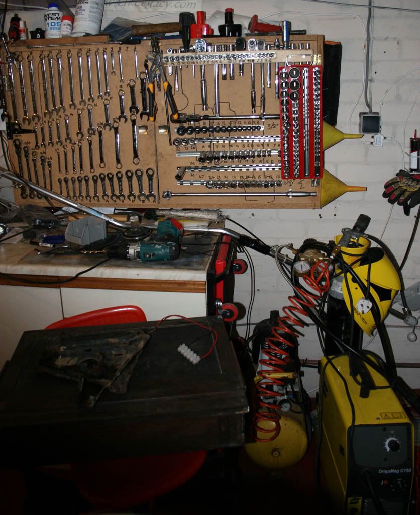

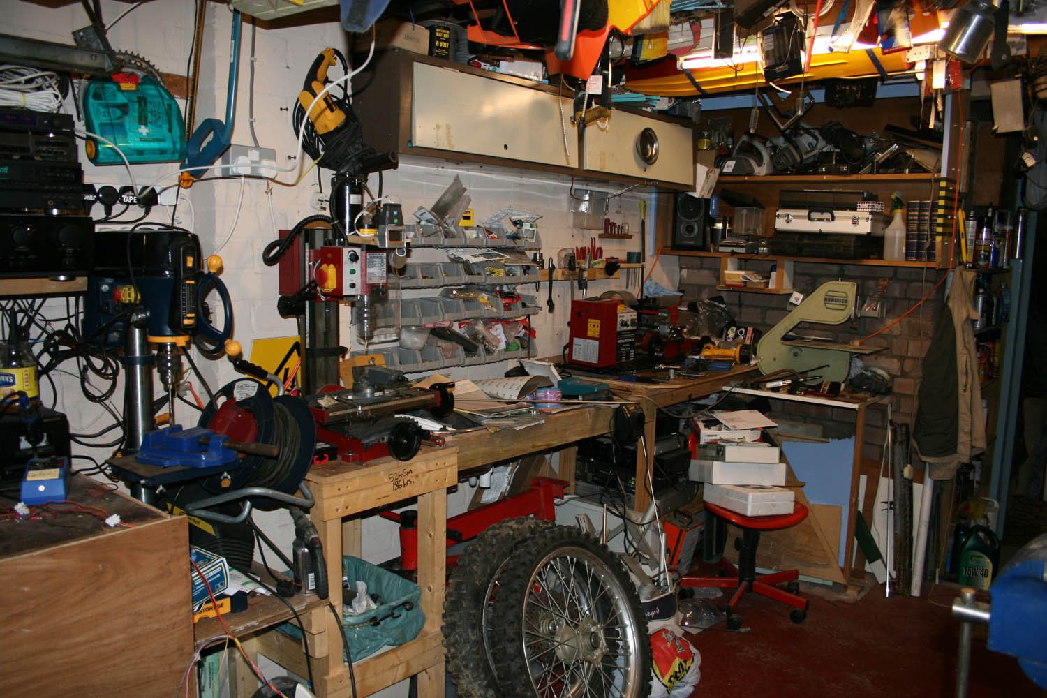

Ha ha!  Yeah - am in the UK, more specifically the Isle of Man (which getting technical isn't actually part of the UK but to all intents and purposes....).
Here's what my garage more usually looks like just to defend myself.  Only a single sadly and I've filled it with machines & workbenches, so more a workshop than a garage since there's no way of fitting a car in now!
My little Snap On collection!  :-*
And the rest of the stuff - mill/lathe/bench drill etc etc
Now that's a shed worthy of a man  :)
Snap on make freaking great screw drivers!
