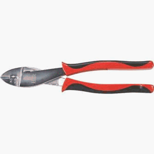

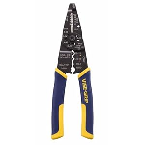

Get a good set of crimping pliers it really makes a difference I started with some cheap-o crimpers and they would bend and darn handles hurt.
I got some of these here
http://www.amazon.com/GB-Electrical-563250-Crimping-Pliers/dp/B001AH7ID4/ref=sr_1_4?ie=UTF8&s=hi&qid=1280870895&sr=8-4
and one of these style for the stripping
I know you can crimp with the bottom one also but I don't like having the crimp part in the center its easier at the tip.
