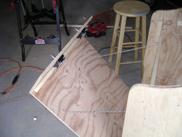

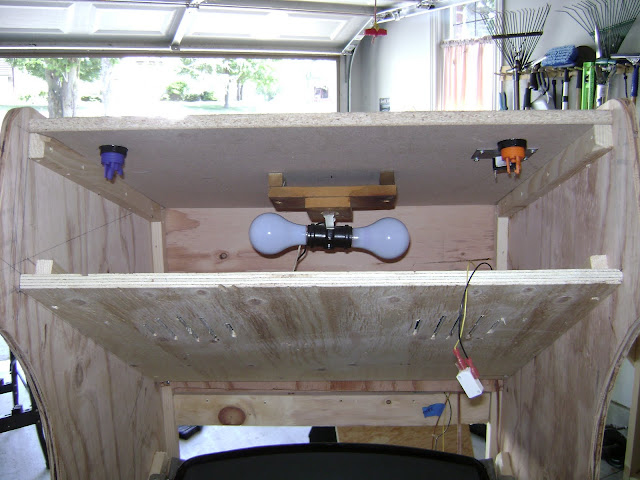

I have been a slacker about the updates. All my free time has been spent working on the cab.
Here are some photo updates. Most all are self explanatory. I have since disassembled the guts of the cab and am still trying to come up with a solution for mounting the smoked plexi (See last photo). What I really want is to have the plexi flush with the CP. If I use the solution in the last photo then there would be a 1" piece of wood butted up against the CP and it would make taking the monitor out even harder. Not that this would look bad, i just think it would look better with the plexy flush on the CP. There will be an artwork bezel adhered to the top of the smoke plexy which would hide any screws, allowing me to mount it to a wood frame and then mount the wood frame to the cab, making it removable for easy access to the monitor.
note: There are clamps holding the CP/front door secure. They are just not in any of the photos.
Above image: monitor was a complete pain in the ass to get in but for the most part slid into place.

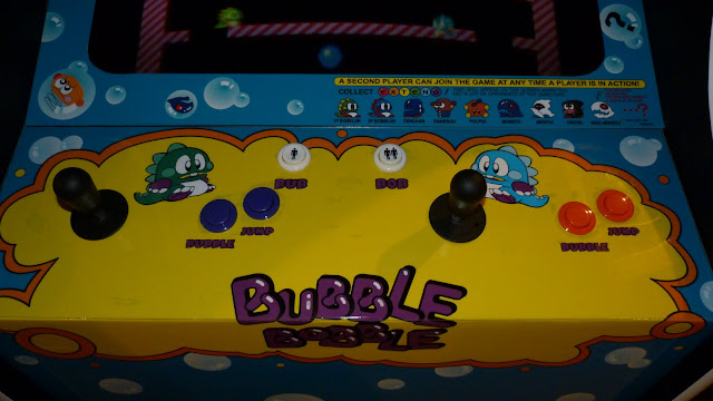

 Install the t-molding
 Apply control panel/front artwork
 Install hardware
 Play!

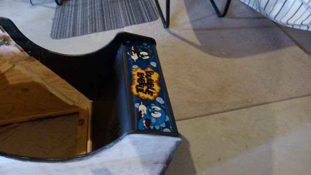

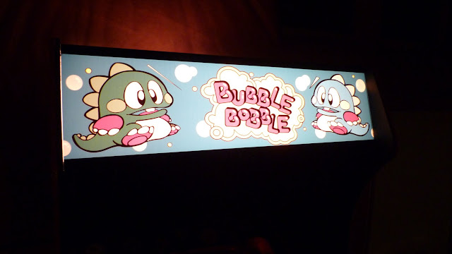

Testing out the marquee:
Bezel applied to the smoked plexi with the center carefully cutout:
Side art applied and trimmed. I am very happy with the results:
Had to test out the marquee with the light on :)  (There is small slit on the left side of light getting through. I will have to come up with a way to fix that).

I was thinking that as well. I don't want to melt the vinyl of the marquee. I have a fan in the top exhausting the warm air, which is thermally controlled. I will play it by ear though. If the fan is on a lot then I will put in LED's. The lamps came with the cab I gutted for the wiring harness and monitor, made things easy. Plus I do like the warm glow from the incandescent bulbs.

I'm actually in love of that graphic, and in this time i'm working on a cabiet for my jamma collection...
Where can I find that graphic? it's absolutely amazing!

Thanks guys. I get hit up for the files a few times a year. I am going to post them somewhere public and provide a link here tonight.

URL to download art files in various formats. It has been a while, but I think this is all anyone would need to get the art printed.
https://drive.google.com/open?id=1NX6GuzlBJry1i7MdSVATMp05oZcLBhU7
