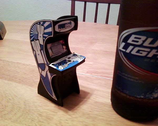

I made this from some 1/16" birch ply.  I cut it out with a laser cutter we have at work. It took less then an hr to cut it out and glue it together.  Worked well I thought.
