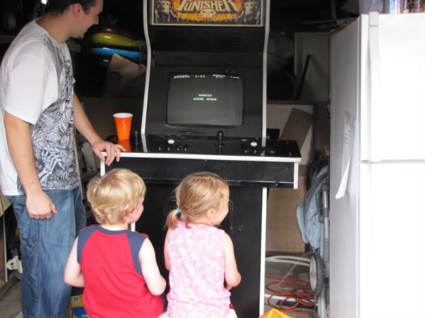

95% done here, just some minor tweaks....and to fix the control panel. Wanted to share it though:
What it's all about:
Almost there!
