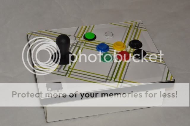

Hey guys,
im a long time Home arcade builder, ive found tons of useful information on this site and am always grateful for this community. Ive recently started trying to push forward with a Xbox 360 Arcade Box project. ive built a few already but lack the funds to continue on with it, its taken alot of work but these things are sweet. i wanted to post here and try to show it off, im not to great at advertising whatsoever, if you have comments, questions, or advice please let me know! id love to make more of these and sell them, thanks for your time!
The link is below. im not sure about pricing either as it really does take alot of time and hour of work to build one! but im not sure what the people will pay! Maybe its not worth the time building?
http://www.etsy.com/listing/47276576/mbox-xbox-360-arcade-box
Also let me know if anyone is interested in having one built.... thanks again  ;)

ok. Just some honest constructive criticism. If you really do want to sell these, they would have to be drastically improved to be considered by anyone remotely interested in the arcade community. I'm gonna sound harsh, but this is the reality. If i pay for something, i want it to be perfect.
- I can see where you have cut the plexi, the edges are rough, theres also a scratch near the buttons,
- The plexi does not go right to the edge, and the tmolding is not offset to secure it in
- The corners that the tmolding wrap around are too sharp, tmolding should follow a smooth curve
- The joystick looks like its mounted too low
- Button layout is meh, offset/rounded layout is much more comfortable (http://slagcoin.com/joystick/layout.html)
- Doesnt a standard xbox 360 joystick require 8 face buttons?
- The buttons arnt labeled, (X B X Y start select etc)
- The graphic looks like a tablecloth from my grandma's house - its soo easy to find awesome graphics (street fighter etc) on the net.
- The box itself, looks like the scrap white laminate cabinet doors i have in my garage.  The bottom left corner looks damaged and untidy
- The official mad catz Super Street Fighter IV FightStick Tournament Edition cost $150. All Sanwa parts. licensed by capcom. Case Closed.
Most of these issues could be easily fixed with a redesign, but the price is still not right. Even the regular edition of the madcatz fightstick is only $66....

You'd have to improve your build quality alot to be able to sell these.  Even first time builders here know to flush trim the plexi, and offset the tmolding to match it up.  A good first try, but maybe you're next try will be better.

Man you guys are to awesome, im glad i finally posted here so i can get all these great comments to help me progress. Im also curious, do you think making custom graphics is just a waste of time? is all anyone wants is a picture of Ryu?!  I would love to make it original with some homemade graphics but maybe the community doesnt want it?  Also in your opinions would you rather have a wood built box or a Plastic built?  i like the wood as it feels more solid and heavy for some good button mashing.  Also what is the best way to file down the edges of the plexiglass? This is a great opportunity to get all the likes, dislikes, and ideas to make the perfect 360 Arcade box.  thanks guys!  :applaud:
here is a pic of the box, i took if off etsy while i revamp my work
« Last Edit: June 04, 2010, 07:08:18 pm by rxmarccall »

rxmarccal, if you are good at drawing then making your own unique design would be awesome. Being a big street fighter fan, i personally love the look of sticks with any street fighter art on them, but everyone's opinion is different. I just think it would look better if the art was more game themed.
The control panel i'm building atm uses some images from http://www.creativeuncut.com/game-art-galleries.html. Its an awesome place to source game themed art if your not good at drawing like myself. Also most of the images are quite high res so would look good on a small stick like yours.
With regard to the plexi, i'm having the same problem with my control panel, some of the edges are a little rough. I think the trick is to cut it right the first time. I used a dremel to cut mine, but most people seem to be getting the cleanest cuts with a router and a flush trim bit. I dont own a router so i dont know for sure, maybe someone else can recommend the best solution for this.
In terms of the building material, stick with wood. Good luck with the next build!

Yes to get clean plexiglass cuts you absolutely need a router and a flush trim bit.  It's easy, fast and you get a perfect edge.
