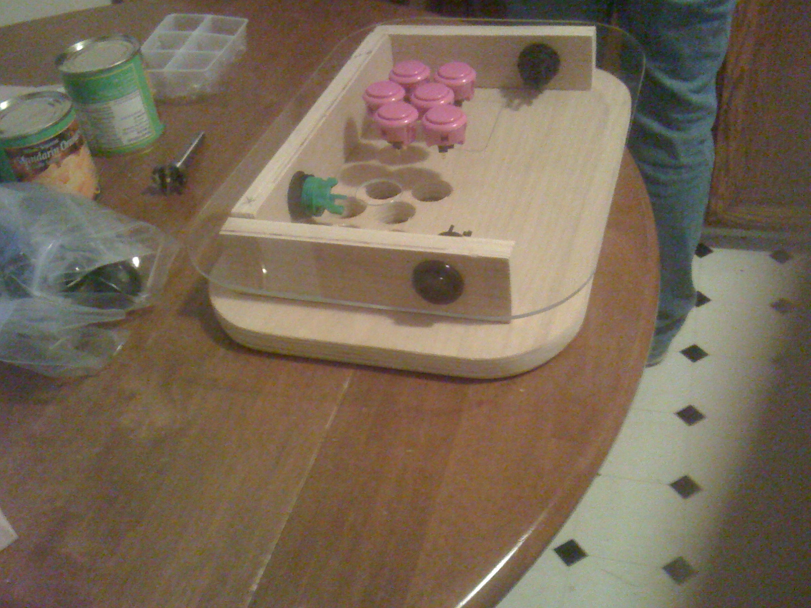

I've used Happ buttons in a couple of arcade sticks I've made already. Mounted in 3/4" board with 1/8" plexi as well. They fit just fine. You shouldn't need any modification at all.
http://2.bp.blogspot.com/_6EMt9kWBw7A/S7bYAZywo2I/AAAAAAAAAGU/2Vwp2uhHOlM/s1600/IMG_0353.JPG
The buttons on the sides are Happ in 3/4" wood.
