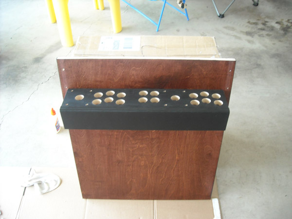

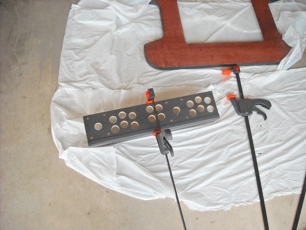

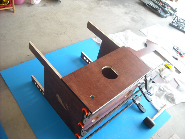

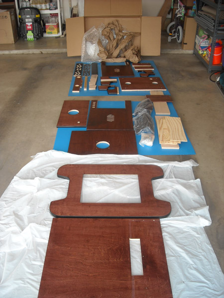

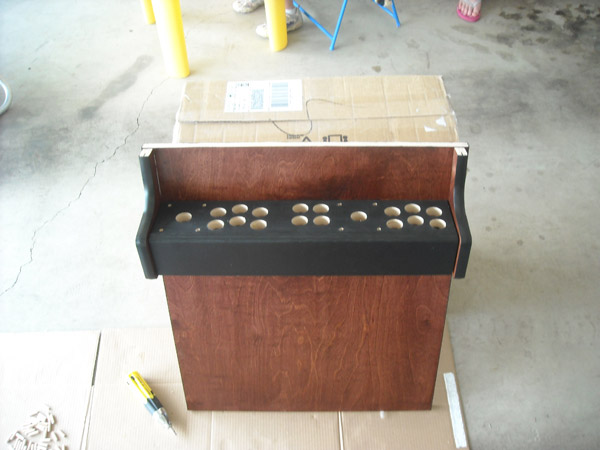

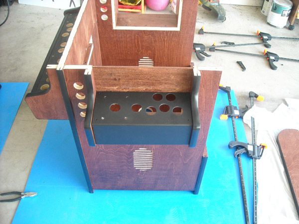

Progress Pics, or "What I Did Over Memorial Day"

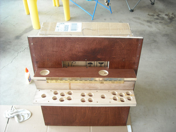

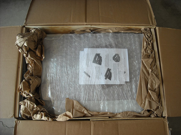

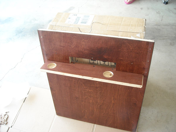

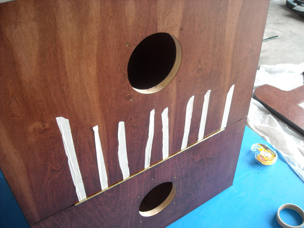

« Reply #4 on: June 01, 2010, 02:28:52 pm »
You can tell just from the packing job that the Arcade Depot guys have been at this for a while. I was actually quite surprised at how small the package I received was. Everything was very securely wrapped and well-protected.
First thought: All that came out of there?
Second thought: What have I gotten myself into?
My Pilot, looking a little pissed that I've taken over its spot in the garage to work on this project. Also notice that I really should be mowing the yard instead of building an arcade cabinet.

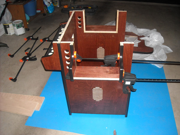

First step, glue up and screw up the bottom of the third control panel:
The third CP itself is in two parts that attach with dowels and glue. Word to the wise: don't buy those "set of 6 new" ratchet clamps that pop up all over ebay when you search for ratchet clamps. You get what you pay for.
Third CP on:
Via piano hinge:

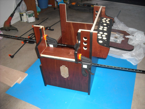

Third CP side panels. Note that I strayed from Arcade Depot's directions here, as their directions said to glue on the side panels before installing the piano hinge. But then when you got to the step of installing the piano hinge, the directions said to adjust the side panels for proper clearance (which would have already been glued in place at that point had I followed the directions step-by-step).
Gluing the P1/P2 sides (front and back? ends? I'm not sure what to call them in this case) to the bottom panel:
Attaching the rear bottom panel:

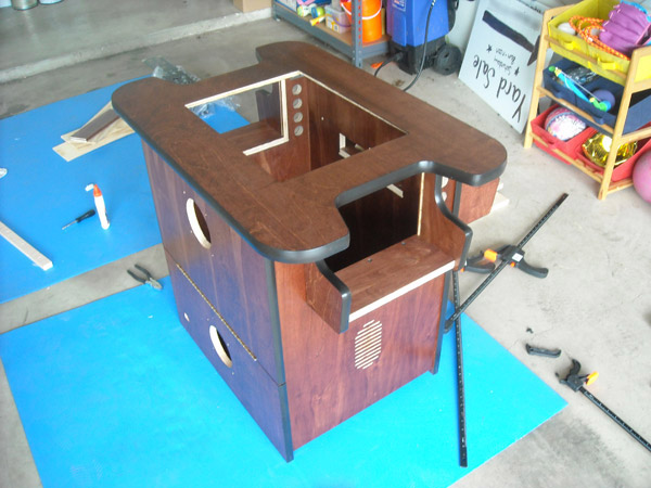

Attaching the front panel w/ third CP installed:

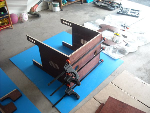

Attaching the P2 control panel housing:
Attaching the P1 control panel housing. Notice the growing pile of broken ratchet clamps in the background. These things should have come with a warning sticker: "WARNING: this item is for decorative purposes only. Any attempt to actually tighten the clamp onto wood will result in the cheap plastic housing flying apart and the trigger falling off."

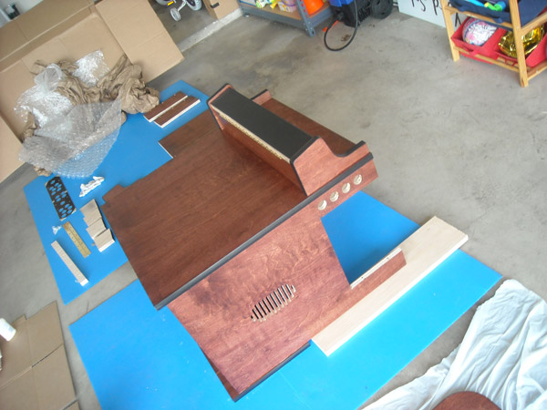

A test fit to see what the finished P1/P2 control panels will look like. I don't want to mount these just yet since I don't have my controls yet.

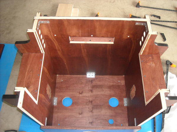

Installed corner brackets for added support:

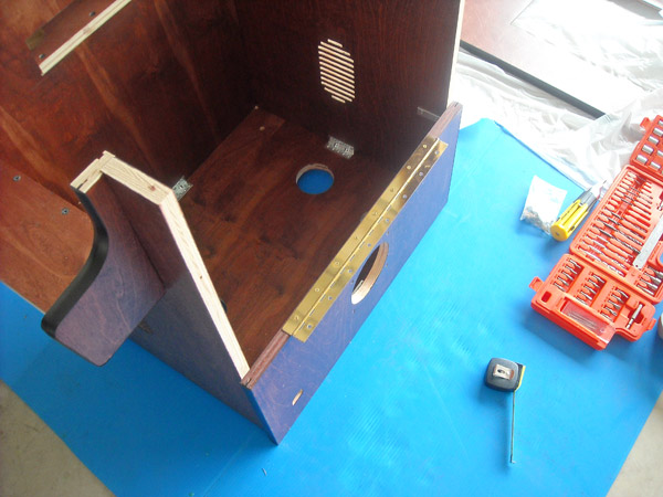

Piano hinge for the rear panel:

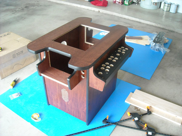

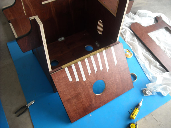

And now for the biggest pain of the assembly: attaching the hinged portion of the back panel to the piano hinge. It was a ---smurfette--- figuring out how to get it lined up just right. What I did was fed masking tape through the slots in the piano hinge, then closed the hinge and set the panel into place in the closed position, then tightened up the tape. This allowed me to open it with the tape holding it just enough that I could then install the screws.
And finally, a preview of the finished product. The top is just resting in place in these pics - I don't want to actually attach it until I figure out how I'm going to secure the monitor to it. Arcade Depot custom-routed it for my LCD monitor (an HP LP2065), so now I just need to figure out how to hold it in place.
And that's where it stands for now. (Well, actually it stands in the back corner for now - had to get my truck back in the garage before it disowned me, after all.)

Wow, my progress really slowed to a halt after that first post, huh? I need another holiday weekend! I did finally get the top panel on.
Attaching the piece that Arcade Depot provided to connect the rear hinged panel to the top panel. I used glue here in addition to the provided screws.
Just a little extra room to add some extra reinforcement:
Attached each of my monitor spacers with glue and three big wood screws.
A preview of what the monitor will look like when mounted. Don't worry, it's still got a sheet of plastic on it for protection - it doesn't really look all hazy like that.  :)
Flipped it over, lined it up, and pre-drilled the screw holes to attach the monitor mount to the spacers.
Lined up the top panel just right, clamped it down, and screwed it in place.
Used that little bit of extra space to add some small shelf brackets for some extra support when opening it up.
Don't think I'm gonna stick the monitor in there just yet - I have a feeling that gaping hole in the top may come in handy for some of the things I have yet to do.  :)

Slow and not-so-steady progress here, but I'm getting there in spurts... Received my order from Groovy Game Gear this week, so I couldn't resist playing with my shiny new toys!
Attached the supports for the vertical CPs - I think this was my final bit of gluing left to be done! (With the exception of some hot glue here and there, I'm sure.)
Started filling all those holes with my new buttons and spinners from GGG, then applied my vinyl labels from Pongo to the coin, player, and admin buttons.
Hmm, something's conspicuously missing from those pics... Gonna have to send some funds divemaster's way and see if we can't remedy that.  :)
I got micro-leaf switches for all the action buttons, and the standard "soft touch" switches for the coin, player, and admin buttons. I must say, the standard switches that GGG offers live up to their name - I really don't notice that much of a difference in feel between those and the micro-leafs. The micro-leafs are noticeably quieter, though.

Okay, I'm scratching my head a bit here, so I've come to beg for ideas.
I added some heavy duty magnetic catches to hold the top panel in the closed position:
Now I'd like to do something similar for the third control panel... A non-permanent solution to hold it in the closed position, just enough to keep it from opening during play or when a cat jumps on it. :angry:  The problem is that space on that panel is very limited, and my controls take up almost the entire panel. I've basically got this one small area where I could squeeze something in:
But problem 2 is that that spot lands in the area where the front panel is cut out to allow cables to feed through:
So I'd probably have to add some wood back in there in order to use any type of latch or catch. I considered using velcro, but when the panel is folded up the back edge of it rests flush against the front of the cab, and adding velcro there would cause a gap. Not sure if it would be enough of one to worry about, though.
So... Ideas, suggestions? Please?  ;D
