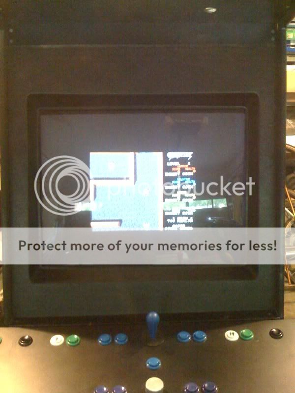

ok there is the difference. Yes of course there is space along the vertical sides. But I have quite a bit of space above and below the game as well. I'd say the donkey kong gamescreen fills about 60% of the vertical space, with 20% of space above/below the game. I can fix that by turning on hardware stretching, but then it loses clarity. I'll see if I can get a screenshot posted tonight.

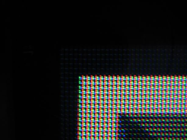

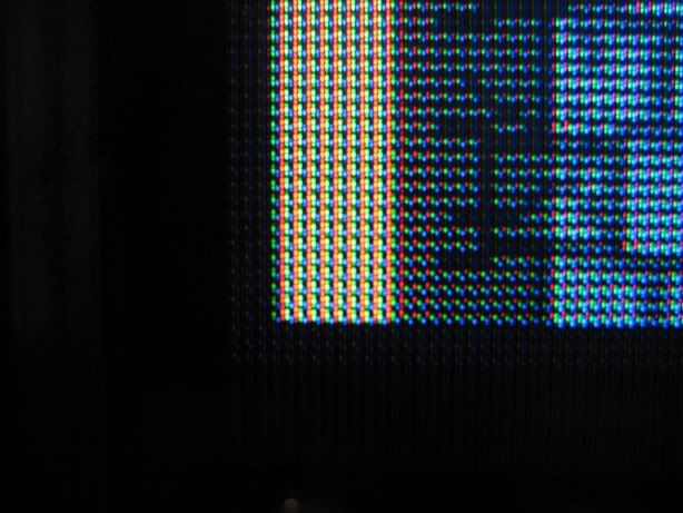

I am running it at the native 336x240:
You can see there is a tiny bit of border but not much:
Top Left:
Bottom left:
Yours should look like this...if not just use your monitors controls to adjust it a bit (center/expand/move left/right etc).

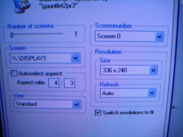

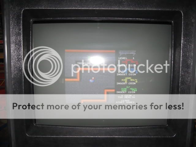

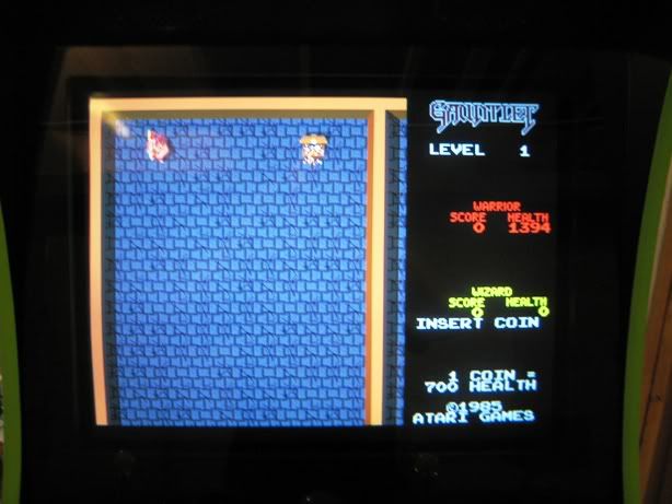

It's not my monitor controls. My borders are way too big, and the monitor controls only change it a little bit. I'll post screenshots in a few.
mohrt
  • Posts: 72
  • Last login:June 03, 2011, 02:32:42 pm
  • mmm... mame.
Re: ArcadeVGA: to stretch or not to stretch
« Reply #16 on: May 24, 2010, 08:37:29 pm »
Here is my gauntlet screen (sorry about the glare):
You can see how the game only uses the inner portion of the available display. I am using the very latest mame.exe (0.138)
Here is my gauntlet.ini (from avres):
Code: [Select]
## gauntlet ##
screen0 \\.\DISPLAY1
switchres 1
hwstretch 0
bezel 0
backdrop 0
resolution 336x240
resolution0 336x240@0
And my full mame.ini file:

« Reply #17 on: May 24, 2010, 08:45:15 pm »
I just found an error, my "switchres" setting is 0 and should be 1. I changed that, and now when I try to launch any game I get:

It picks up the dkong.ini for sure, but it is still small on the screen:
I'm just using the mame.exe that comes from the 0.138 download. I'll see if I can try MameUI next.

OK I setup mameui32 with the new rom dir and it rescanned. then I set the directdraw, no hardware stretch and switch resolutions settings. And... mameui32 has the exact same problems, showing the games small in the middle of the screen. I'll try the re-audit just in case.
Epyx
  • Posts: 1961
  • "You're an oddity"
« Reply #25 on: May 25, 2010, 01:16:26 am »
Post a screenshot of the mameui settings for gauntlet.

« Reply #26 on: May 25, 2010, 09:01:39 pm »
Ok here is a screenshot of the mameui32 settings, and a shot of the game:
