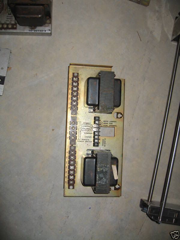

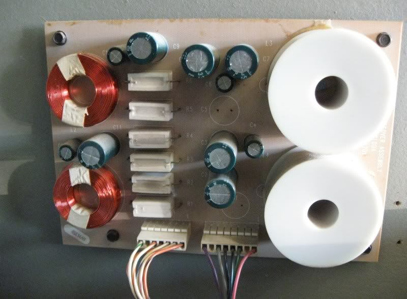

Thanks for your reply. What I am asking is if I can use a CD100a crossover in a CD100b jukebox.
The CD100b crossover looks like this:
The CD100a crossover looks like this:

Your first picture is of a crossover circuit board.
Your second picture is of the output transformer assembly and is not a crossover.

Ken is correct that is why I asked the question I thought you were confused re the discriptions.
The Output Package is connected to the amplifier and the cross over is connected to output package by harness A11, the speakers are wired to this cross over via harness A12 and A13.
I suggest you source new harnesses or repair the ones in your jukebox.

Ahh, I see. The Output Package in the above picture was mislabeled on E-bay as a crossover for a CD100a, hence my confusion. This is my fathers jukebox, I'm trying to help him get it working.
