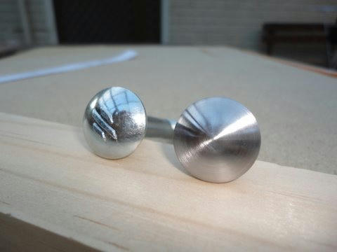

After reading all the 'don't do this at home' warnings on the web about removing the tv case, I chickened out and didn't remove it. So that pretty much set the size of my cab, 600mm wide by around 720mm deep, enough to fit the TV case perfectly & squeeze 2 player controls in as well.

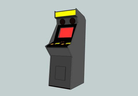

I started of by drawing out what I wanted, then I designed it in Google Sketchup. The great thing about this was that I modelled the TV first, then designed the Cab around the TV size, = perfect fitting TV. (I hope). (FYI a Cabinet is a great project to learn Sketchup on, not so simple that you get bored, not so hard that you give up straight away)
This is what I ended up with:
I didn't want a control panel that sits forward of the cabinet & extends past the sides like most do. I like how it is all contained. If once I build it I find it too small to fit 2 people comfortably on, then I can make a separate CP which is bigger, 4 wing bolts will keep the CP attached to the cab so it's an easy changeover.
And as for the angle at the back, I just love it. It makes the Cab seem bigger and more imposing to me, just like when I was a little kid walking up to StreetFighter for the first time...

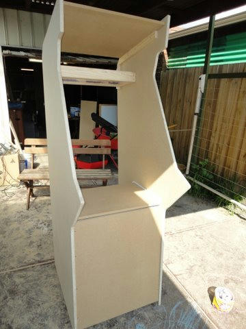

Day 1
So I figured out the dimensions & angles, and got to work cutting out the sides.
I wanted to use 18mm MDF but the guys at Bunnings won't cut it to fit in the car because of the chemicals in it, so I had to settle on 18mm Particle Board.
After 2-3 hours of cutting and sanding, I had 2 sides with the exact same flaws in them. That's good enough for me.
Day 2

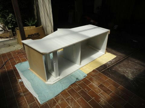

I made the base from MDF & pine. I put 4 castors on it, the back ones rotate 360 for steering.
Then I mounted the base to one panel, and a frame for the top half, and stuck the other panel on the top of it all.
I could have made this step a LOT easier by properly marking the side panels first so I could align them easily, but dumbass here didn't think of that beforehand.
But, I eventually got there, and was able to stand the Cab upright for the first time.
Of course, I also dropped it cos it weighs a tonne so I damaged the left hand bottom corner. Awesome. Luckily I can curve off the front corners and it will look like it was designed that way, but I'll always know the truth...
Once it was upright, I installed the fixed front panel, all access is through the rear, (insert cheeky joke here) and screwed it. ( <--There's your cheeky joke)
I also installed the Roof of the Cab and a sliding drawer for the KB, Mouse, PS2 & extra Controllers.
Look at that lean! I love it, it 'makes' the cab for me!

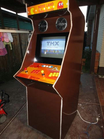

I also cut the holes for the Speakers in MDF and test fitted them in the Cab, with the TV, and the MDF panel for the CP as well.
I've never made anything as nice as this before, it was such a great feeling when I slid the TV in and it fitted perfectly, less than a 4mm gap on both sides, looks great too.

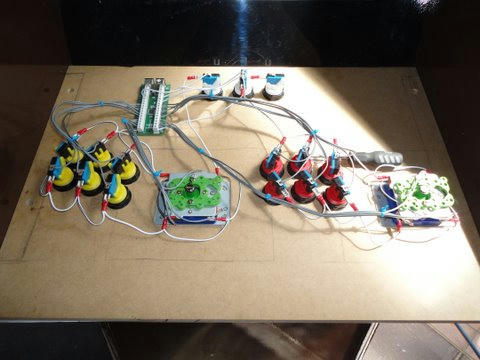

I'm using a I-Pac from Ultimarc.

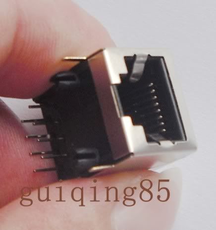

My buttons wiring & the I-Pac will be wired directly to these thingies from eBay:
This way, I can use standard network cable to plug them in and be able to easily change CP's & even individual parts. In theory of course.
The I-Pac will not be on the CP in case I make multiple CP's.

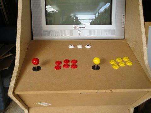

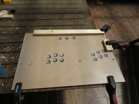

There never seems to be enough hours in the day when you actually want to do something, but I finally had some time to get to work on my Control Panel.
I printed out the button template on A3 sheets and stickytaped them down on the panel to mark the centre of all the holes.
All the button holes were drilled out just using a 28mm Spade bit.
I've seen some people say that spade bits are a bad choice, but they've always worked a treat for me, and this was exactly the case here too.
All the buttons just popped into place, and are just where I wanted them. I'll be bottom mounting the joysticks but I haven't routed out a groove for them yet, they are just temp screwed in to see how they feel.
The player 2 buttons are slightly off angle to make more space for the players to stand.
Player 1 stands normally on the left, while Player 2 stands on a slight angle on the right.
This way 2 full size guys can play without bumping each other on the 600mm panel.
I actually prefer to stand on an angle when playing arcades so the Player 2 position feels more natural to me than Player 1, but both feel very comfortable. It seems to be a good fit with the height & angle but of course I haven't spent hours in front of it yet playing away...Fingers crossed it stays as comfy as it is now.

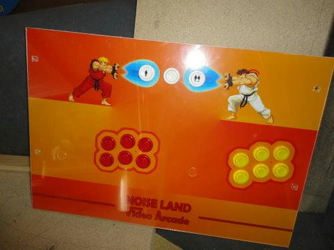

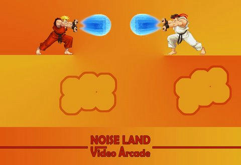

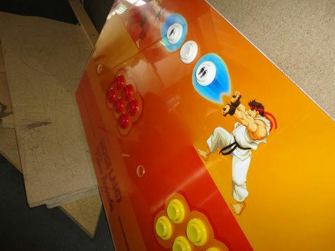

I've also been able to finally name my Arcade and design the artwork for the Control Panel.
The name shall be "Noiseland Video Arcade" (the name of the arcade in The Simpsons.)
I'm sure it's been used on 50 cabinets already but it really fits my cabinet, #1 - I LOOOOOVE the Simpsons and #2 - Today I received the amplifier I ordered from Hong Kong to drive my Car Speakers - Let me just say - HOLY CRAP!!
This is one LOUD & crystal clear cabinet, I'm not going to install a woofer because there is no need, it really will be "Noiseland" when you start playing!
So anyways, I created the Noiseland logo, added Ken & Ryu, and then was stuck.
I wanted some fireballs but ones that fit my panel design, not real life flames.
A bit of mucking around in Photoshop and I ended up with these blue fireballs to border the Player 1 & 2 buttons.
I'll get it printed in the next day or two, but to help with tweaking the design, I manipulated this photo:
I must have made around 15 different versions of this image, but I'm glad I did, it's a very bright, colourful and clean image, I think it'll look good under plexiglass.
As for printing, I think I'll just get it printed on a thick gloss paper, then it will be covered with plexiglass.
Any reason why I should pay extra to have it printed on a thicker laminate type material over the net?
It will cost me around $15 at the local officeworks to get it done my way, any advice?
So that's where I'm at at the moment, hopefully my network dongle thingamajigs arrive soon, once I have them I can wire this baby up!

That looks great, I like the side profile! I was wondering why you ordered those jack for the ethernet cable off the web though, most hardware stores [around here anyway] sell them. The most popular or at least readily available are the Leviton quickport jacks.
I've actually never seen anything like what i ordered in the shops before, but can't say I actively went looking for them either. It was just a lazy night in front of ebay buying parts and these seemed like a good idea.
I had a look at the Leviton jacks, they look great but are around $4-$5 each one. I bought 10 of the other ones for $4.50 inc postage... Yep, I'm a tight-ass...

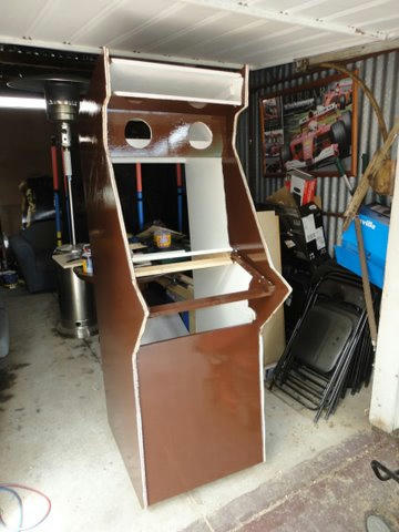

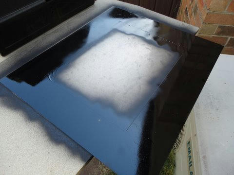

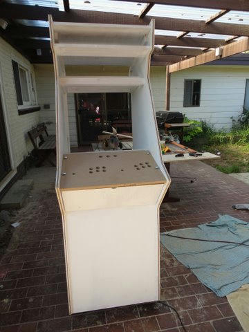

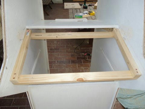

Well I got a stack of work done today, very happy with Noiseland's build so far!
I gave the cab a coat of primer yesterday, then today I realised that, bugger, I hadn't routed out the groove for the t-moulding!
But everything turned out well in the end, I headed straight down to my local Bunnings, and found the exact slot cutter I needed straight away, woo-hoo!
I've been using routers for about...25minutes now, so I thought I better practice heaps so I didn't ruin the cab so I grabbed some offcuts from the side panels and started to play around.
It took me longer to figure out the height needed, (with copious amounts of double checking) than it did to rout out both panel grooves. Routers are awesome, it went through the wood like it was butter and left a beautiful smooth groove all the way around.
Here's the result:

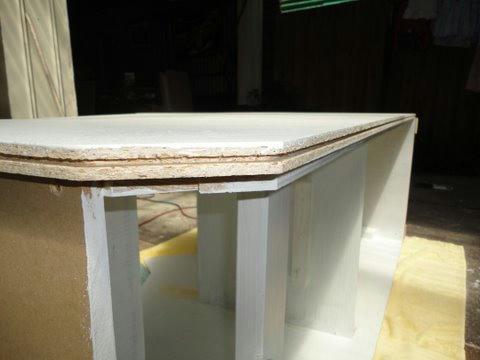

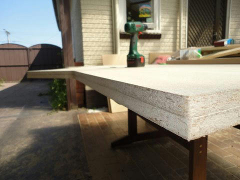

It may be a boring photo to you, but man, routers are magical machines which I have just now discovered!
I also built the frame that the CP will sit on and fixed that to the cabinet.
And this is what it looks like when the CP is mounted to that.
I've routed out the CP to raise the joysticks a little, no photo of that cos I didn't do a perfect flush job of it. :-[
I like the bolt heads showing on the CP, but I have to sand / polish the heads of the bolts as they have the manufacturer logo on them.
I'll start googling how to do that after I finish this post.
I also took the artwork to the printshop for the CP, I pick that up tomorrow when I'll buy some more plexi for the CP as well.
Hopefully the cp is complete in 24hrs from now...
I didn't take any photos but I also cut up 2 pieces of acrylic for the marquee and the main screen piece which I will spray the edges black to create a bezel.
Photos of that tomorrow, cos I'm damn tired now...
Have a look at this http://forum.arcadecontrols.com/index.php?topic=87061.80
I used that method and ended up with these babies :-) very happy with the result.

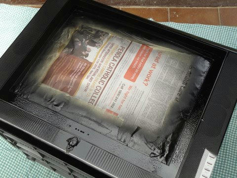

The plexi bezel being sprayed:
I was a bit worried that it would look like a real crappy bodged together sort of bezel, but it actually looks really really nice & glossy.
Just to make sure that you can't really tell it's just a TV in there, I also sprayed the front casing of it black too:
And the result of 1 coat primer & 2 top coats:
I picked up and almost bought a can of gloss black paint in the store, but changed my mind at the last minute.
I thought that black may be just too boring especially if I don't have artwork on the sides for a while.
I figure the brown will complement the orange & yellow used in the marquee & control panel, and will also look nice with the Red T-moulding I bought.
The control panel art sandwiched between mdf and plexi with buttons installed, I love it!

Wiring:
I gave up on waiting on the network plugs to arrive from china, they've gone missing methinks.
Seeing as I probably won't be making another CP for this cab, the setup works quite well I think, I figured that I may as well just wire the buttons up
as you normally would. So I did, and then spent 4hrs in front of my computer "testing" the wiring in every game I knew.
Works GREAT! The I-Pac is a brilliant device, if you're thinking of getting one and are in Australia at the moment, buy it now!
The USD is very weak compared to normal, I nearly bought the I-Pac 6 months ago, it would have cost me $96 but I backed out.
I bought it for $72 just 2 months ago, and priced it at only $59 just a week ago, the rate will change back soon so if you plan on a cab in the next year, buy one now!

Almost done!
Here's a before & after of my shiny new bolt heads thanks to Vebbo's tip:
They look great thanks heaps!

The white button in the middle of my CP is now a pause button, very useful for when the kids start yelling at daddy to come inside...
The only major work I have left to do is install the back doors on the machine.
Hopefully I have time to do that soon as I don't really like leaving all those tantalising wires & cords for my dog to stare at all night...
You can see the cake tins behind the speakers at the back, I need to mount them properly, at the moment they are only held on by the force of the speaker magnets. I also need to clean up the wires a bit so it doesn't look so haphazard in there, but that shouldn't take too long.
And this is what it looks like from the front,
I have 3 different marquees that I've designed to choose from, it only takes a minute & a screwdriver to change them over.
