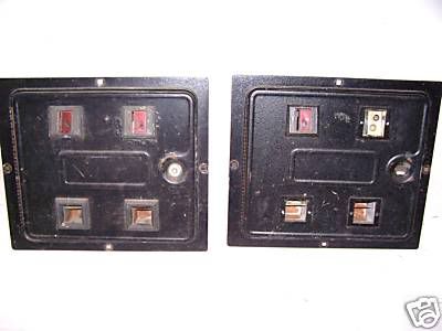

Hoping some of you experts out there can give me a hand.  I purchased these two coin doors on Ebay which are supposedly from an upright Asteroids cabinet.
Questions:
1) Do these look salvageable and are they Atari Asteroids? (Would appear they are Atari based on http://www.quarterarcade.com/Content/Articles/JoustRestoration.aspx
2) I can see I would have to replace the Reject Buttons. Would a Happs part be universal?
3) If I cannot get the coin mech working which Happs part would likely work?
4) I am assuming a Home Dept Camlock of the right size would work?
Thanks in advance!
Looks good to me.  Just needs a lot of TLC.  See my page: http://pealefamily.net/tech/arcade/coindoor/ .  As for Asteroids the cab used a couple different coin doors, and this looks like one of them.
Absolutely NOT.  IIRC rejects on this aren't easy to source.
The mech itself will probably work fine.  They're built to last a long, long time.
7/8" cam lock is the size you need.

« Reply #6 on: November 05, 2008, 05:57:39 pm »
Looks like the same door that was on my Taito cabinet.  If it is, then it is a Coinco 2802 Series Game Door.  The unique thing about them is that the coin slot is part of the reject button and part of the bezel.  The coin slides between the coin insert bezel and the reject button.  Most coin doors have the coin slot completely in the reject button.
I took mine off, stripped it, repainted it and cleaned the reject buttons on my project.  I spray painted mine with a satin black that was similar to the color I painted my cabinet.  You can see the finished door in this link at the bottom.  The last picture shows the reject buttons the best.
http://forum.arcadecontrols.com/index.php?topic=82903.0
Here is a link that shows the coin door before and some good pictures of the reject buttons.
http://forum.arcadecontrols.com/index.php?topic=83189.msg869782#msg869782
My door was in better shape, but had a lot of wear and tear around the coin inserts and the coin return.  The mechs worked well as they were, they are built to last.
If this is the coin door you have, let me know as I have a good pdf document from Coinco that shows and lists all the parts.  The only problem is they do not sell direct.  I have not found a source for the reject buttons.  Mine look pretty good after cleaning, but I would love to get some blue ones to go match the cabinet T-Molding.

Yes it's a Coin Acceptors (a.k.a. Coinco) brand door. Here's the manual for yours:
http://arcarc.xmission.com/PDF_Coin_Mechs_Etc/Coinco/Coinco_2802_Series_Game_Door.pdf
Good luck trying to get parts for it.

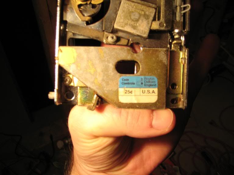

Here are some updated pics to maybe help identify them:
You can see a bit more clearly that the quarter goes into the Reject coin button and not beside it.

« Reply #24 on: November 07, 2008, 01:15:39 am »
Someone has mistakenly put a "Coin Controls" brand coin mech into one of the Coin Acceptors (a.k.a. Coinco) brand coin door.
You do indeed have two Coin Acceptors (Coinco) model 2802 doors. They were made with two styles of reject buttons over the years. The first style (and the one that was in production the longest) was the red one in which the coin passes THROUGH the button. The second style (and the one that was only in production a couple of years) was the orange one where the coin passes TO THE LEFT of the button. Both of these styles are shown in the manual I linked you to.
Remember, a COINCO red reject button LOOKS like a Coin Controls red reject button, but they are NOT the same and do NOT interchange. Coinco (Coin Acceptors) are all 100% made in America to American hardware standards & measurements. Coin Controls products are made in England and are 100% METRIC hardware standards and measurements.
