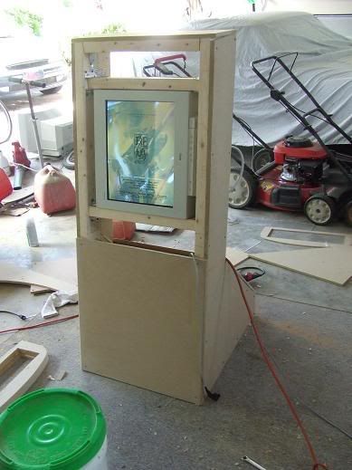

Little update.

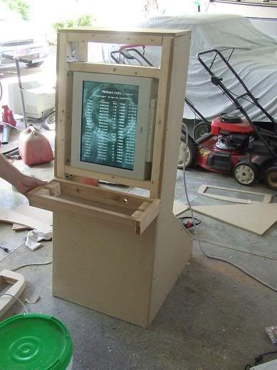

Ok so here as an update. Its been a while. So I mounted my monitor a few days ago and I was really happy with how well it fit and how level it was. So I go to turn it on and it frys instantly. You take your chances with these garbage dump monitors. So I didnt really learn my lesson because I went to the garbage dump again today and I couldnt believe it. Right there was two of the same exact monitor I blew. So I took it home and it works great. I realy like this one because its got a glossy screen and I think it just makes it look much better when its turned off.  I think this model is made by Sony cause it says Trinitron and I think thats their brand. I spent a lot of time making a control panel out of layered mdf and it sucked. So now im going with some red oak and im building it the same way I have made control boxes before. I got a logitech speaker system for $25 (2 speakers and 1 sub) from Tiger direct and they sound really good.
I had this idea to make the control panel out of plexiglass, spray paint the underside with frosted glass spray paint and then put neon under it so the whole panel would glow instead of having artwork. I think I could get enough support for the buttons but I dont think I would have enough support to make the joystick sturdy. I might figure out a way to do it.
The plan is to use a dreamcast but I would really like to use a sega saturn but the saturn doesnt put out the right frequency and isnt compatable with vga.
When its done im goint to paint it all with glossy white paint.
 ok ok the pics..

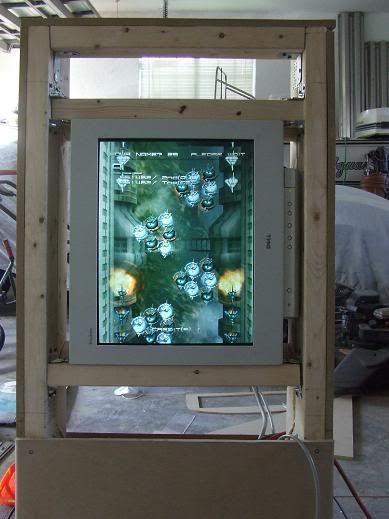

Yeah those Dell monitors are nice, Im using the 21" version in my cocktail. They sure are heavy though aren't they? I think the 21" are about 30kg (65lbs) so imagine the 19" isn't far off.
How are you supporting the monitor? From the pictures it looks as if the top and bottom bars are 'clamping' the monitor. I presume you are going to add extra support?

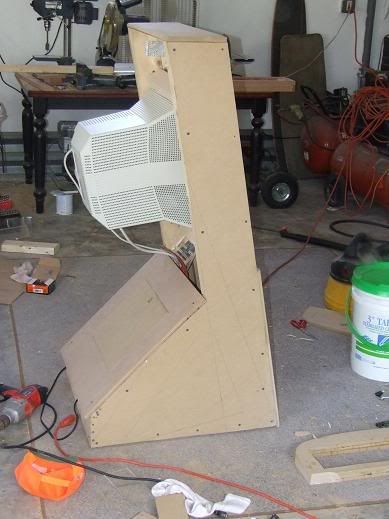

Yes the 19" monitor is very heavy. I actually have 2 2x4s on the top and bottom. The ones in the front are mounted flat. Then there are two on the back side that are angled and follow the shape of the monitor. They keep it from falling backwards. Even if the arcade was laid down backwards it would not fall out. Its kinda like a cradle.  Still I might add a little support on the bottom because im afraid the strain on the front end might hurt the screen in the long run.
I would like to get a bigger screen but I dont think I would be able to center it because I have it pushed all the way to the right now just to make it centered.

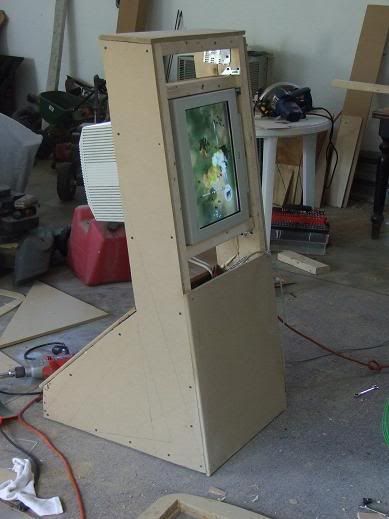

Here are some new pics. I painted it yesterday. I still have to sand it smooth and then spray it with a clear coat. I mounted the speakers in the top and made a bezel  covered in speaker material. It just pops right into the speaker hole. Its getting close.

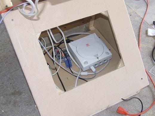

the Dreamcast is hooked up through a vga box into the monitor. The controller is a hacked Dreamcast controller. This site has a how-to on hacking one to arcade controls on the main page. Everything boots up from the flip of one switch under the control panel and the game loads automatically. You can find compilation discs of Dreamcast shmups from underground gamer so you dont have to switch out discs to play a different game. The memory card saves your settings for vertical shooters so you dont have to rotate the game image to vertical every time. I just like the simplicity of it all.
