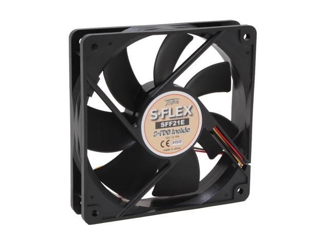

Very nice, thanks. According to my plans there is only one cooling fan mounted in the cabinet. It doesn't seem like enough considering that it's a cramped enclosed space with a hot monitor, power supply, coin door lights, etc. Is one fan really adequate for a cocktail, or should I mount two?
shardian
  • Posts: 9218
Re: Pac-Man Cocktail Build
« Reply #18 on: January 15, 2008, 11:18:09 am »
I am not sure of the CFM's of a stock pac cocktail fan. The original fan was a pretty good sized fan. A 120mm case fan isn't quite as big, but still should be comparable - it moves a good amount of air at 12 volts. 2 120mm fans at 9 volts would definitely move enough air, and would operate more quietly.
  • Posts: 7931
« Reply #19 on: January 15, 2008, 12:17:20 pm »
I use these:
http://www.newegg.com/Product/Product.aspx?Item=N82E16835185005
Nearly 50CFM and silent. A little pricey - but well worth it.
