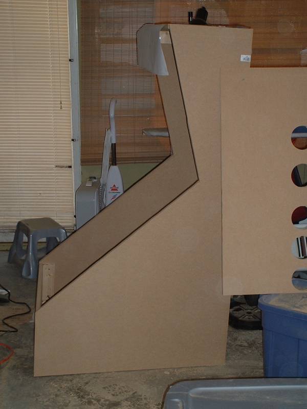

Since I have actually started on this, I thought I would move it here. I have been trying to locate a skeeball locally in Georgia with little to no luck. It was hard enough for me to find an arcade cabinet here, much less a used and REASONABLE skeeball. I thought that since an arcade cabinet is possible, why not skeeball ?
UncleT has been kind enough to provide dimensions and details on many things here, and I have my own drawing along with a pile of skeeball pics in a zip file at ixliam.home.comcast.net/skeeball.zip. It is 5mb however.
I am going to go for this body style below. There doesn't seem to be much variation in the ramp, but there is some in the way the scoring section is cut, along with variations in the support for both (steel legs, long cabinets, support boxes underneath).
The scoring is a simple circuit that is nothing more than a 3 chip counter, and the ball count is the same just one chip less. As far as how it stops the balls from rolling down the ball return, there are a few methods that I think would be feasable for the home builder. A start button with an electric solinoid to open/close a release gate. A manual button that pulls down a gate, or if you wanted to just use one ball the counter could close the gate at ball 9.
Construction pics are below, and feel free to ask any questions you may have.

Ramps and support pieces.
Score section side panel.
Assembling the score section.
Target with 4" holes cut.
Assembled Score section w/ Target
Support brackets for target. The gap between the target
and front is large enough for a skeeball to fall through (for
total misses).
Score section with target in place.

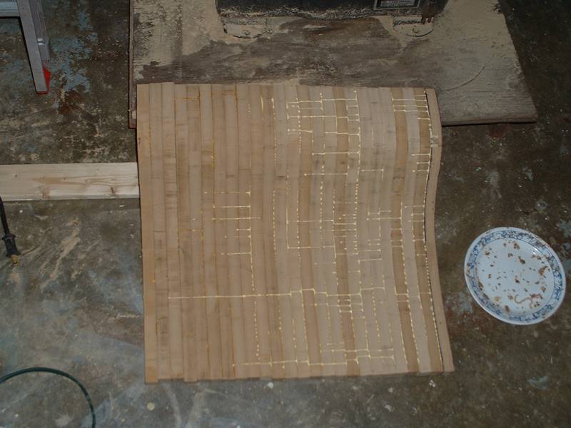

This didn't work out so well. I was trying to heat
this 1/8" lexan. Some curved well, some didn't.
The problem was I could not get an even curve
overall. Maybe if you had a mold, that would work.
So, onto option #2 for the curve - use the MDF scrap.
I will have to cut out 25 of these to get the 19"
needed for the ramp width. Sucks, but on the
other hand it will work after I give it a good sanding.
Here are two of those pieces together. I will
assemble them with two large dowel rods and
wood glue (tomorrow). Course I have to cut the
rest out first  :'(
Brad

Today was pretty much an all-day project on the ramp, though some of it was spent getting some hardware. My parents were kind enough to give me a bandsaw (which saved me from buying one). They had this sitting in their out building for about 18 years. A little WD-40 and a new blade and she was buzzing. Also mad a trip to Lowes for the rods and wood glue, along with some red paint. Ended up picking up a belt grinder to do all the sanding with to even out the ramp.
So, for todays long project, I couldn't find wooden dowels so I used 1/4" threaded rod. On the start end I put a lock nut and recessed it into the wood. Then I started stacking the parts that I had cut. I used one part as my master part, which had pilot holes for the threaded rod hole and was what I based all the other pieces I cut on. Each piece was then placed onto the rods and then wood glued to the next piece. There are a grand total of 25 pieces of this stuff, and I would not recommend trying to cut them out with a jigsaw. A bandsaw or a scroll saw is the only way to do it.
Another option for the ramp would be to put a piece of wood across the ramp frame at the top, another in the center of the S curve, then secure some flexible plastic/wood material to those points and to the ramp holder. It might just form the correct curve on its on, or be pretty close. For now, someone else can try it unless I build some mini 5" ramp model to try.
So, here are todays construction pics.
Ramp curve in partial assembly.
The curve is finally put together.
Curve after a nice sanding session.
I will probably get the ramp together tonight, maybe put the target white curves together then call it a night.
Brad
« Last Edit: August 17, 2007, 02:00:45 pm by saint »

Here is the ramp assembled, minus the cork surfacing.
Brad

Also, something looked wrong about your target layout so I started to look into it.
It turns out that the drawing I sent you showing the measurements for the target board layout did not correctly show the layout of the hole positioning.   Basically, the bottom hole (10 points) is shown as being right near the bottom of the target area .... and this is not correct (or at least not how my machine has the holes laid out).   There is a 4 3/8" space between the bottom of the target area and the bottom 10 point hole.
I attached two pictures ...... one showing my SkeeBall machine showing you the space under the 10 point and an updated measurement diagram of the target area.
I do not believe it would be too hard to cut out the target board again, but I am not sure if your progressed to far today or not.
PS:  Sorry about the missed measurement ........  hope I am not too late

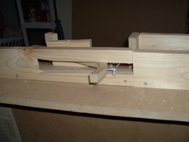

Here are more of todays construction pictures.
« Last Edit: August 17, 2007, 02:06:21 pm by saint »

« Reply #14 on: January 02, 2005, 10:14:14 pm »
Test baseball ready for release.
Lets play! (this is my test ball, I have wood balls on order for this.)
To answer something I forgot in the earlier message, for the display I have bought an original skeeball display which uses lamps to light the LED-ish segments. It will give a more authentic look, though you could go modern with either a 7 segment LED display or use an LCD and make it like the modern ones I have seen. But on the LCD, you would need to add the computer interface or possibly do it with a basic stamp.
Brad
« Last Edit: August 17, 2007, 02:09:21 pm by saint »

Construction notes.
I have spent two days on the ramp itself. So far, that is the hardest part, and heaviest part.  About 1/2 a day was spent cutting the cutting the curved pieces, and an entire day was spent on building the side sections. If anyone decides to do this, know that the ramp is the hardest part to build, and harder if you are going for the exact curve of a skeeball machine. If you did it with wood slats and bondo, it would probably take less time.
Brad

This next picture shows how far the "top" part of the marquee art is recessed.  Reference the marquee picture above to see how the marquee art actually looks while mounted.   Also, (based on the picture above), please note that the sides of the marquee art are gradually less recessed going from top to bottom.
unclet
  • Posts: 3561
Re: DIY Skeeball
« Reply #24 on: January 03, 2005, 03:34:50 pm »
Also, something which I have not mentioned before was the "pegs" located behind the 50 and 100 chutes.  These pegs makes sure the ball does not get wedged behind a chute.   The ball will simply hit the peg and fall to either side.
Also, I am showing you the height distance from the top of the target board and the bottom of the marquee area.

Now ... have you decided whether you are putting a netting over the target area .. (or something similiar) ....  so the balls do not slam into your marquee?
Ixliam
  • Posts: 126
  • Last login:December 01, 2018, 01:23:31 pm
  • DIY Skee-Ball Man
Re: DIY Skeeball
« Reply #27 on: January 04, 2005, 12:35:35 am »
Yep, it will have netting. Don't need it flying through the windows either. I'll weld/bend a frame once I get to that point.

Here's todays work. Only thing is that when you see the board I added in under the bottom of the ramp, it didn't hold well when I attached it to the score board. The woodscrews holding it to the 1x2's pulled right out after about 10 minutes. Nothing fell as I had jacks underneath it "just in case", but I will have to get some heavier material for the board support (like a 2x2 along with some bolts to attach it to the frame.
I haven't made the 100 rings yet, so that is why they are empty. We did play a few easy games of it, not willing to hurl the ball too fast since I have no netting and no backboard (with windows all around). Tomorrow after work I will fix the support issue and work on directing the flow of the balls to the return chute. RIght now, they just hit the floor.

This is the board that pulled loose. It was only held on by the woodscrews going into the 1x2's behind it. I will be swapping those 1x2's and woodscrews for bolts and 2x2's.
« Last Edit: August 17, 2007, 02:33:20 pm by saint »

Good progress...... how did the curved ramp section feel when playing?
Also, what are those blacks strips with screws in them shown in your picture?  Are these the rubber guards for the sides?    If so, are you going to try to recess the srwew heads a bit?
PS: If you attached the L-brackets for your target chutes on the "inside" of the chutes then they would not be seen by the player......
