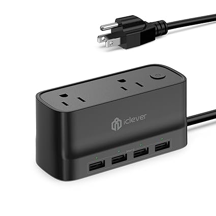

Good day to you all.
I have been wanting to make an Arcade for a while now, however how I go at it its certainly confusing concerning certain aspects of the cables.
I already designed the cabinet (Child's Play, I'm an Architect), got the TV (Flat Screen Plasma for personal use. Future projects will go with more traditional squared boxed TV) and I will go with a Pandora's Box for the first round of my custom arcade, so I do not have to deal with Raspberry and making the controls on a board on the first Cabinet.
However, I would love at LEAST some originality and that is to have a power button supply that will turn everything on, from the audio, TV, and board at the same time with just a switch of a button.
It may sound silly to some of the more experienced users here, but for the love of me NO ONE is teaching how to use this:
https://www.amazon.com/URBEST-Module-Switch-Socket-IEC320/dp/B00ME5YAPK/ref=pd_bxgy_21_3?_encoding=UTF8&pd_rd_i=B00ME5YAPK&pd_rd_r=XEFFF7C5S8NX9J810BTD&pd_rd_w=xoyRq&pd_rd_wg=AwTrM&psc=1&refRID=XEFFF7C5S8NX9J810BTD&dpID=41M3ihJfrpL&preST=_SY300_QL70_&dpSrc=detail
With a Power Module or whatnot! I want nothing but perfection in everything (Major personality flaw.) so I'm stumped at my inability to understand how that switch works with one of these ;
https://www.amazon.com/WINIT-Switching-Cabinets-Upright-Cocktail/dp/B01C5E8W3K/ref=pd_sim_60_26?_encoding=UTF8&pd_rd_i=B01C5E8W3K&pd_rd_r=X0GM263SDD4MK9CYDWKD&pd_rd_w=jJALu&pd_rd_wg=0txFf&psc=1&refRID=X0GM263SDD4MK9CYDWKD
Any tips? Helpful information? Anything at this point is greatly appreciated.

The switch controls the flow of power to the power supply. It doesn’t do any sort of smart interaction, it’s literally just power on/power off. You’ll run wires from that socket to the AC in lines and FG terminals on the switcher. Commodore Scott will probably soon welcome you aboard the good ship BYOAC and provide you a diagram, so you’ll see how super easy it is. Good luck!

The missing piece is a modified surge protector/power strip -- cut the power cord like the picture in the wiki.
Here's the power chain:
Wall outlet > IEC power cord > IEC power inlet/switch > surge protector
Plug the monitor, switching power supply*, and anything else that needs AC power into the surge protector.
          * = Use the plug+wire you cut off the surge protector to provide power to the switching power supply. (AC in on lower screws)

One-button power?  Get a smart power strip.
Using the switch you posted?  Get a regular power strip.
Using both a switch and a button?  Get a smart power strip.
The wiring part is easy.  Making up your mind is the hard part.

-The reason I'm going with this switch instead of a Smart Power Strip is that I plan on having a Power Strip inside the Cabinet connected to the switch (after looking at the links provided I have a rough idea of how-to now) as such to simulate the one power turn-on of a traditional Cabinet.
Like I said, this one is a personal beast. I'm going to program a PC in order to boot into several emulators and use Dolphin as well with a sensor bar (And DolphinVR is a thing. Yes, you can see where Wii Games + Sensor Bar + Light Gun + VR is going.) In order to have an all-purpose Cabinet. But those add-ons are the fancy shmuck stuff, right now I'm focusing on building the actual working Cabinet with the sticks and my horrid LCD Tv.
