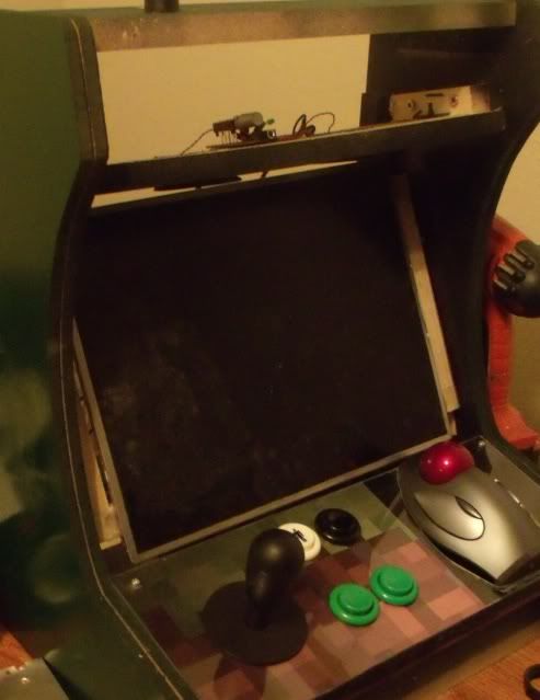

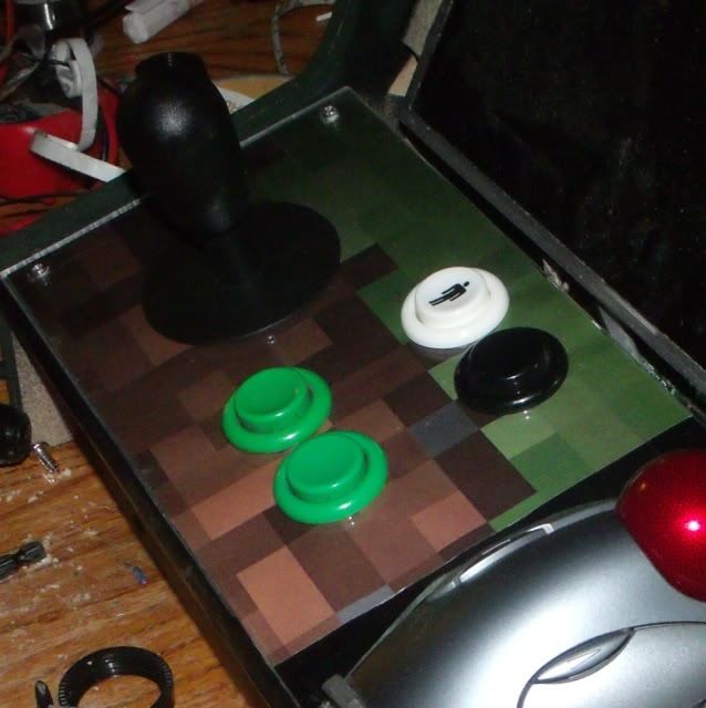

I wanted to see how cramped that CP really would be with control for 2 players so I ordered some cheap buttons and joysticks and made a CP to fit. Here it is in place on the build so far:
As you can see, the left joystick is far too close to the side. It was unusable so I remade the CP moving everything as far right as possible. The result is a CP that is cramped but definitely usable. I don't think it would be acceptable for the real gamers out there but for me it's fine. You can see the adjusted CP layout in some of the photos that will be coming later.
  • Posts: 9787
  • Last login:Today at 04:31:42 pm
Re: Pacman style bartop cabinet build
« Reply #2 on: December 28, 2012, 06:57:34 pm »
Welcome aboard.  Looks like you're off to a great start, Fieldofcows.   :applaud:
Have you tried getting two people on the controls at the same time?
Looks like you'd be better off either widening the cab/panel or only putting one joystick/6 buttons.
Even if you go to single player controls, keep P2 Start for the titles that use alternating play instead of head-to-head play.
I assume that the black button between the start buttons is a coin button.
If you keep both player controls, consider adding another coin button for P2.
Gauntlet2p, Simpsons2p, etc. add credits to a player based on which "coin slot" is activated.
« Last Edit: December 28, 2012, 07:00:26 pm by PL1 »
I've just got my 7 year old to sit next to me at the controls. It's tight but playable. I think I'm going to go with this but make a second 1-player only control panel. I've already put a pluggable connector on the XBOX interface board so I just have to remove the CP, unplug it then plug in the other version.
I don't plan on making the front panel removable so the 2-player button will stay regardless.
I didn't realise there was a second coin operation for the second player. I will remake the front panel with 2 coin switch buttons. Thanks for that  ;D

I agree with PL1 that the CP seems a tight for two player.  Fewer players or fewer buttons might help.

« Reply #36 on: February 16, 2013, 06:17:56 pm »
I can't believe over a month has gone since I last updated this thread! I haven't had a lot of time since christmas to work on my bartop but I have chipped away at the work to the point where it is now nearly complete.
The painting took forever. Mostly waiting for each coat to dry before sanding and applying the next coat. I'm really pleased with the result though. It's not perfect but it looks great.
Onto some pictures:
Couple of coats of yellow applied.
Painting complete.
Nearly there!
T-molding applied.
I've still got a bit of work to do - the marquee is made out of paper at the moment just to give the impression of it being complete and I need to tidy up the innards a little bit though but it's been getting a good workout from me and the kids since moving into the house!
