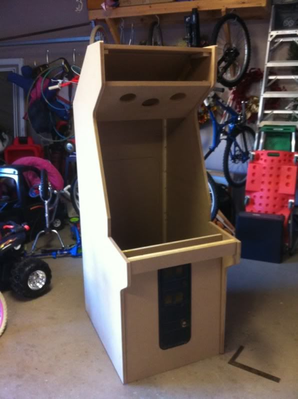

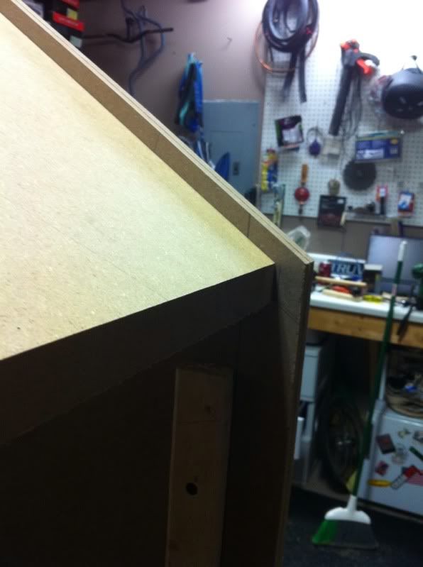

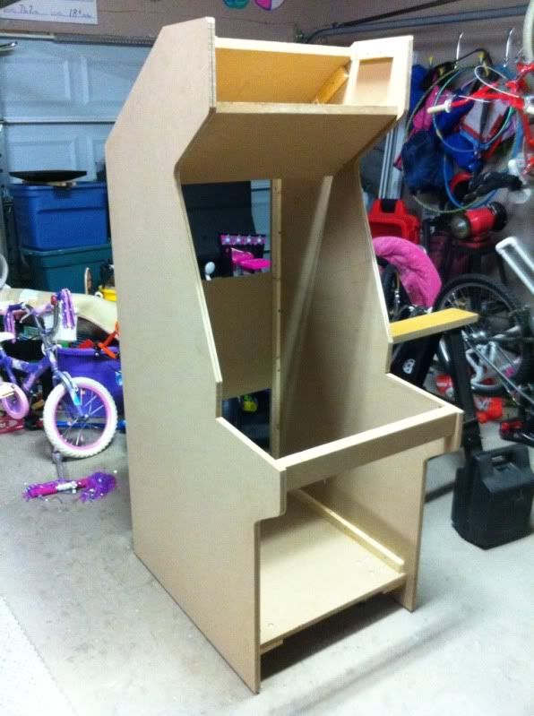

Just use standoffs/cleats.  I used 1x2 "select pine strips" as furring strips.
http://www.homedepot.com/h_d1/N-5yc1v/R-100074242/h_d2/ProductDisplay?catalogId=10053&langId=-1&keyword=1%22+x+2%22&storeId=10051
These are much nicer than the furring strips.  They're straight, dense and strong.  To get a 3/4" overlap on the edges, glue/screw them in about 1 1/2" from the edges.  I have mine drilled from the inside, so there's no external screws/patching.  In the pic, you can see the new one ready for the back/door of the cabinet...
Once the cross board are on (for the top, back and front), the entire thing is triangulated and pretty strong.
The only cross bracing that I DID do was to put a 1 x 2 cross brace at a 45 degree angle inside the cab from the furring strip holding the angled back piece to the furring strip holding the back on each side.  So, basically a 11" triangle at each corner.  This made the cab very strong...like a fence door.

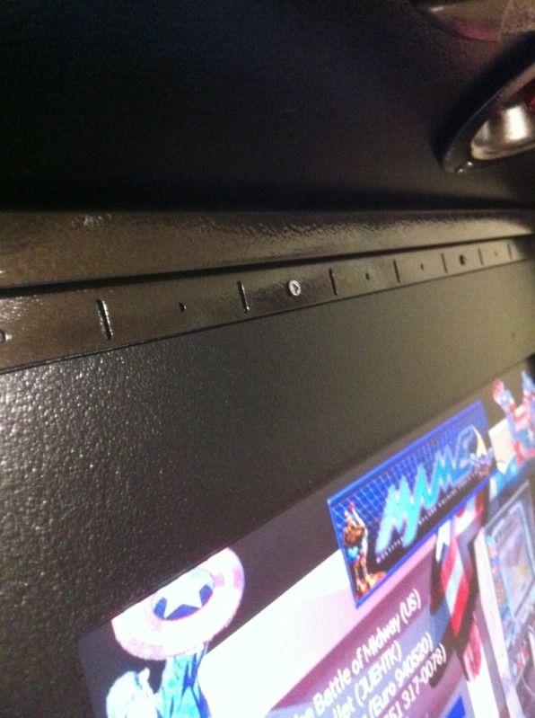

For paint, the best I've found is the Rustoleum Painter's Touch Ultra Cover latex...  After about 4 coats, it looks like a melamine finish...just a touch of texture.  Here's the non-ultra cover...
http://www.homedepot.com/Blacks/h_d1/N-25ecodZ5yc1vZ1z1409i/R-100208855/h_d2/ProductDisplay?catalogId=10053&langId=-1&keyword=painter%22s+touch&storeId=10051
Here's the hint of texture...this is a VERY closeup picture.
