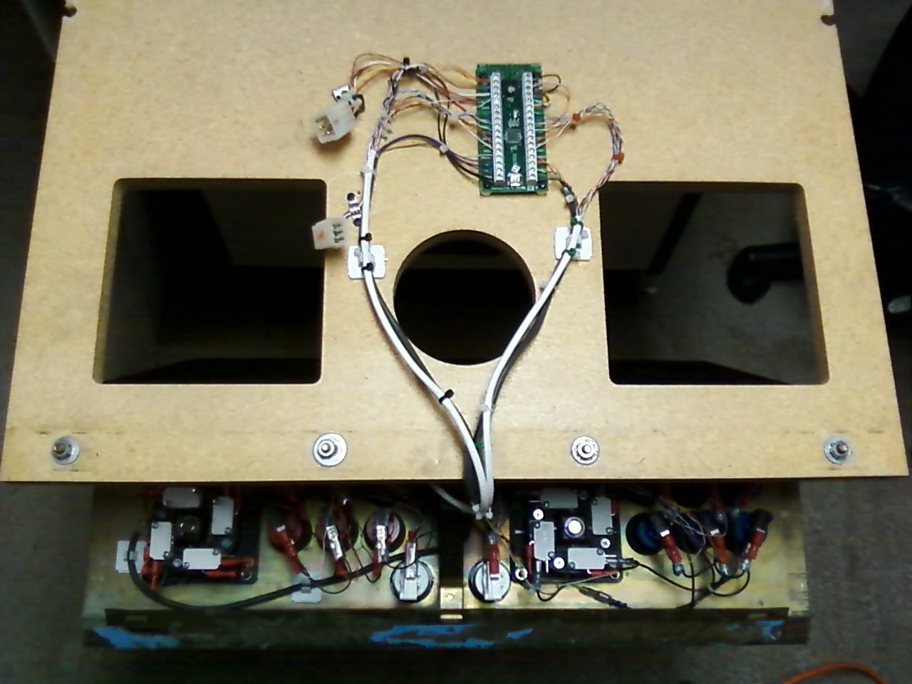

Heres's mine using Cat5 cable (what you refer to as RJ-45 which is the actual connector itself).  I color coded the wiring using the sheath to match the joystick colors.  So blue would be for the blue controls, yellow for the yellow controls, etc.  That makes finding stuff easier.

Here you go.  22 ga solid under each panel, 22 gauge stranded going to the pinball buttons, stranded cat 5 connecting each side to the i-pac 2.  USB hub for my U360 and my swappables.
