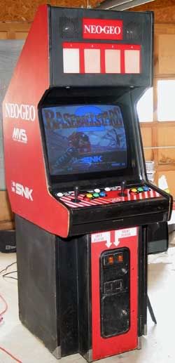

I like the look of the Neo-Geo cabinets which look to be a 2 piece design
The nice thing about a 2 piece design is that its a heck of lot easier to relocate.
