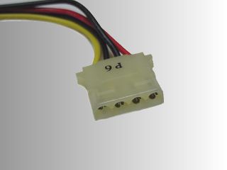

When I started this project, I ordered a HAPP light up trackball. Everything looks good, instructions tell me how to wire up the buttons and USB, (Tested & it works)... but nothing to instruct on the wiring for the bulb to light up...
This looks to me to be an incandescent bulb... does anyone recognize this and is able to direct me on how/what to do to hook up power to this and light it up?
  • Posts: 9784
  • Last login:Yesterday at 03:31:37 pm
Re: New Mame Cab First Conversion
« Reply #60 on: April 02, 2020, 10:54:19 pm »
Pretty sure that is a 14v 0.19A #161 bulb.
You can get 12v (yellow) and ground (black) from a molex connector in your computer.
- Hack a 4-pin molex splitter or extender.
- There's no polarity for the bulb socket -- just solder one wire to one tab and the other to the other tab.
- Commonly available 24AWG, 22AWG, or 20AWG wire will easily handle the current draw.

Awesome! Thanks PL1. I'll try & then report back the results.

1st, thank you to PL1! You were bang on sir! those connections worked like a charm, as shown in the pic attached... sadly it wasn't as bright as I was hoping for... so I guess that means I'll have to look at adding LEDs to brighten this up down the road.
