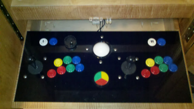

I fit a similar layout into a similar sized space on my cab:
It's 25"x12"
I have found the P2 joystick to be a little too close to the trackball, but still very functional.

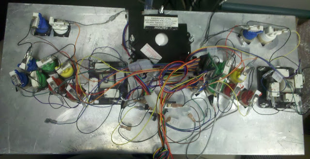

I actually added a spinner later on:
All of these are hooked up to a single minipac:
The pre-wired harness made this take about 5 minutes to hook up. But it looks like an absolute disaster.

Do you mind taking a shot of the minipac? I'd like to see how it's laid out
*Edit nevermind. Is that it resting between the P2 blue buttons?
newmanfamilyvlogs
  • Posts: 1694
    • Newman Family Vlogs
Re: New Mame Cab First Conversion
« Reply #21 on: January 27, 2011, 02:24:28 pm »
Yup. Just dangling freely.
There is a wiring block diagram on Ultimarc:
http://www.ultimarc.com/images/Minipac_wiring.pdf
It's very straight forward.

« Reply #34 on: February 04, 2011, 05:00:17 pm »
Thanks for all of your help & input so far guys! I love this community for that!
Anyways, here's round #4 for CP. As always thoughts & input welcomed.
Cheers! :cheers:
