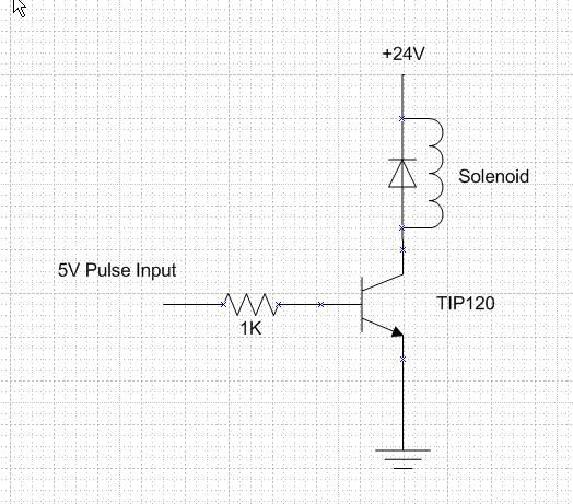

There are a couple of issues to deal with when integrating solenoid recoil.  First, you need 12-24v of DC.  You can't get that from the USB port.  Second, at this point anyway, I don't think any of the input pins on the AimTrak can be configured as output pins.  If that ever does happen, the microcontroller can be eliminated altogether, and the AimTrak could control the recoil.  At any rate, I decided to create a parallel circuit for the solenoid controlled by a microcontroller that does not actually interact with Aimtrak at all.  In my solution, when you pull the trigger on the Maverick, 2 buttons are actually pushed.  One for the AimTrak trigger, and one for the microcontroller input to power the solenoid.

Solenoid Parts for Recoil (Optional)
12-24v Powerful Solenoid (ordered mine from http://www.goldmine-elec-products.com/prodinfo.asp?number=G16036 though they aren't very quick to process orders and you have to order $10 minimum.  I ordered extra so I have replacements if I need them.)
Wire - 26 gauge (taken from CATV cable - you need 4x wires as long as or longer than the length the gun will be from the computer)
PC power supply
4 pin Molex adapter to plug into the PC power supply (optional because you can hard-wire if you want)
8-pin PIC Microcontroller (I'm using 12F629 - make sure to get the PIC12F629-I/P configuration.)
Programmer for Microcontroller (I'm using a JDM programmer)
Prototype PCB
4x 2-Terminal Connector Terminals (optional as you can hard-wire)
8-pin Socket
Transistor - (I'm using TIP120 Darlington Transistor)
Heat Sink for transistor
Diode (I'm using a IN4001 diode, but I don't think it matters what kind.  It came from a pack called "Assorted Rectifier Diodes" from Radio Shack.)

Part 4: Adding The Solenoid
Here's the solenoid I used.  Take a look and see how things work.  Notice that you can push the plunger (not sure if that's what it's called) in and the spring will make it return.  You can also completely pull out the plunger.  Put it back in and go ahead and use your PC power supply and touch the +12v and ground to the two leads on the solenoid (12v to one and ground to the other, it doesn't matter which).  Don't apply power for more than a second or two at a time or it will get very hot very quickly.  Does it do anything?  The spring may be extending the plunger further than the 12 volts can power it to return.  Try pushing it in a bit and adding power.  Does it do anything now?  Hopefully so or you may have a bad solenoid, or maybe you're not doing something else right.  I don't have any troubleshooting tips beyond try again and with another solenoid if you have extra.
The solenoid is attached to a bracket that will keep it from fitting in the Maverick.  Also the leads come up a bit too far.  These are going to have to go...
Using pliers, you can break off the plastic holding the external leads.  Don't worry if the the metal leads come with it... At least don't worry much.  You should be able to get to the leads with a little digging.
Cut off the bracket with your rotary tool and the cutting disc.  Cut as close to the body of the solenoid as possible so that very little remains.  If not, you'll have more to sand off.
Turn it so that the front is facing you.  We need to round it off a bit.  Notice the spots I marked in green.   I guess I didn't take a picture of the immediate result, but you can shave those parts off with a sanding bit on the rotary tool.  You can leave a ridge on the solenoid in this area, but it just needs to be rounded off.
Place the solenoid in the gun and push it all the way back.  Make a note of where the ridge is touching down.

Part 7: Solenoid Recoil Control Board and Programming
Disclaimer: You have my permission to use this schematic and code for your own purposes as long as you aren't selling it.  Now if you end up incorporating this into your gun and sell the gun, that's fine.  Please do not post either of these elsewhere without permission and without giving credit.  Feel free to modify the code and use the schematic as a starting place for something larger.  I make no guarantee that this schematic will work for you.  I did my best to create it based on the components I soldered onto my prototype board.  Build it all on a prototype breadboard to make sure it works for you before committing to soldering.  I will do my best to give support to those building these for there own use, but I cannot guarantee I will have time to do so.
Here's the schematic.  I didn't use standard symbols for all components in order to keep it as simple as possible for beginners.  Diodes are directional.  In the schematic they are shown as a pointing arrow.  Your zener diodes should have a black mark on one end, and the rectifier diode should have a silver mark on one end.  If you imagine your diodes as a pointing arrow, they should be oriented such that the arrow would be pointing toward these marks.  I (mostly arbitrarily) color coded the different lines in the schematic.  These lines should not touch any other lines.  You will see a couple places where these lines cross in the schematic, but there is an arch at these points indicating that the lines are not actually touching.  I recommend when you're building your own, complete one color line at a time.  If you add the LED, it will blink every time the trigger is pulled.  I think this is very helpful when troubleshooting.  If you see a blink, but the solenoid does nothing, then there's probably an issue with the way the transistor is wired.  If you see no blink, there's likely an issue with the microcontroller or the way it was wired.
Attached is the HEX file you can program to your PIC 12F629.  Just rename the attached TXT file to HEX.  I use a JDM programmer and IC-PROG found at http://www.ic-prog.com/.  You shouldn't have to do any programming or compiling of your own if you want to use my settings.  The way this is programmed, if you pull the trigger, the solenoid retracts once for 40 miliseconds and then is released.  Even if you hold the trigger in, it will still only recoil once.  I do plan on programming it to make it recoil if you hold it in, maybe with an automatic mode that will be activated with a switch, but for now it's one trigger pull, one recoil until you release and pull the trigger again.
If you have the ability to compile PicBasic Pro Code, here's my source code.  It's a bit dirty and there are no comments.  I was experimenting with what pins can be inputs and actually set up 3 as inputs that all do the same thing and 2 as outputs that do the same thing.  What this means is that if you use this code, you can actually wire your switch into one of the other pins and it will probably work the same.  The code can be changed to allow for an additional switch if you want an automatic mode, etc.

After proof-reading, I noticed some errors and corrected them.  There are probably still some errors.  I also updated some steps to hopefully be more clear.
Thanks to everyone who has given feedback so far.  I'm interested in getting feedback from anyone who actually uses the tutorial.  Let me know if something is not clear.
Also if there are any EEs that would look at the schematic for the solenoid recoil, I'm curious if there are any glaring issues or if there is any kind of feedback you can give.  I'm considering buying a power supply that can produce 24v DC since the solenoid should be more powerful at that voltage, but I'm not sure if the transistor or wires will be able to handle the amps required.  The parts are pretty cheap and I have extra, so I might try it anyway.  I have played through a few games that require rapid firing and the solenoid is holding up fine under continuous use.  It isn't getting too hot or anything at 12v, so I'm not sure if the jump to 24v would cause issues with heat or not.

That's a good question.  The issue is that I'm dealing with 2 parallel circuits.  If I wired the Aimtrak and the Solenoid Control board circuit into the same pole on a switch, there would likely be unwanted side-effects.  I don't want the current from one circuit touching the other.  I'm powering the solenoid circuit with a separate power supply from the PC running the Aimtrak, so they don't share a common ground either.  I'm not an EE so I can't say exactly what would happen, but I'm not going to risk damage to the Aimtrak.  There are probably better solutions like a 2-pole microswitch, but a quick Google search doesn't bring up any results for anything like that.  :-\
Edit: This 2-pole switch might work... http://www.allelectronics.com/make-a-store/item/SMS-224/2-POLE-SNAP-ACTION-SWITCH//1.html

I've had a couple of Happ recoil guns gathering dust while I tried to figure out how to do this very thing to them!
Would something like this solid state relay work for this application? ebay link
Code: [Select]
DC/DC solid state relay,2A 4-60Vdc, with relay ON indicator light. Offer is for 2 off Solid State Relay.
Specifications
Contact Configuration    SPNO
Control Voltage    4 - 32Vdc
Isolation Voltage    4000Vrms
Load Voltage    4 → 60Vdc
Max On-state Voltage Drop At Rated A    1.6V
Maximum Input Current    8 mA
Maximum Load Current    2A
Maximum Load Voltage    60Vdc
Maximum Turn Off Time    1ms
Maximum Turn On Time    1ms
Minimum Load Current    0.01A
Off State Leakage Current    1.0mA
Package    Module
Surge Current Peak    8A
My thought was that you could connect this after the microswitch in series to use the 5v(?) off the aimtrack to trigger the control circuit and hook the recoil board into the other side. That way no hacking of the microswitch required.
Alternatively perhaps something on the recoil board using an Led and an opto isolator?
I'd have a stab at it but my electronics skills are limited in the extreme!  :dizzy:

If Andy can supply a pulse output all that's needed is a 1K resistor, the TIP120 transistor and a "snubber" diode in a standard relay driver circuit.
I think Andy's right and that there shouldn't be an issue with a common ground.  For those folks who aren't familiar with microcontrollers and want to build this you can substitute the microcontroller with a One Shot circuit also known as a MonoStable Multivibrator.  It's a classic 555 timer circuit that has plenty of modern low-current substitutes.  If isolation is needed you can throw in an opto coupler.

Man...this is awsome...I have been puting off the 'Recoil' for the lack of trying to figure out the best way...I was going to however utilize the 555...I would be interested in the firmware also if Andy would be so kind..
captaincatalyst ..Nice Write up I like the circuit you built for the selenoid...How much is the programmer you used for the ic?
