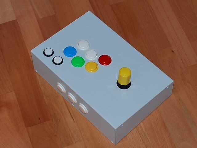

Hi,
I'm newish to the forum and am just about to start my first MAME cab. Quick question though, and it's probably a silly one. I'm struggling in my mind to work out how the 7 button layouts I'm seeing here are wired up.
4 buttons on the bottom row (Neo Geo layout) and 3 above (fighting game layout).
How's the Neo Geo layout A, B, C & D buttons wired up?
Surely the fighting layout has the punch buttons on he top row, so in the MAME cabs with 7 buttons, how are things wired up?
I hope this question makes sense!

Re: Noob 7 button layout question!
« Reply #1 on: February 23, 2010, 06:03:49 am »
You can assign buttons for every game individually if you like.
« Reply #2 on: February 23, 2010, 07:54:26 am »
+1 with Kman...
dont over engineer it...Make the layout that you want, then assign what buttons you want to do what in the Mame program...
« Reply #8 on: February 23, 2010, 09:44:07 am »
Can you guys post a picture of your 7 button layouts please?
« Reply #9 on: February 23, 2010, 09:46:51 am »
I suppose this is one way of wiring / laying it out...

« Reply #12 on: February 23, 2010, 10:48:06 am »
not mine, but this the general idea:
the 7th button is also a great run button in MK3/UMK3
this is what was meant by an offset 6 button layout:
« Reply #13 on: February 23, 2010, 11:05:08 am »
I will likely go 6 buttons on my current CP but another nice feature of the slightly offset (towards the joystick) 7th button in the picture above is that it makes a great reverse button for Defender/Stargate...but again you'd really have to be in to those two games to like it for just that ;)
