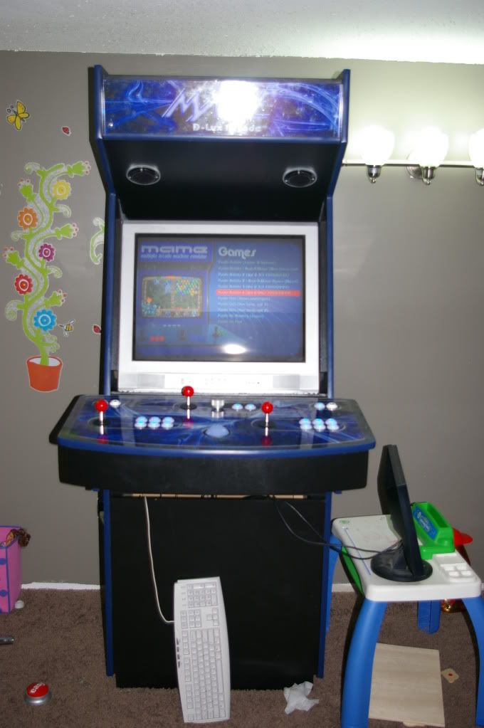

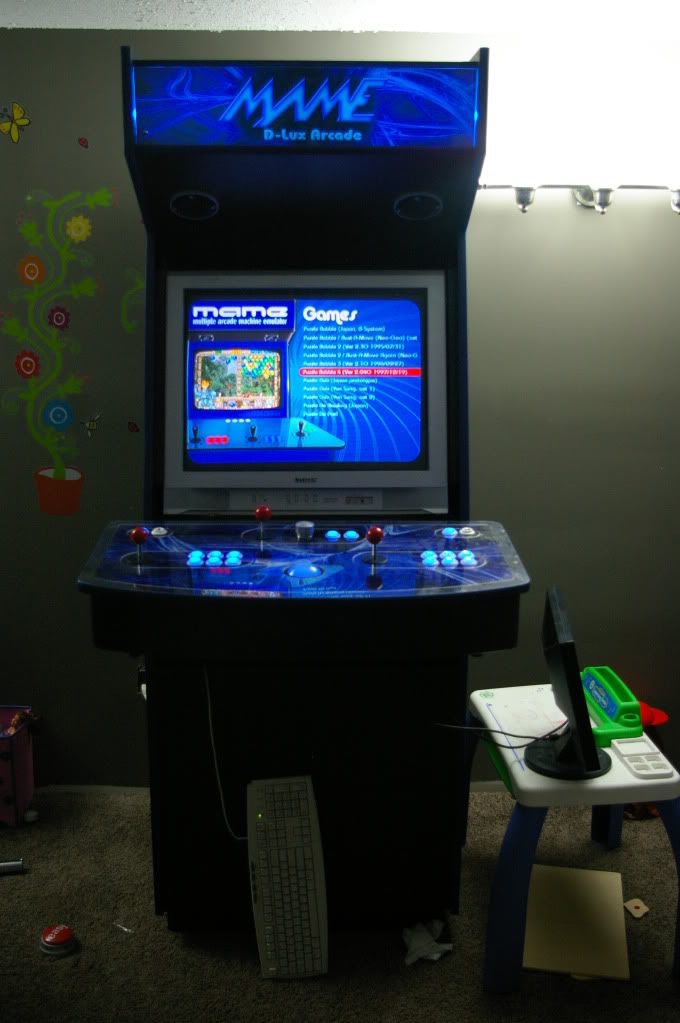

Well, this site has been more help than i could have ever imagined. I have always wanted to build a cabinet but never knew where to start. So after months of lurking around and reading, I took the plunge and ordered my parts and built a cabinet. Having read as many threads as i could, i felt confident that i could build one. I went with J-Sticks, I-Pac4, electric ice buttons, turbo twist 2, and an electric ice track ball. Software is Winxp SP2, Mame 0.136 and the latest version of Maximus Arcade. My problem now is that i can not get my track ball and spinner to work with mame. It works in windows though. I have done some reading and changed the ini file in mame to read mouse=1 and still nothing. Am I missing something simple and overlooking it?
The arcade is not in its final resting place. It is just where all my friends left it when we got it inside the house. After the workout they got, they all took off. So once its in place and has the coin door on and the plexi on the front, i will have better pictures.

Great job!
Very clean and neat, plus I see it has an "easy button". Ive got one of those on the desk at work.
About the trackball and spinner, make sure the mouse is enabled in the mame cfg or ini file.
Just re-read your post and see that you have already checked the ini setting.
