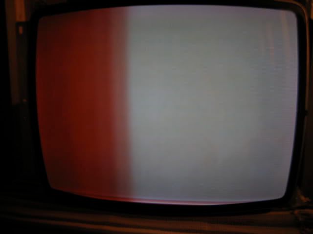

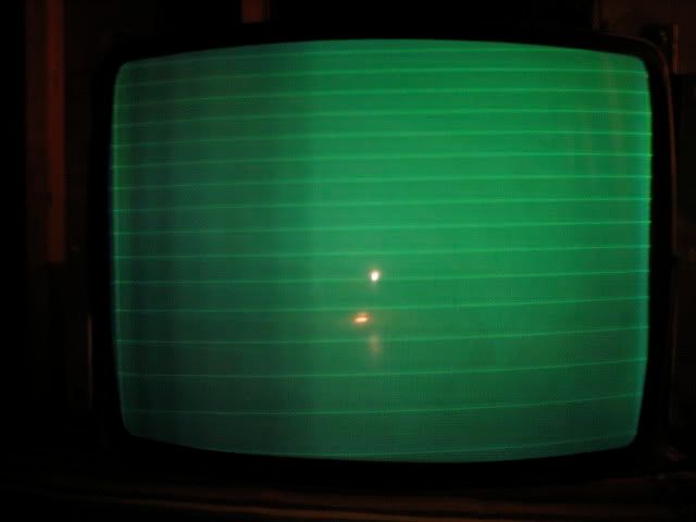

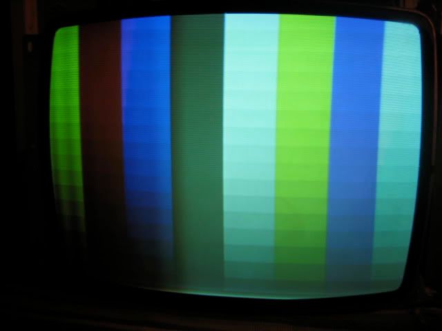

ok, got the monitor, degauss did nothing. There are black bars on the side as mentioned by Kevin. There are also light horizontal lines that don't go away unless I crank the brightness.
The red seems to be very dim compared to the green and blue, here is the color test
(the pics are very contrast-y)
green test
(less brightness)
(more brightness)
(dark line is from camera)
blue test
red test
(less brightness)
red test
(more brightness)
here are the horizontal lines I'm talking about
another pic showing dimness issue
HELP!!

You need to cap it first.
The thin horizontal lines looks like the SCREEN on the flyback needs turned down a hair. (but you will loose some overall brightness)
But I really recommend capping in and then readjusting everything. You can adjust it all day long and as soon as you cap it you will have to do it again anyways.
Some of the dimness may be the tube itself, but once again, cap it first.

« Reply #16 on: December 29, 2009, 10:17:34 am »
Can you point in the right direction for the specific kit I need. I've seen a couple and want to be sure to get the right one!
Standard K7000.  I'm going to order some caps soon for some other monitors, would you like me to get a K7000 for you too?  $7.00 plus shipping.  These will be hi-temp caps.
And I'm also in the camp of "there is something wrong with your tube".
Kevin Mullins
  • Posts: 4504
    • Me on Myspace
Re: wells gardner 25" 25K7107
« Reply #17 on: December 29, 2009, 01:32:20 pm »
C57 (47uf 160v) is a common culprit of the dark/jail bar symptoms shown specifically on the left side.
Cap it.....
