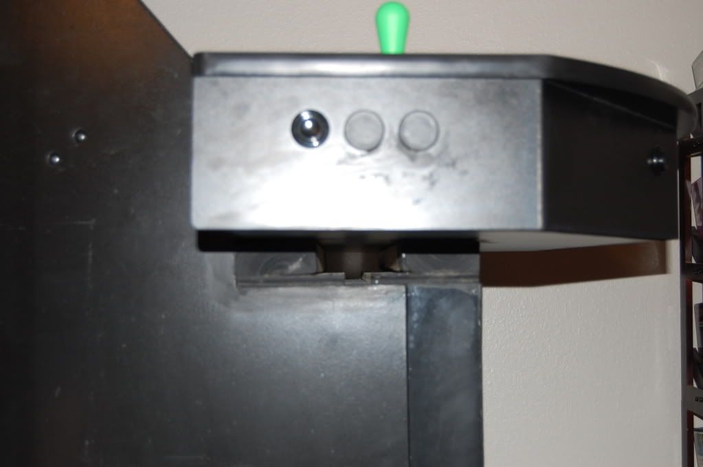

After a busy summer (Bar Exam studying) I am finally getting around to posting this.  I finished this build a couple of months ago.  This was my first build, so I had a lot of research to do.
Cabinet:
I found the cabinet on Craigslist about 80 miles away.  It was set up as a nice little GoldenTee2K that the guy said was hopelessly broken.  He only wanted $200 for the whole getup, including the WG K7191 25” monitor.  After getting it back to the house, I had it working in about five minutes.  The ground wire on the JAMMA connector was loose.  Certainly a quick fix.  Looked a little closer at the cabinet and did some research and found that it was originally a NBA JAM TE.  The original artwork is still on the side under the paint.  Thought about removing the paint with some Mostenbochers, but not knowing the condition, I left it as it.  I pulled most of the JAMMA wiring out, only left the JAMMA harness for the video.  Got a JPAC and an ArcadeVGA from Andy over at Ultimarc and it interfaced beautifully with the WG monitor.
Control Panel:
The control panel is the customer 4-player from Mameroom.com. See my review of the panel here.  http://forum.arcadecontrols.com/index.php?topic=90582.msg950733#msg950733  Used the custom design tool and just e-mailed the CAD file to them, came out great.  Made a dumb mistake with a couple of the admin buttons on the side though.  They wouldn’t fit because the player one joystick.  Notice the hole plugs.  Escape button works well though.  Wired the whole unit into a IPAC-4 and the trackball into an Opti-Wiz from GroovyGameGear.com.  The LED coin buttons are also from Groovy Game Gear.com.  I had the originaly 5v power supply from the cabinet, but I instead just wire them together and hacked them into an old USB cable.  That way the entire panel was self contained USB and mobile (I had it finished well before the cabinet was ready).  I had to improvize a good bit on the mounting.  I needed to more inches of lift, so what you see is as 2x4 and some half inch ply wood screwed together.  It seems to work well.
