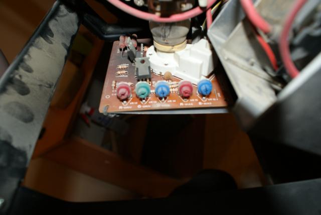

Another thing I noticed is that apart from the gain knobs beside the RGB inputs on the chassis, there's another set of colored knobs on the daughterboard directly behind my tube. I can take pictures of these if needed. Should these have any effect on the overall picture quality?

I've gone ahead and wired up the monitor, adjusted the brightness and the Video Bias, so that blacks look correct, and the colors are visible.
The blues and greens show up perfectly.
The reds not so much... I've got 3 adjustment knobs that, when tweaked, do the following...
R-Gain - No effect
R-Drive - Blanket of red pixels across the screen.
R-Bias - How strong the red pixel blanket shows up.
I've multimeter'ed the signal and everything's showing up fine from either the gameboard or the PC connection for all pins.
I know that the gameboard and PC are both outputting reds fine.
If it's any help, here's a shot of the neckboard controls.
The knobs are from left to right: RGB Drive, RB Bias (My understanding is that there should be no G Bias, as i am to adjust the R and B accordingly).

Brought my monitor in to a tech, got things figured out. I was not adjusting something properly.
Picture's great now!
