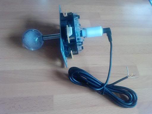

Basically...  I'm trying to light up a clear bubbletop with one of Randy's RGB LED's, which at 5mm, is too big to fit.
Is there some sort of housing I can plug the end into, and run fiber through the hollow shaft and into the bubbletop?

A 5mm LED should fit into a Seimitsu LB-39 bubble top no problem (assuming that the ball top you are using).
You should just need to remove the shoulder with a file or grinding wheel etc until it goes in.

Ok, so I shaved off the shoulder, and it goes in now...  but the way the 4 wires are arranged (in a straight line) and the size of the LED itself is causing problems.  Anyone have any bright ideas?

I see you are using RGBs, I havent tried using a RGB but my thought was to bend the legs into a square shape to get the wires in a better posistion to go down the bore in the shaft. I think you would also need to drill slightly deeper into the bubble top to allow it to sit a little higher to give an extra room for the wiring.
Needless to say you will need to use thin gauge wire to get the four wires down the hole. I think you bought a hollow shaft of Luigi didnt you? I'm not sure what size he bored his out too but I drilled mine 3.5mm and countersunk the top end to the thread diameter to aid insertion/mounting . Mine also have a slightly reduced length of thread to allow a little more room.
3mm four leg RGB LEDs (not the two leg flashing/pulsing type) would help but I havent seen any.
If getting four legs down is impossible it may be possible just to wire up and insulate three of the legs and then leave one of the outer legs with no wiring/insulation and let that rest against the inside of the bore. You could then use the shaft's conductivity as the forth 'wire' and then just solder a wire onto the bottom/base of the shaft.
I've also been thinking about your idea for fibre optic cable. I thought that if it works then it could also be an easier solution for tangle free lighting. Ive ordered some 3mm OD 48x0.25mm core cable to have a play with. I'll let you know how I get on.

Yeah I think you need to block out as much light as possible around the LED so it all gets directed down the fibres. I think heatshrink and/or liquid electrical tape would do a good job.
I have been looking into it a little and you from what I gather you need to cut the cable with a hot blade and then polish the fibre ends to enable the best light transmission. It advises polishing it to 12 microns before polishing it down to one. The highest grit I have at home is 1200 which IIRC is 9 microns. I'm going to try polishing both ends with that and then maybe getting some higher grit if that's not satisfactory.

True, that may have been a factor although the LEDs I tested have a very narrow angle so I don't think it would have made that much of a difference using white heat shrink.
I think the real issue is that even the largest diameter FO cable possible (that you can get down the shaft) will not transmit enough light.
I have come up with a solution though that gives 100% brightness and its also killed another issue at the same time. I'll release it once I have played with tested it.  ;)

Yeah that would have been possible but it would only have taken a couple of twists of the joystick to rip the wiring out.
I spoke to Haruman and found out he was using JLFs so I decided to have a go at modding them. In an ideal world, to get the best lighting we needed to get a 5mm RGB LED inside the end of the shaft/ball top. This has been impossible before because you can only drill a ~3.2mm bore because of the root diameter of the M6 thread.
The solution in the end was pretty easy. If you increase the thread size on the shaft you can also increase the size of the bore. An M8 thread has a root diameter of 6.47mm so that would allow us to drill a ~5.2mm bore which then allowed us to fit a 5mm LED (with the shoulder removed) inside the shaft.
Obviously the bubble tops have an M6 thread but luckily there is plenty of material in the inserted nut so I just opened the thread out to M8 to match the shafts.
As there was now a 5.2mm bore in the shaft it meant that we could no longer use the e-clip to keep the spring in compression as the e-clip groove diameter is 5mm. There is now only a 1mm wall thickness so a larger e-clip was out of the question. I decided to use some kind of sleeve and grub screws in place of the e-clip and I thought if I was making some kind of sleeve I may as well increase the length of it and add a 4 pole jack/socket for tangle free RGB lighting.
Anyway, here she is:
Obviously the adapter adds to the required CP depth but this wasn't as issue for Haruman or myself. I had previously modded a JLF and got the 4 pole socket flush with the end of the stock stick by redesigning pretty much all of the shaft components but this was not possible in this case as we needed RGB.
Even with the Nylon adapter, socket and screws, the new shaft assembly is 2 grams lighter than the solid stock one (56g). Once the LED etc is installed (I need to order some from GGG) I imagine it should weigh even closer to the stock one.
