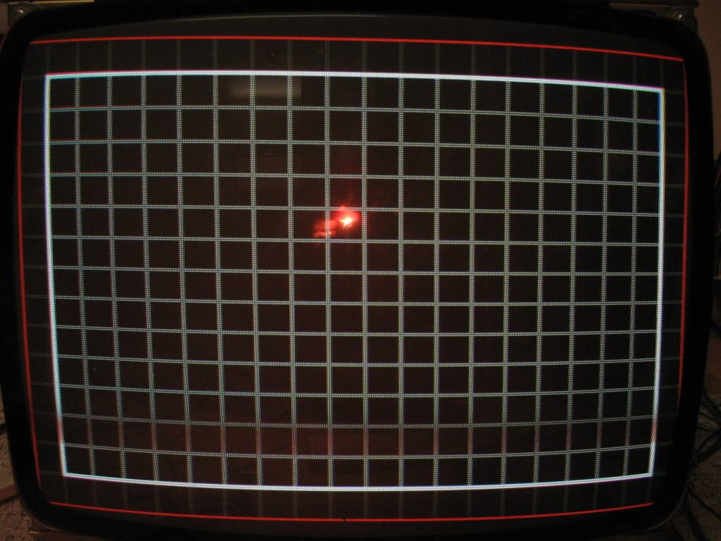

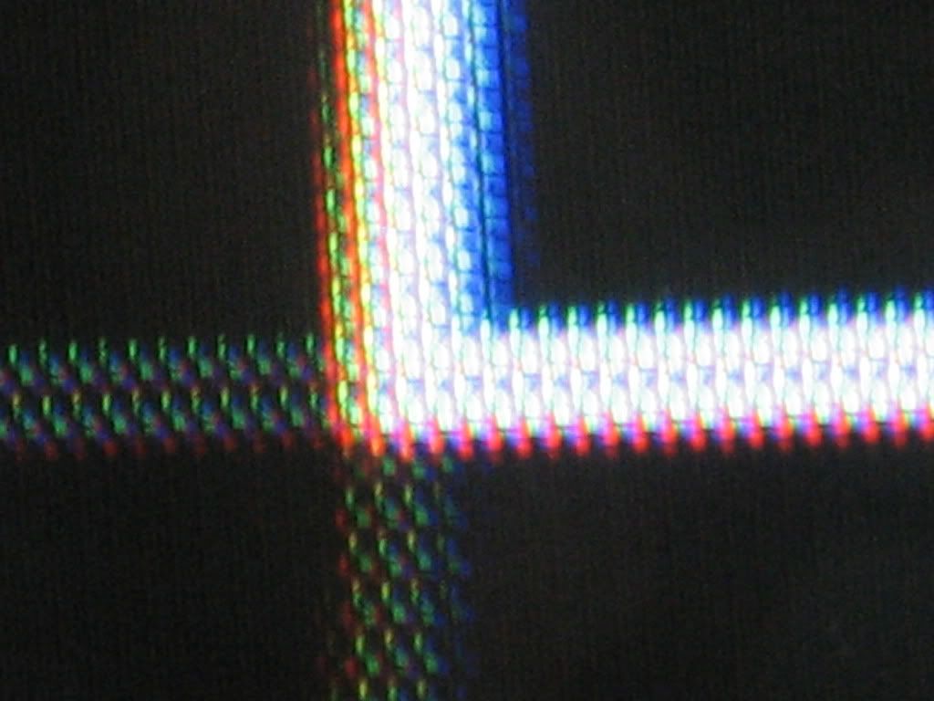

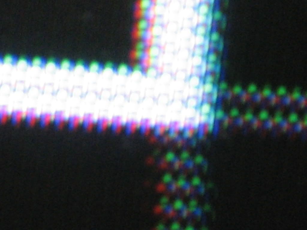

Sorry I haven't responded but I've had a heck of a time getting pics that showed what I was attempting to describe.  This is the best I could come up with.  Sorry about the file sizes but I though the more info the better.

« Reply #11 on: August 07, 2009, 09:48:46 am »
I'm seeing a tiny/minuscule geometry/convergence issue.  Really tiny.  Not worth bothering with.  Unless that's not what you're talking aboot...

« Reply #12 on: August 07, 2009, 08:14:09 pm »
No, I was thinking of the geometry and convergence issue(s).  The corners not being consistently shaped, specifically the bottom right corner, caught my eye 1st.  But also the fact that if you look at the close ups of the corners you can see that the red box seems a little slanted, follow the pixels and you can see that they appear striped instead of in a column. I thought while I had the monitor out of the cab I would try to get it as close to perfect as I could.  Am I just being a perfectionist or will it be visible during game play?
My next concern is the horizontal width.  From the pictures you can see that once I get my bezel back on the sides are going to get cut off a little.  Any suggestions on adjusting the horizontal width coil safely?
... and lastly, in these pics I have my vertical position turned all the way up and ascetically I could ask that the picture be a little higher.  Does having it maxed out put any undue stress on the chassis components?  Is there a way to adjust it more or a component that I should replace while I have it out of the cab?
