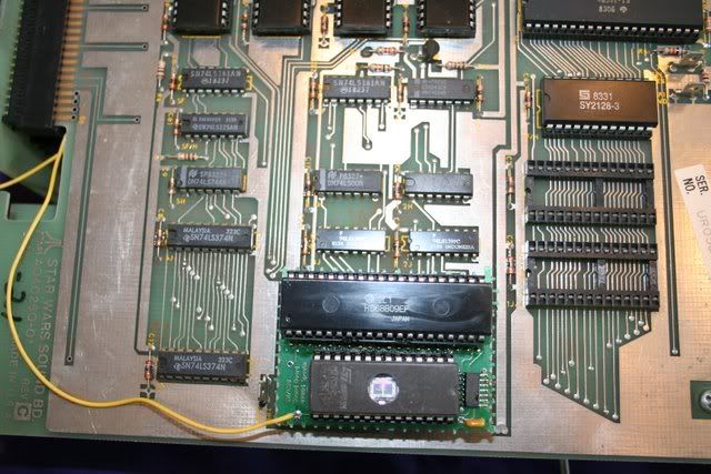

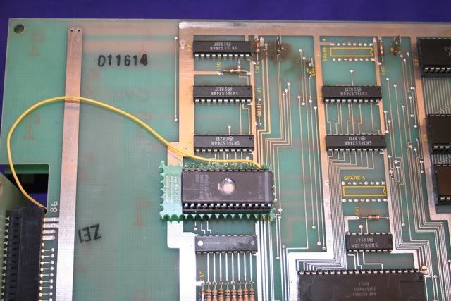

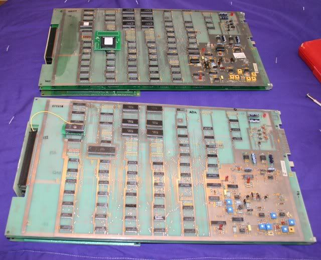

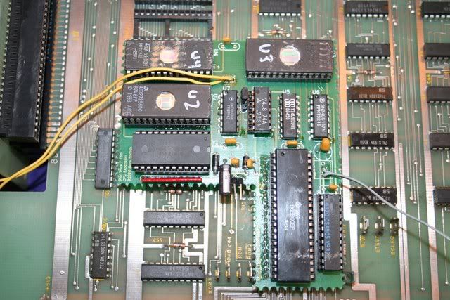

Here are some photos of the 3 components of the multi-kit
Sound board connection:
AVG board connection:
CPU board connection:

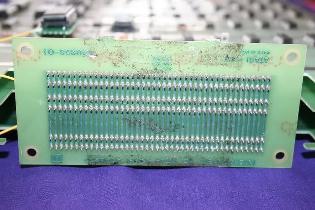

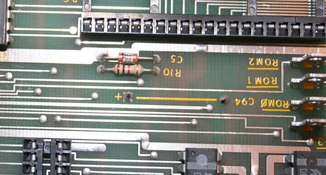

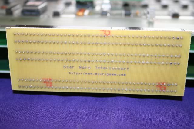

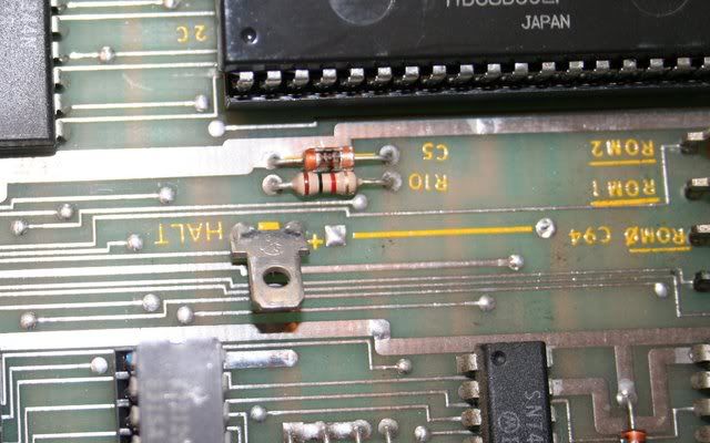

While swapping the kit from one board set to anther
I noticed a few things that were different on my board.
First, the interconnect card that connects the three boards together on mine isn't original.  It is one of Clay Cowgils reproductions
Second, and this one seems odd, on the board I pulled the kit from, there is a test tab and "HALT" screened onto the board.  Mine does not have this:
Spyridon
