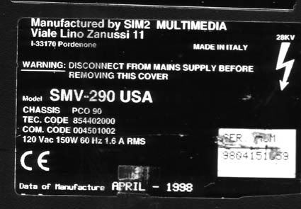

  • Just have fun.
  • Posts: 837
Re: monitor adjustment - pincushion
« Reply #7 on: February 24, 2009, 03:48:09 am »
The monitor is a Seleco Italel Multimedia SMV-290 USA

grantspain
  • Posts: 6181
  • Last login:Yesterday at 01:42:17 pm
« Reply #10 on: February 24, 2009, 03:38:35 pm »
a weird problem,i was gonna say if the width affects the pincushion problem then i would suggest looking at the east/west correction diodes but you said another input gives a perfect picture so i am not sure
fa001
  • Posts: 133
  • Last login:November 14, 2023, 11:17:08 am
« Reply #11 on: February 25, 2009, 12:47:58 pm »
qrz,
This is the label on the back of the monitor case. Perhaps it will help you identify the monitor.
- Fred
