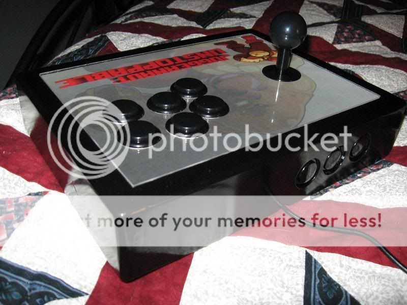

My first attempt at making something from wood! Not perfect but I learned enough to know how to do better next time. Thank you BYOAC woodworking forum, HamuraN, Kaytrim and Timoe for information and ideas.

Looks good!  Nice work!
What type of wood did you use and how did you go about getting your paint job?
MrMojoZ
  • Posts: 291
Re: First 360 Stick
« Reply #2 on: February 16, 2009, 01:55:25 pm »
Some generic pine from Home Depot, top panel is MDF. When it runs out I'm going to try poplar next.
The paint is actually pretty bad, its just harder to tell from the photo heheh. I got in a hurry at one point and ruined it, and the Rustoleum spray I was using just wasn't working either.
The process that I will try next time is sand-kilz-sand-kilz-sand-Krylon Fusion (the fan style nozzle on these worked great, let me save the project)-sand-spray-clear coat-sand clear coat. With a properly prepped surface this time I will get a mirror finish, heck even on a damaged surface this process gave nice results.

Which brand of pad did you hack?
MrMojoZ
  • Posts: 291
Re: First 360 Stick
« Reply #4 on: February 16, 2009, 02:46:35 pm »
It was a black Madcatz.
If you have Circuit Cities in your area that are closing down, grab those cheap Madcatz pads.  ;D
